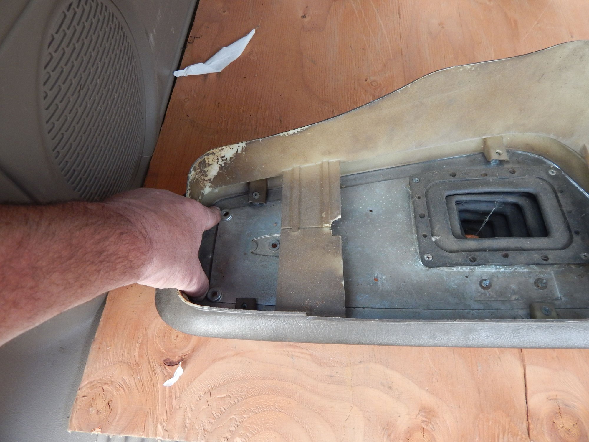

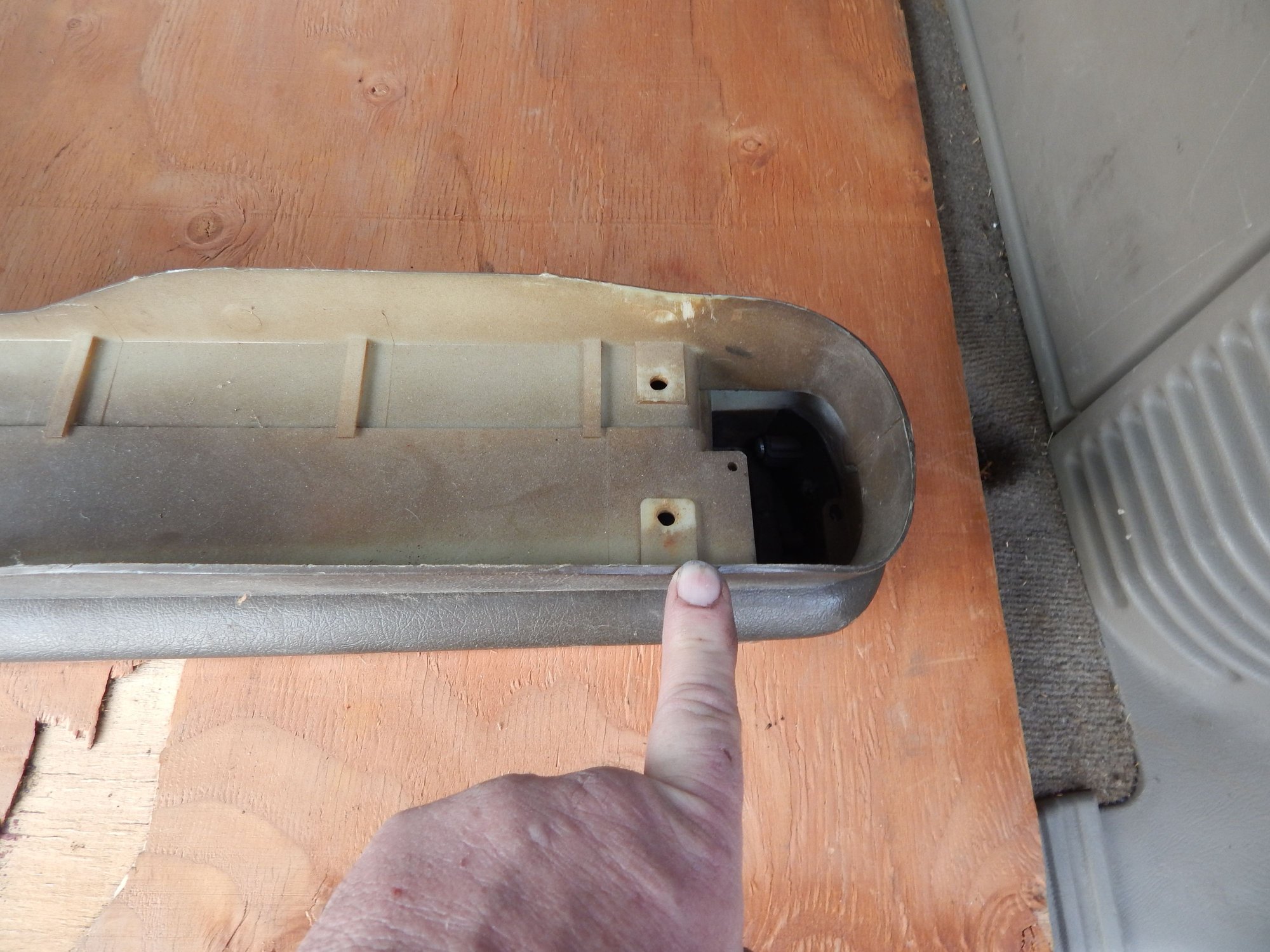

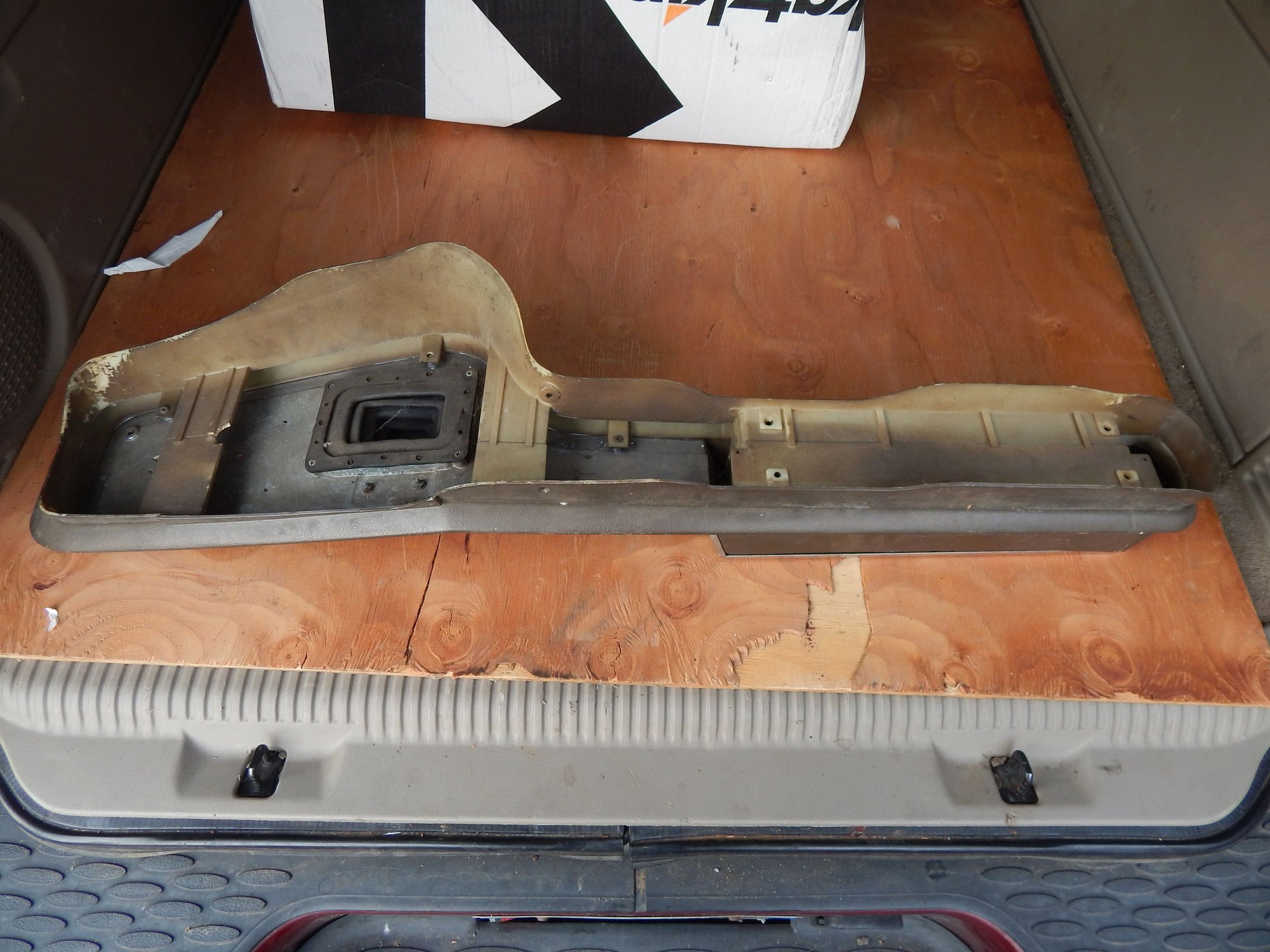

Attached is a scan from the 1969 assembly manual. Check to see if your brackets match these locations. Then I'm attaching photos of the console from my 1965 442 and it shows another place that might be correct for a mount, so check that location too. Its been a few years since I messed with a manual transmission console, so I don't know if the mounts were the same for all 4 speed consoles 1964-69 or if there were differences between the years. Let us know if this solves it for you or if you still need help. John

I wanted to include an overall view of the console.

Thanks a lot!!! My 3 mounting brackets look exactly like the schematic you sent. Your pictures are also perfect. Thanks for your help John!!!

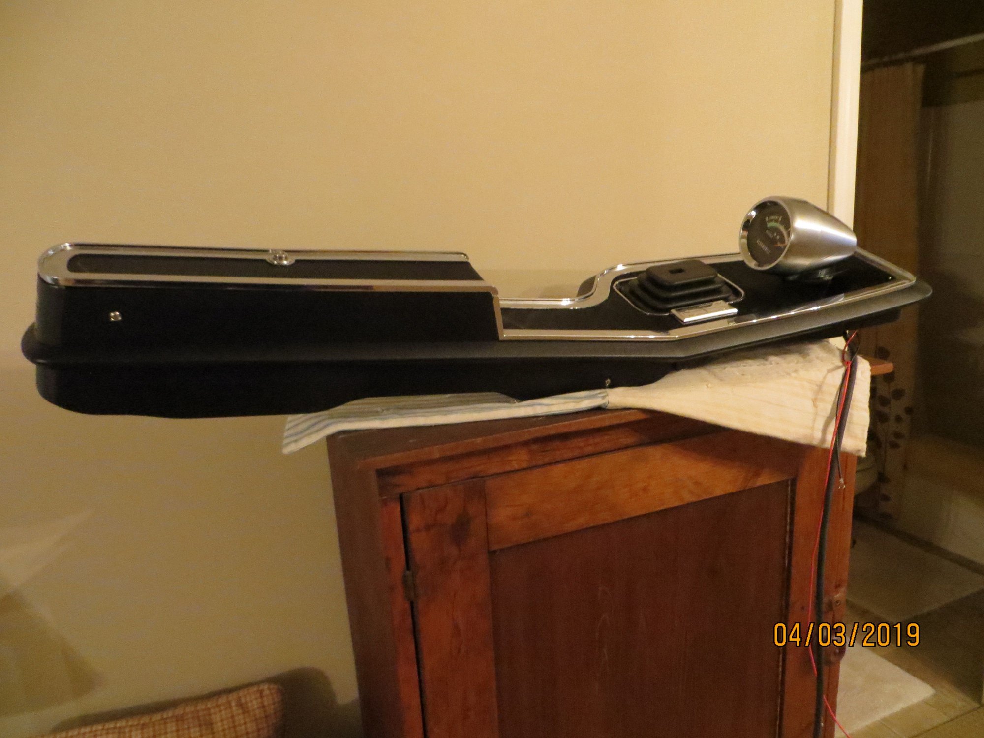

Console is redone annd ready to go in when carpet is in. Looks much better now. Added some screws in the mystery holes to help it look better,

Nice! So how did you determine that the boot's slot should be biased to the rear?

I took a suggestion from a friend who is pretty much spot on with suggestions. Took a closer look at how the previous boot was torn. We will see when it's installed. Finished installing sound deadener and need to do a few small things before starting on carpet.
