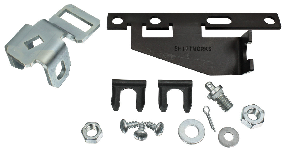

There's a bracket that bolts to the transmission pan to hold the cable in the right location. Then there's another bracket that bolts to the actual shifter shaft coming out of the transmission that the cable will connect to. You'll need those two pieces for sure. Do you have the console with mounting brackets to attach it to the floor? How about the wiring harness for lights in the console? I think it would be easier for us to help you if you posted photos of the items you have, or made a complete list of what you have. Then we can think about what's missing. John

It's called the backdrive linkage, it locks the shifter linkage through the lock plate in the steering column.
It's basically the same linkage as a column shifter except that the shift selector lever on the trans has provisions for the shifter linkage and the backdrive linkage. Parts Place sells the linkage and the lever if you want to check it out, the assembly manual should show it too, can see the manual if you don't have one if you join or are a member of wildaboutcarsonline.com .

You might need a different bracket on the drivers front side of the trans, where the cable attaches to. The floor shift cars had a different one than the column shifted cars. I have any/all parts to make your system work, give me a call if you want & I can guide you through the installation also.

Hi, hey do you still have some of these parts, I need the arm that comes off the selector, that the cable hooks to.
