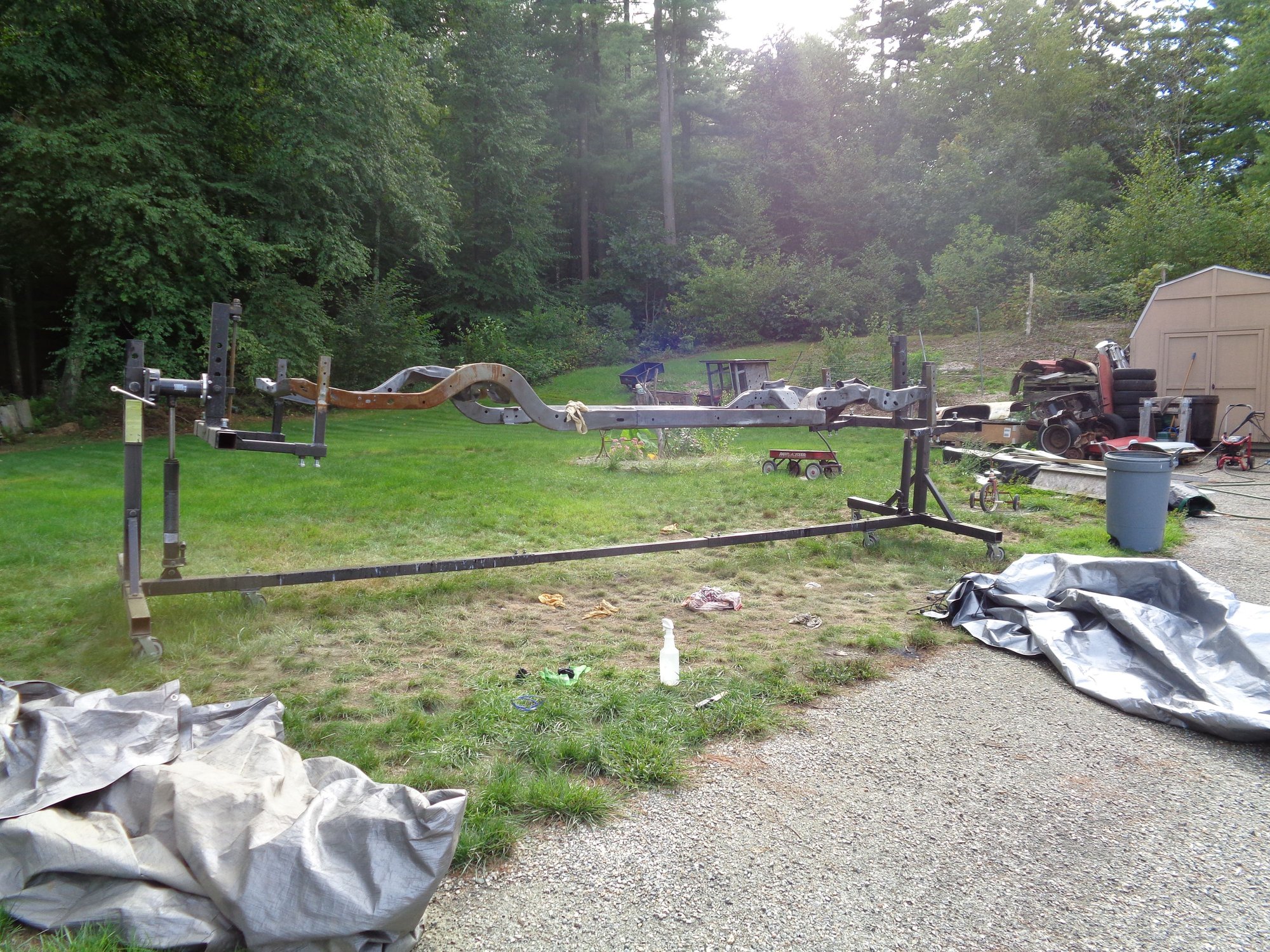

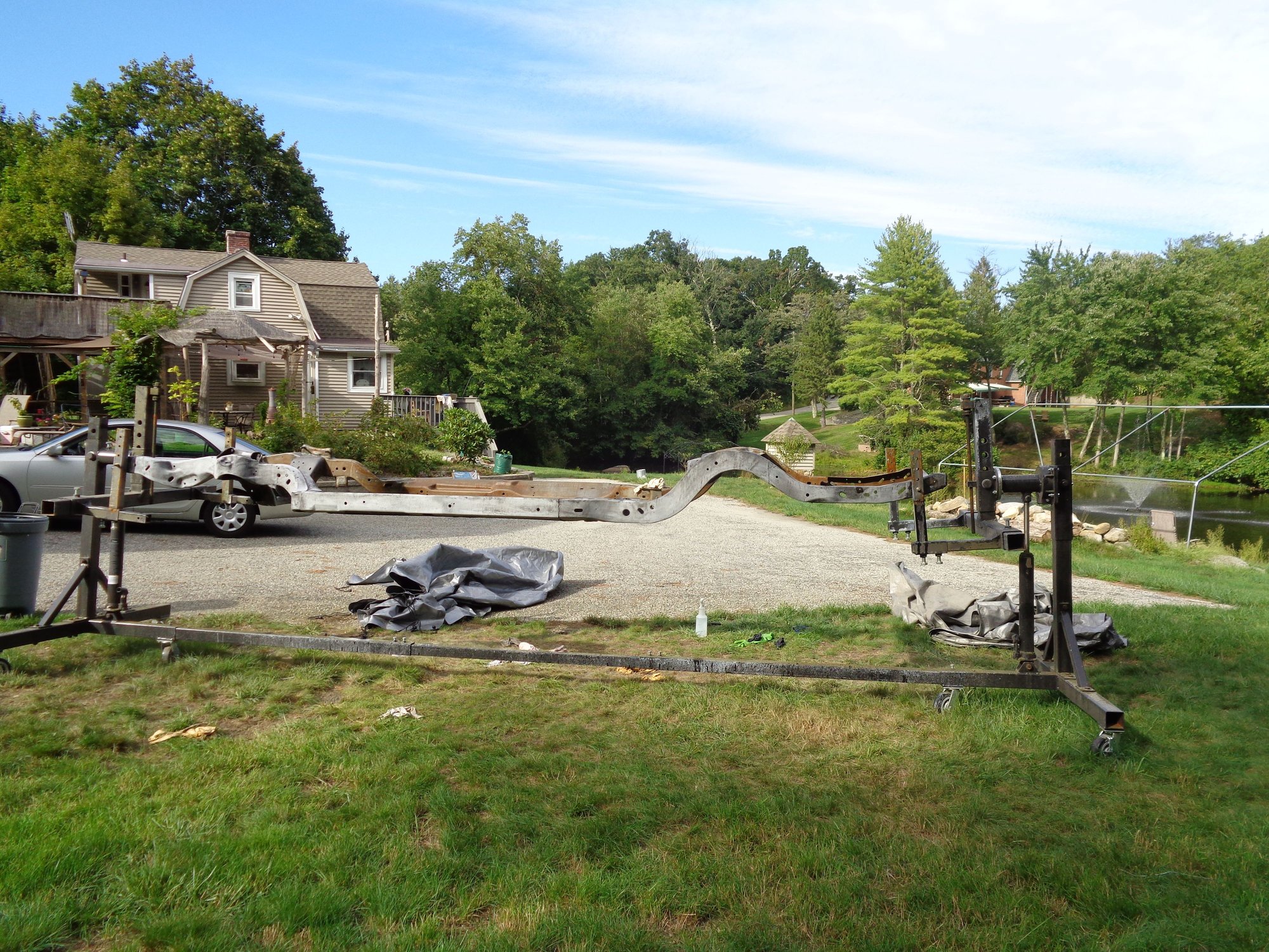

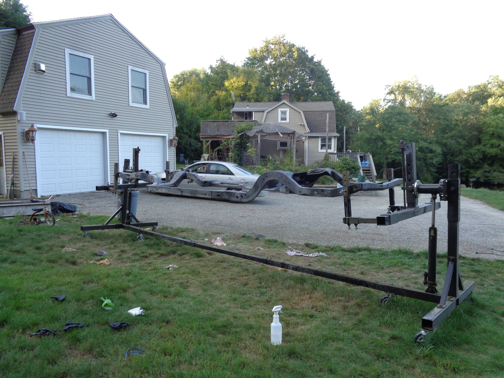

The weather report.
one rainy night and look at that rust
The entire frame rusted overnight in a light rain.
I used "after blast" to clean up the flash rust
With luck, the black will clean up with a scuff pad.
