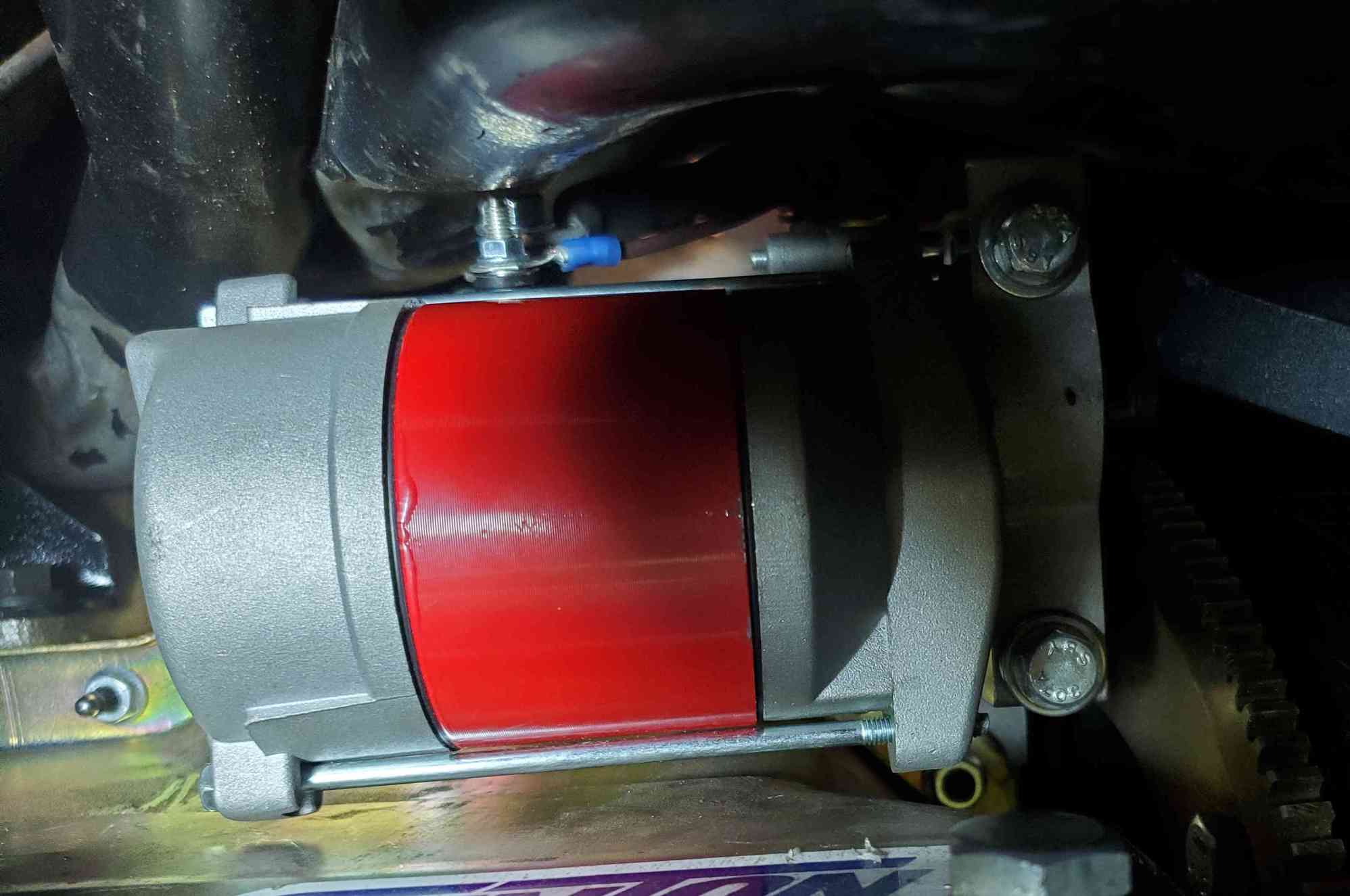

This is the starter I have on my engine as well. The starter seems to be ok, but I have a problem with it not being close enough to the starter ring gear. It barely engages. I need to correct that issue but I don't know for sure if the problem is the starter or the new flex plate. I needed the mini starter to clear my headers and this one barely does as well. You can see in the pic below that I had to "dent tune" the header around the connectors.

That is tight, I don't think there is a more compact starter. You may want a blanket for it to last. I went with that one because how compact it was and had good reviews. I will have to see how it contacts my 330 flex plate on the new motor.

I think I would have cut the threaded portion of the bolt (connection) down so as to not have to dent the header as much.

I appreciate the link, but that only helps if the starter is too close or too tight. Mine is already too loose. I need to get it closer to the ring gear. I will be sure to post the results when I get it working properly.

Is the gear psychically too far away or not going deep enough in engagement?

It is physically too far away. It was incredibly noisy from the beginning and began skipping, as in the teeth would grind over the ring gear. The engagement depth looks about right. I was trying to get the car to my house from storage when it began malfunctioning. I was able to loosen the bolts and push the starter closer to the ring gear and the few thousandths engagement allowed me to get the engine started and get it home. Not sure yet how to resolve the issue for good.

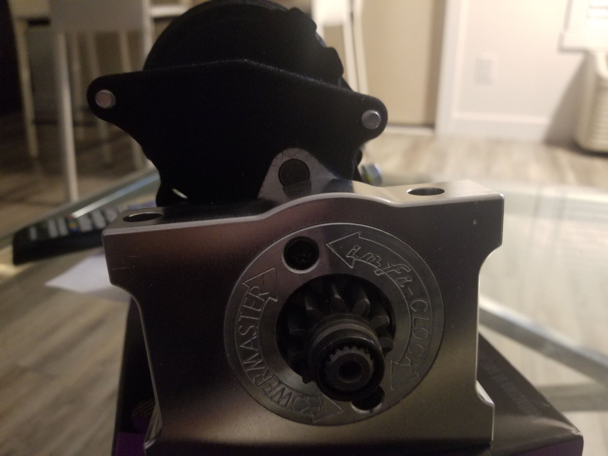

If that's a powermaster, I think you can clock it so you don't have to "tune" the headers...

It isn't a Powermaster but it is fully clockable. He may have to buy a Powermaster which is very similar in size, as his starter seems to have incorrect dimensions. Mine needed 0 adjustments and made no abnormal noises but I am checking engagement. I putting a new 9610 Powermaster for peace of mind on my new 358.

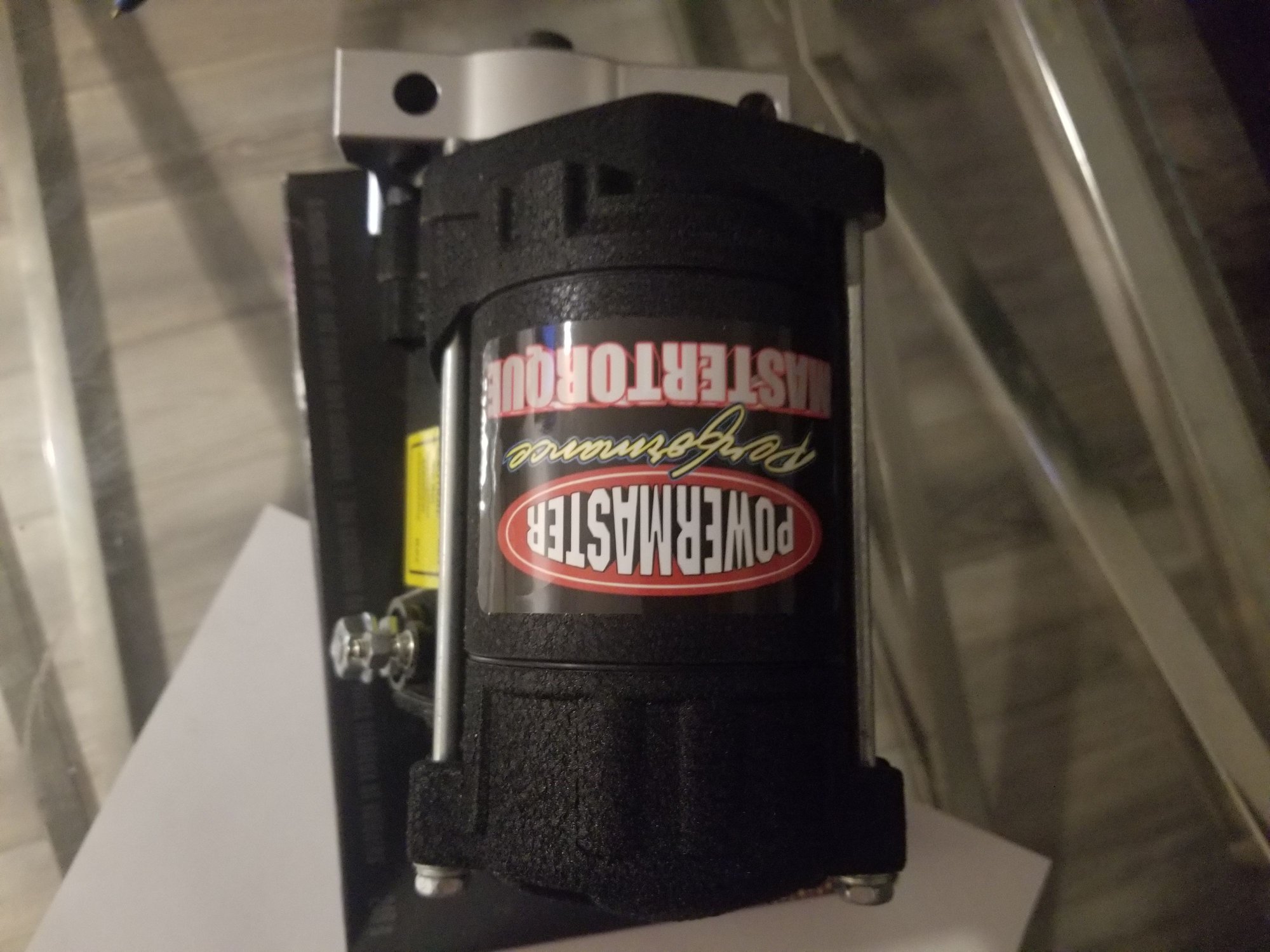

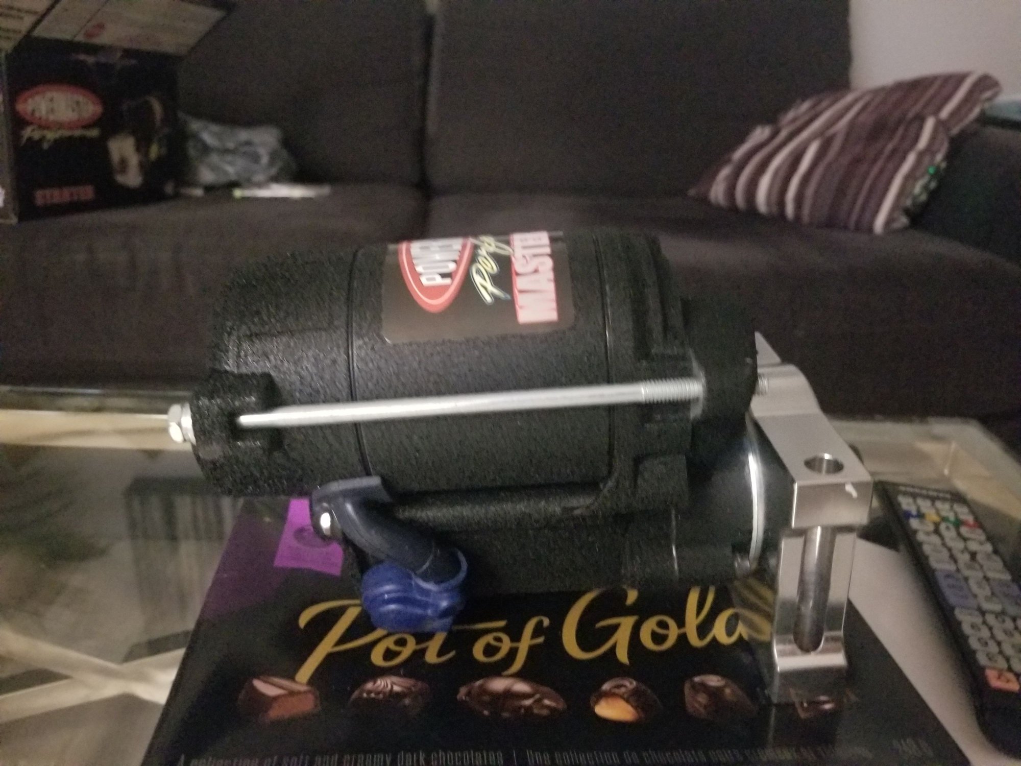

This showed up today, looks pretty nice. Only going on a 9.5 to 1 358, should be plenty.
