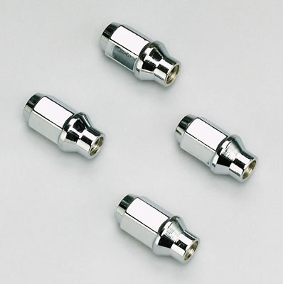

make sure your wheels don't take the long shank lug nut,before using regular lug nuts. my wheels take these
Amazon.com: McGard 62820 Chrome Duplex Long 1.00" Shank Style Lug Nuts (1/2" - 20 Thread Size) - Set of 8: Automotive Amazon.com: McGard 62820 Chrome Duplex Long 1.00" Shank Style Lug Nuts (1/2" - 20 Thread Size) - Set of 8: Automotive

check the lug nut area on the wheel,if its not tapered,chances are it needs the long shouldered lug nuts. what wheels are you using? any pics?

The wheels do use a taper on the nut even though they are aluminum. Old school wheels!!

Is the taper of the aluminum wheels the same as that of your nuts?
I know someone who lost a big boat on a trailer with aluminum wheels because he used the wrong taper lugnuts.

If you are using an older style aluminum wheel (such as an ET Wheel), you may need a lug nut with a 60 degree conical seat with shank...
Check this site: http://www.summitracing.com/parts/crr-27802-4/overview/

The wheels use a std taper and no nose, The nuts are the originals and came with the wheels which I have had for almost 15 years. The holes in the wheels will not accept a nose on the nut, just large enough for the studs. Thanks for all the help, found the studs using the doorman pt#.
