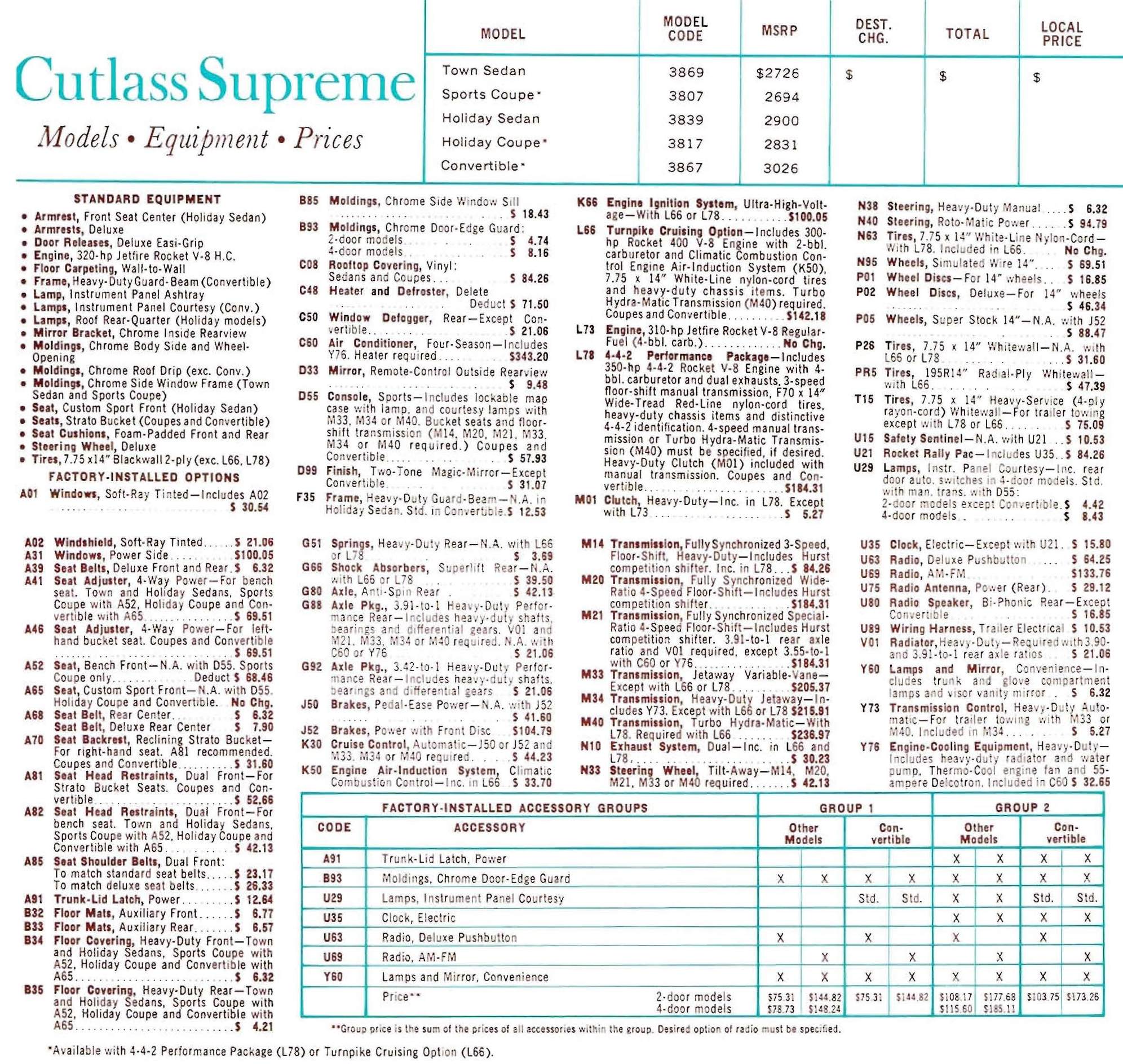

There was no factory 8 track offered in the Cutlass line for the 1967 model year. Additionally, the optional RPO U80 rear speaker was not available in the convertible that year.

67 Cutlass / 442 had few options for radio. AM, and AM/FM. Single speaker, or the Bi Phonic Speaker Adapter. Pull off your tuning **** and look behind it. Your stock radio has two speaker wires, but only one speaker output. That output is the middle hole of three holes arranged vertically, with one of the outer holes jumped with a piece of wire.
Replace that wire and your dummy **** behind the tuner with this adapter with three pins and a potientometer, and you now have fader, and a rear mono.
