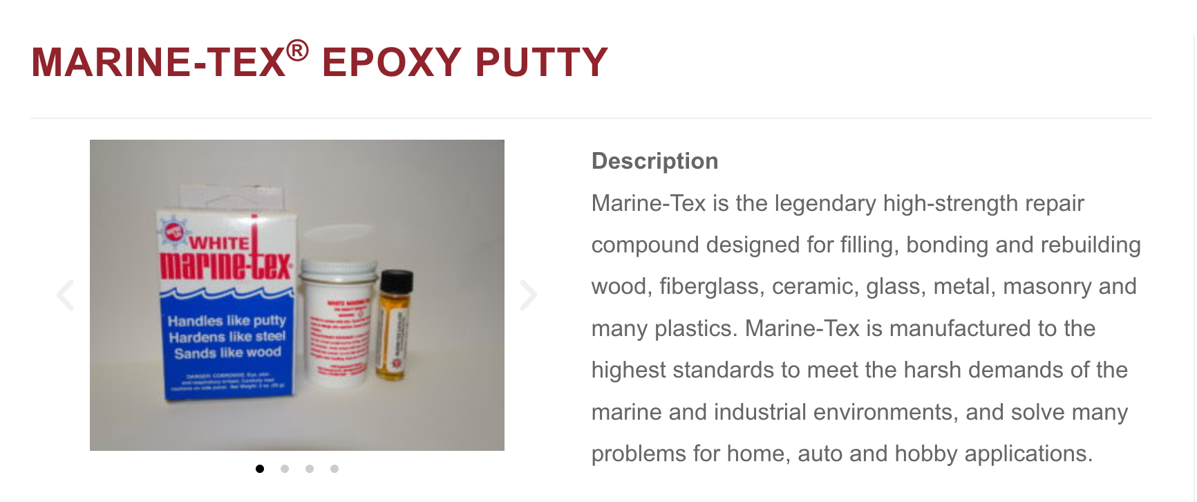

My preferred go-to adhesive is Marine-Tex Epoxy; however, plastic presents unique challenges for any adhesive. I’ve used it for just about everything around the house and on my automobiles successfully.
I do agree like someone said, that it will work best with some sort of fastener and the epoxy in combination.
