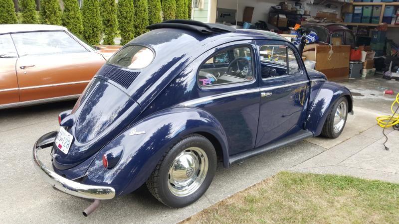

Do you have pictures of your bug? I love early Volkswagen's.
1957 Canadian Standard, 2165cc, 1969 transaxle. Fun little car...

That but has to be a blast to drive. I love the small back window and the color goes very weill with the chrome wheels.
It's a hoot, but you have to take charge of it. I let my 21 year old daughter drive it for the first time last summer and it owned her. Touch the gas, the car lurches forward throwing her back, her foot comes off the gas then back on when the car settles forward...worse than bunny hopping the clutch. I bust a gut laughing...but she's persistent and figured it all out. The Bug is what I "have" to drive when she insists on taking the Cutlass.
The colour is '78 Ford (Truck) Midnight Blue, turned out exactly how I wanted it back in '91 but due for a full rebuild.
