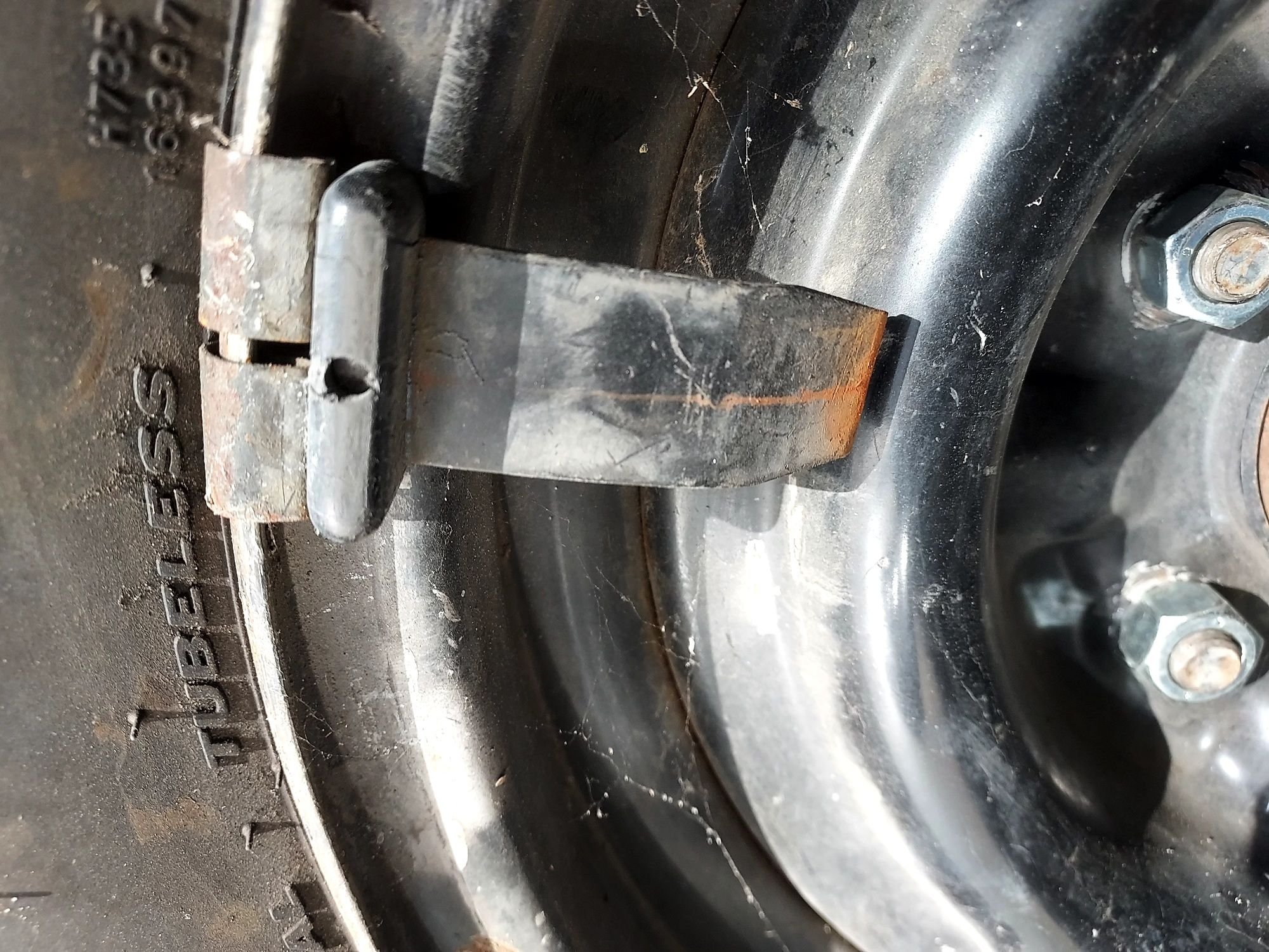

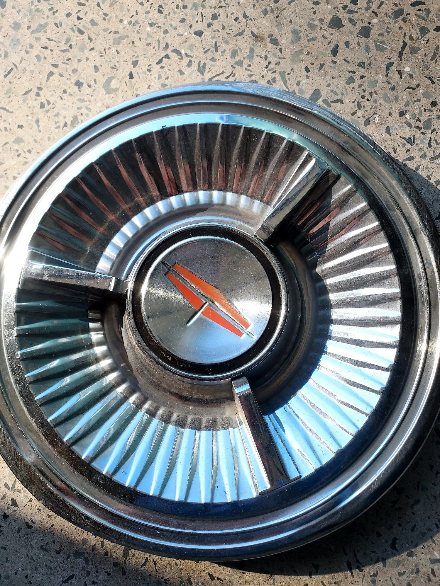

Hub cap clips
1962 98
Does anyone make the clips with or just the rubber cushions that hold the hub caps on?
I'm missing a few of the cushions and I have an annoying creeking sound coming from both back wheels.
I've checked everything else so my last guess is the hub cap.

Was the sound evident with the wheel covers removed?

If its just cushions missing try duct or electric tape, works great for this application. Wheel covers not hub caps, sorry I had to say that !!

No noise with hub covers/ wheel caps removed.
I will be employing the electrical tape reolution

Be aware there are two different sizes.
