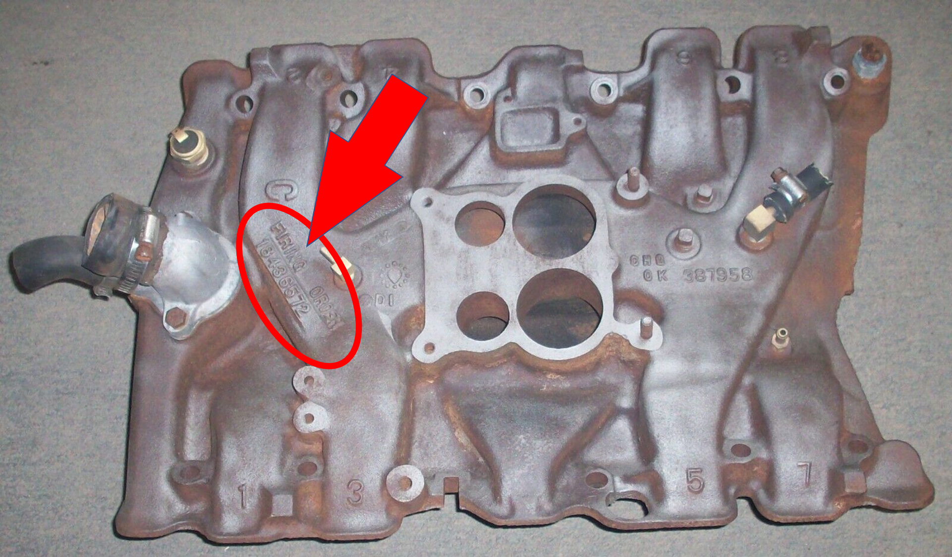

so i finally droped my 350 in and wired everything up. but i belive i wired up my distributor. does anybody have a wiring diagram for spark plugs from distributor to spark plugs
Old Apr 19, 2014 | 06:39 PM
Octania's Avatar
Posts: 7,286
Seems like we might have gone over this before.
First you have to bring the engine to TDC compression stroke.
Be sure it is not TDC for #6 to fire and #1 between intake and exhaust.
There are various ways to do this, per prior discussion.
Then you see where the rotor is pointing, which will depend on where it ended up when it was installed. There is a preferred location, pointing to #1 cylinder for pts ignition, or pointing about at the driver for HEI, but it really does not much matter.
Wherever it points is where you put the #1 plug wire.
Following the firing order, which is provided on the intake, proceed around the distributor in the correct direction.
The FO is 18436572
the proper direction is CCW as viewed from above.
the cylinders are also numbered on the factory intake, and are 1357 down the LH [driver's] side, and 2468 down the RH [passenger] side.

Hope this helps.

pictures are worth 1000 words, he can't go wrong with that Eric .
Old Apr 20, 2014 | 07:29 AM
Octania's Avatar
Posts: 7,286
Well, actually, he CAN go wrong with just that picture, if the distributor was installed with #1 in any position other than that shown.
Whereas, my description says to use for the #1 plug, whatever tower the rotor is pointing at when the #1 cylinder is ready to fire.
Oh, dear God, it requires learning one of the 2 or three super simple methods of discerning TDC compression from TDC intake/exhaust. However, people a lot less intelligent than any of us here have managed this task, so it can be done.

He can also go wrong if he has a Chebby 307, since that picture implies that it covers that engine as well, when it most assuredly does not.

[QUOTE=MDchanic;686874]He can also go wrong if he has a Chebby 307, since that picture implies that it covers that engine as well, when it most assuredly does not.
Yes but he did post he had a 350 in it I myself would have assumed the distributer was in correctly therefore no need to bring #1 up and check rotor position. So lets say a picture can get you close

Didn't Olds make a 307 also? It's not addressing the Chevy 307, whereas the distributor turns c/w.
Exactly my point: It says "GM 307." GM made two 307s, the Chev. and the Olds.
The firing order and distributor location are the same, but the direction of the distributor is different.
- Eric
Old Apr 20, 2014 | 09:27 PM
Octania's Avatar
Posts: 7,286
Aaaaand... pre-HEI igns placed the #1 post towards the #1 cylinder.
And, assuming the dist'r is currently installed per that diagram is a recipe for disaster
Don't assume- verify, and do the process exactly once and exactly right.

I have a 78 olds with a 403 but I have the spark plug wires crossed somehow can anyone provide me with a pic of the firing order and position of the dis cap ?
Old Nov 29, 2023 | 07:20 AM
The firing order is cast right into every intake manifold Olds made. Olds distributors turn counterclockwise. The location of #1 is irrelevant so long as the #1 cylinder is at TDC on compression when the distributor rotor lines up with that wire.
