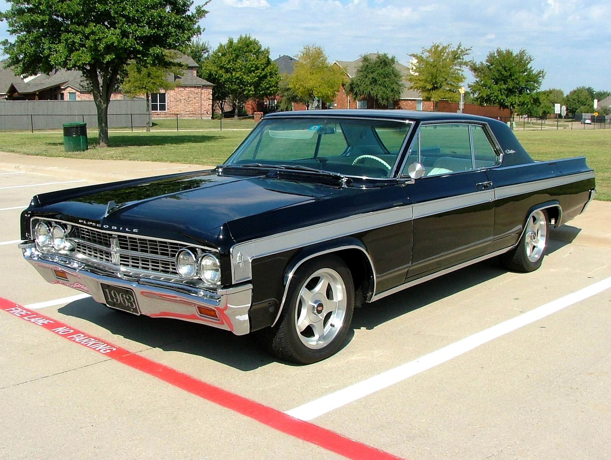

My 63 Starfire had factory A/C. It had been backyard converted to R134a and sort of worked when I got it but I had it serviced to check it out. The shop added the correct charge ports, changed a few o-rings and replaced the dryer. They evacuated and recharged the system and it worked fine for the next 9 years with no additional work. Made me doubt all the experts that say all the hoses, o-rings, expansion valve and condenser have to be replaced on a conversion - all of my hoses were the same ones installed in 1963. It is true that the old style condensers do not work as well with R134a, my black car would feel fine on a 100 degree Texas day right out of the garage but if I spent too much time stopped in traffic or if it was left baking in the sun it took a real long time to cool off the inside!

That's one handsome Starfire !! When I worked as a tech my shop completed several r-134 conversions, we were advised in most cases that the original hoses were fine for re-use we were told the insides of the hoses were coated with the refrigerant oils and that would act as a barrier against leakage from the smaller molecule R-134 we also would retain the original expansion valves but of course swap out the receiver driers, we would however advise the the customer that the condenser was kind of a 50/50 crap shoot and it may have to be retrofit with a ribbon/serpentine style condenser , we would try it first with the tube style and if the customer was satisfied with the cooling fine if not condenser replacement required in all case when the cooling did not seem up to snuff replacement with the ribbon style condenser solved the problem.
One pro for the old tube style condense was they could be flushed !! with the new style condensers if you have a ruptured desiccant bag or failed compressor that distributed debris through the system 90% of the time it cant be flushed out and the cond. has to be replaced.
