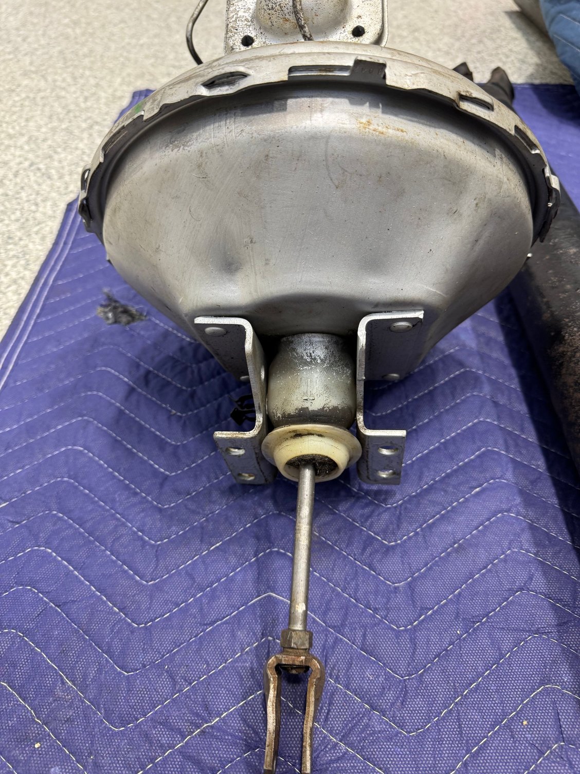

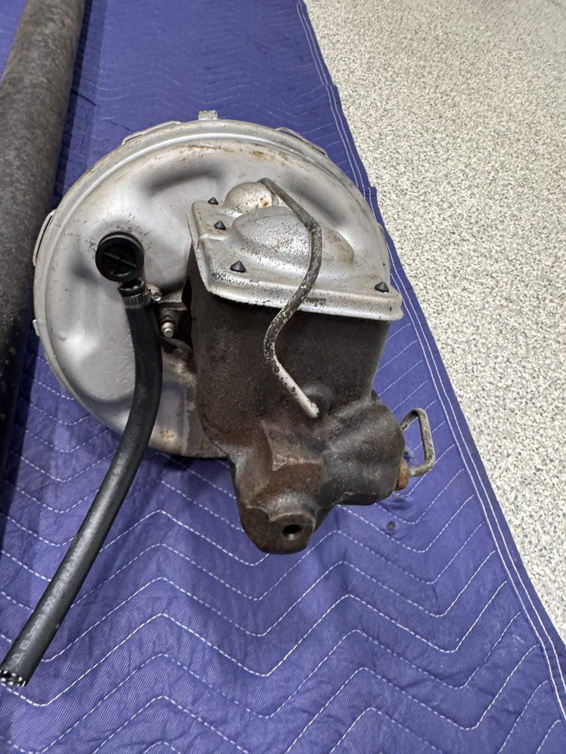

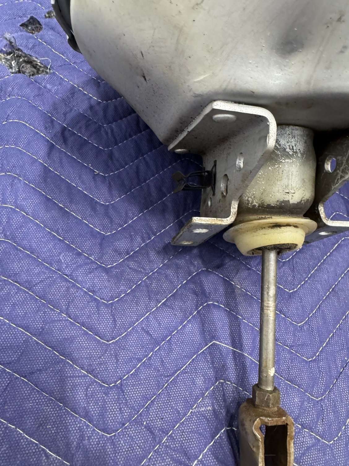

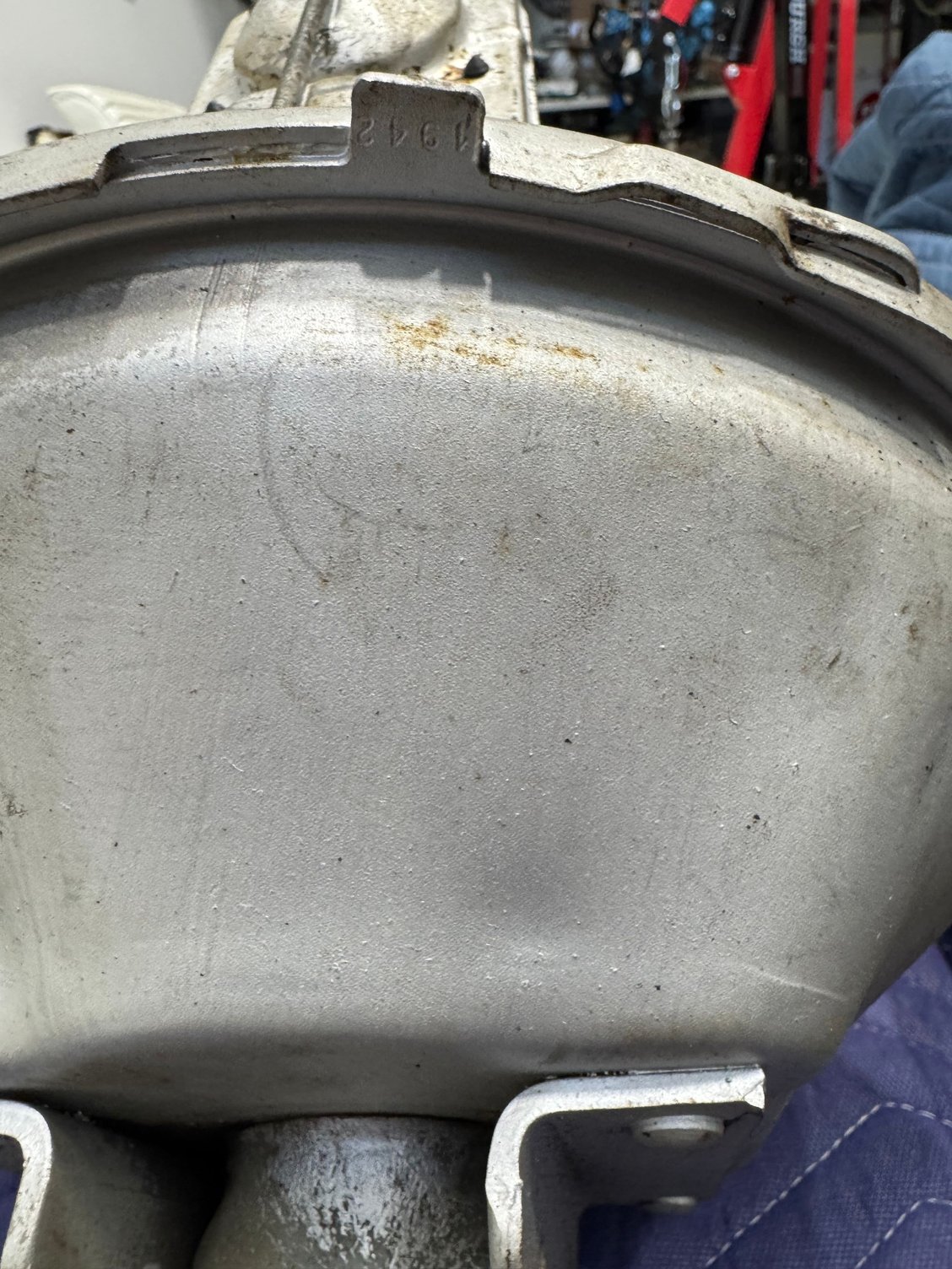

Brake booster part / application number 1942 on the back tab. What is it off of? Removed from a ‘70 442 but obviously doesn’t have an application number for a 442. Someone said ‘72 Supreme maybe?

It seems that number is the last four digits of the assembly -- not the individual brake booster part. 1927, 1940, 1941, and 1944 are shown for 1971's. Maybe someone can check 1972's.

1940 & 1944 are listed in the 1972 PIM

1971 information was in post #2
