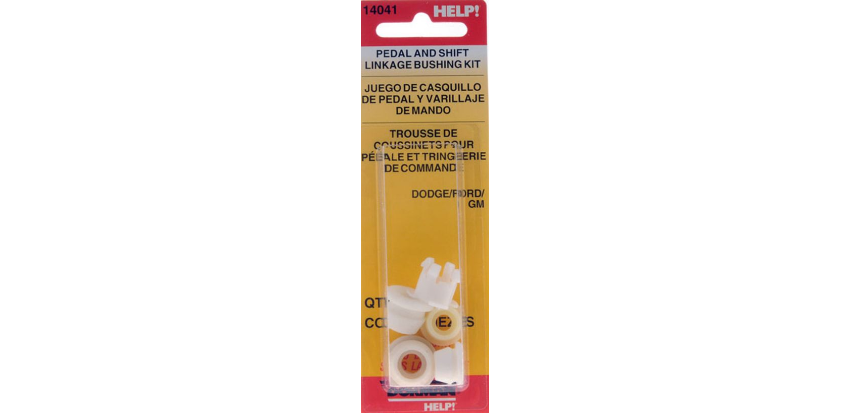

Pretty sure you can get replacement bushings at the parts stores in the Help or dorman sections
Yeah, so long as you're willing to purchase an assortment pack of bushings, only one of which fits your car...

I have slept a lot since the last bought some, maybe way back you could buy them individually. Someone probably decided they could make more money by selling them in a assortment pack instead of individually. It’s all about the almighty dollar!!!
Maybe you could find what you need at a transmission shop.
