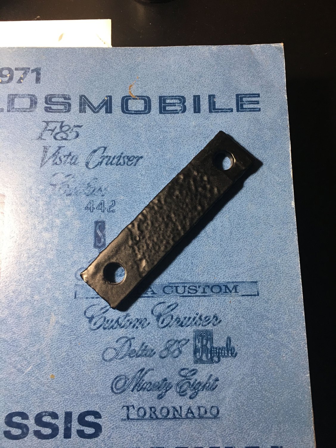

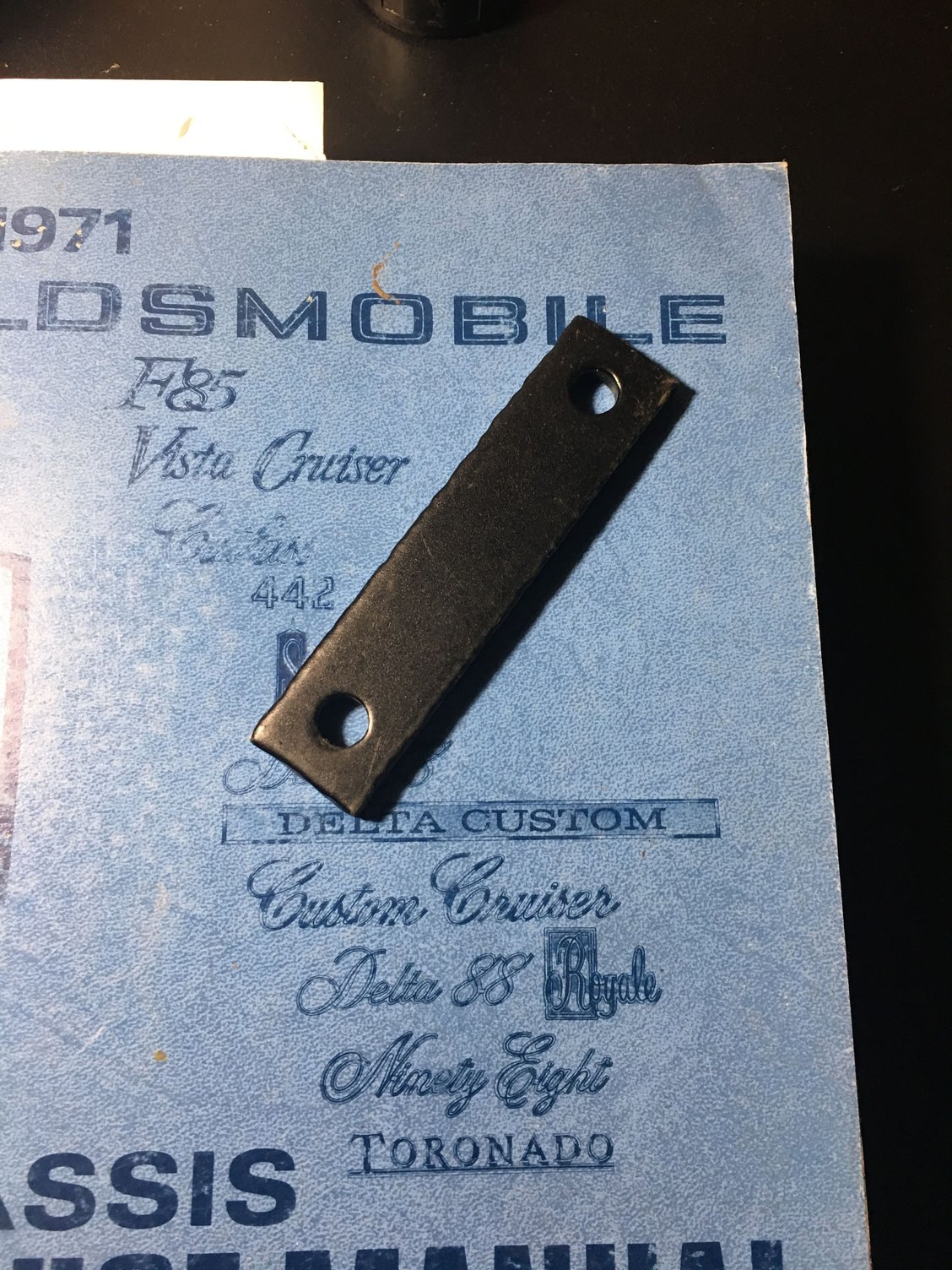

Recently found this when going through some extra parts provided when I purchased my 1971 442. Possible front end part, but sure could use some expert help - thanks in advance. Measures 4 1/4 inches by 1 inch. 1/4 inch thick. Metal is textured on one side

This is a spacer for under the battery tray unique to big block applications.

Thanks Tom and Mr. shifty! If there is one missing I’ll bet the others are missing as well - time to pull the battery and see what’s happening down there, thanks again

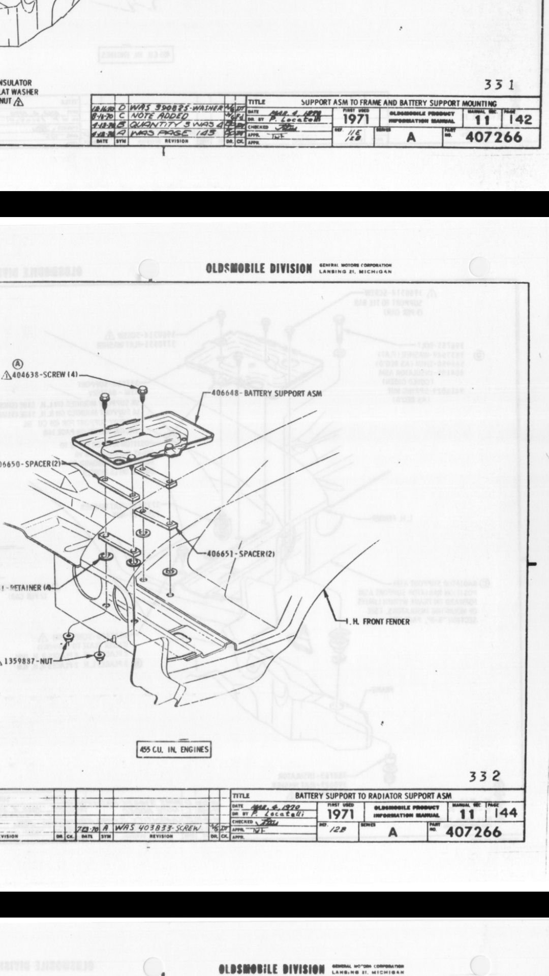

Posts: 26,066
It appears there are x4 spacers (x2 each). 406650 (x2) & 406651 (x2)

Originally Posted by scrappie
Why is that spacer needed exactly?
The big block cars got a larger battery than the 350 cars (see the note on the drawing that says "455 CU IN ENGINES), with a correspondingly larger tray. The spacers were likely a last minute "oh $H!T" fix when they discovered that larger tray hit the radius on the core support or inner fender.
