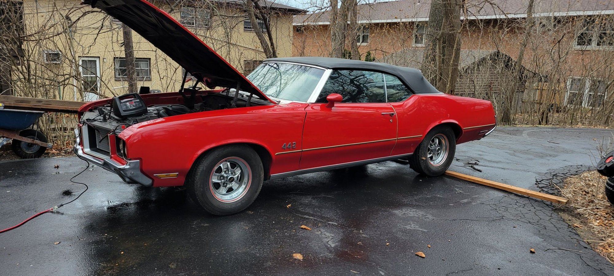

Working on getting my Dad's car running again. A few battles with mice, reman q-jet(not an original car), ignition parts, fresh fuel...and she fired up. Unfortunately, the heater core is leaking.
Any recommendations for a made in the U.S.A. heater core ?
