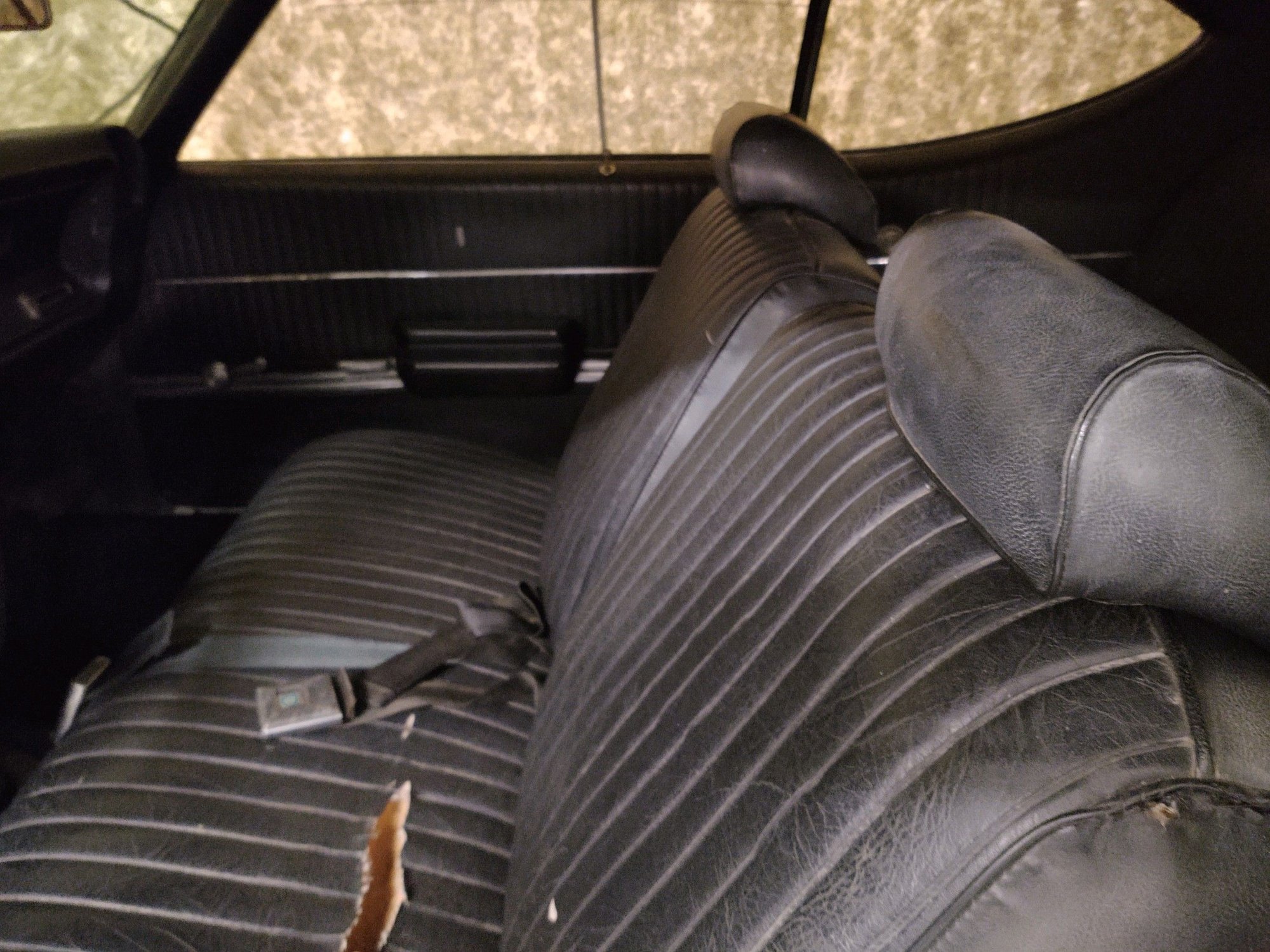

I believe I purchased the w31 that was being discussed here. I couldn't pass on this car. The engine, transmission are matching to the car, 3:91 manual brakes, bench. It is missing the 255, has a 67 pontiac carb. It has a 70 w30 waterpump??? The rear quarters are bad, the wheel houses, surprisingly, are useable. The frame is perfect! Still has the born with windsheild....could be a correct 43k car. All wire clamps are still on radiator hoses, and they are rusty, 4 core, clutch fan. I'm including a pic of the transport co. Unloading.

Your interior reminds me so much of my Supremes with some slight differences. My bench has a built in center armrest for one, but what really got my attention is how small your doors armrests are. Like half the length of mine... Looks like the factory took that weight savings thing seriously... No frills all go, love it !

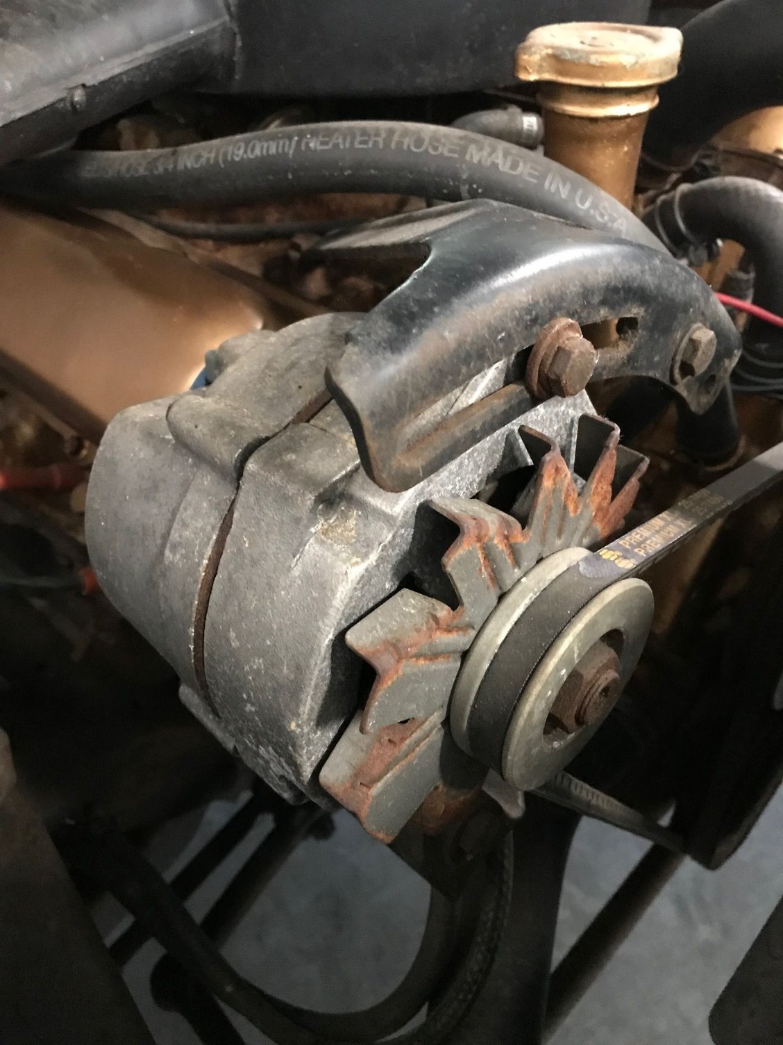

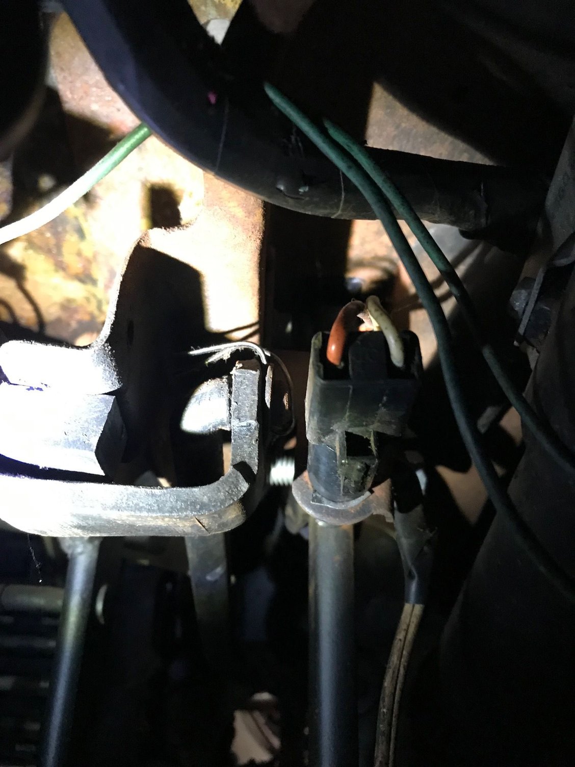

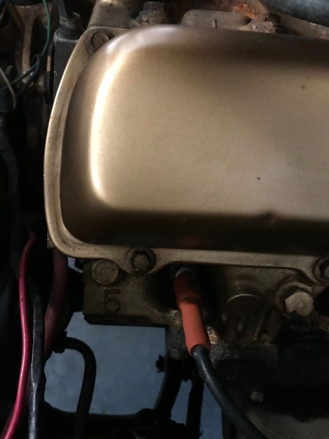

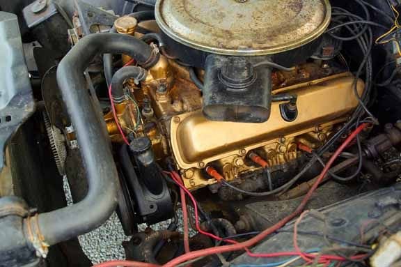

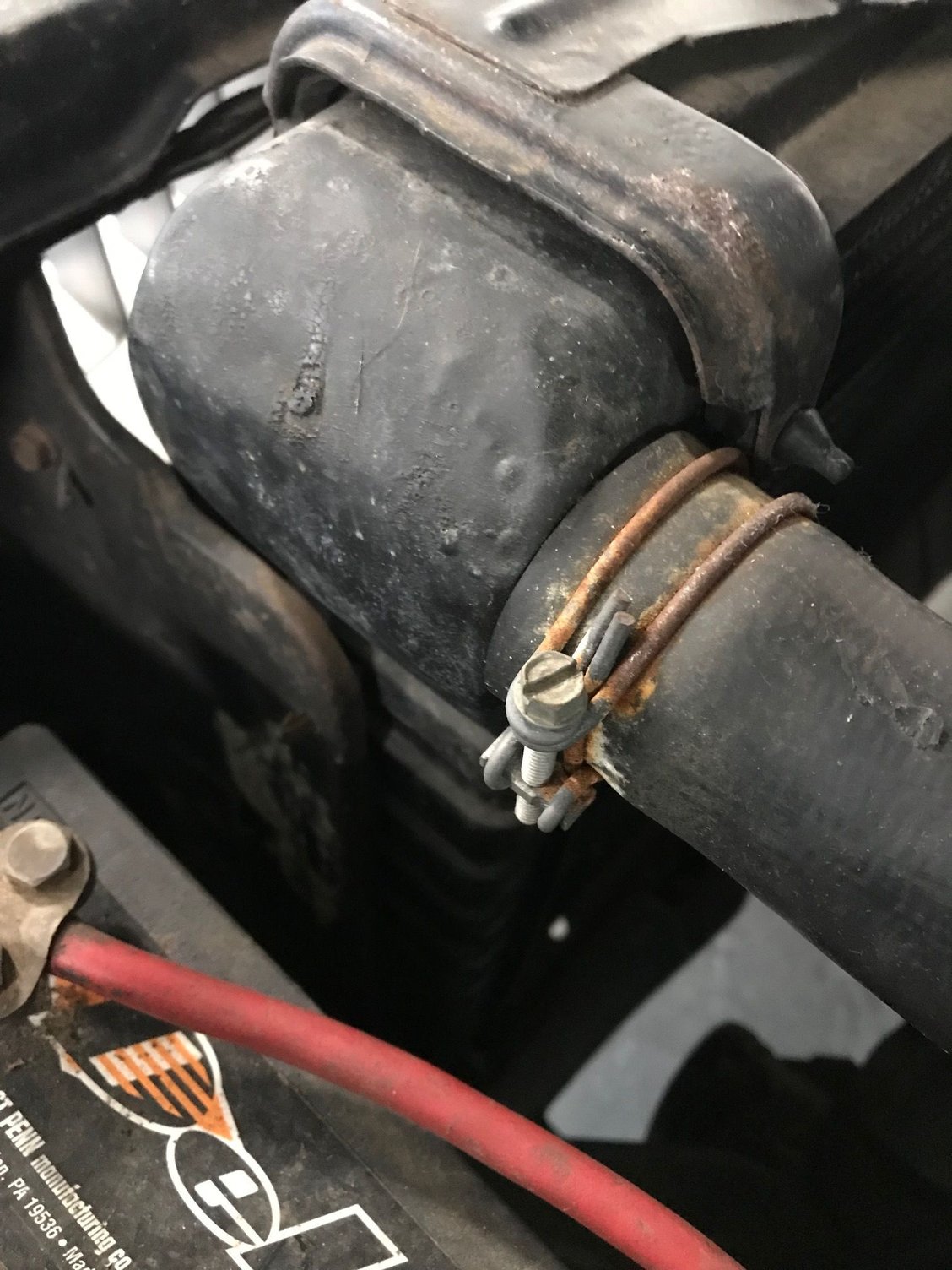

Here are some pics that I took when I looked at the car. I'm tearing up a little.... Glad it went to a good home and look forward to seeing it brought back to its glory days.

Great pics, I have the car sleeping right now and letting it slowly wake. Did you notice the 2 groove A/C P/S pulley? I think this car being a "plain jane" had manual steering and swapped out at one point, hence the ac dash vent.

I did not notice that. Is there any evidence on the firewall that an evaporator box was removed? My 442 was an AC car and you can still see the outline on the firewall. (need to fix that one of these days)
You really should contact Ryan once you get into it a little more. He'll be able CSI the hell out of this car.

so that's the "top secret" car, not sure why some didn't share info. looks like the alt pulley has been changed too. I've been somewhat kinda looking for an S post, but I have enough going on right now. Not to mention things to fix on my 31.
