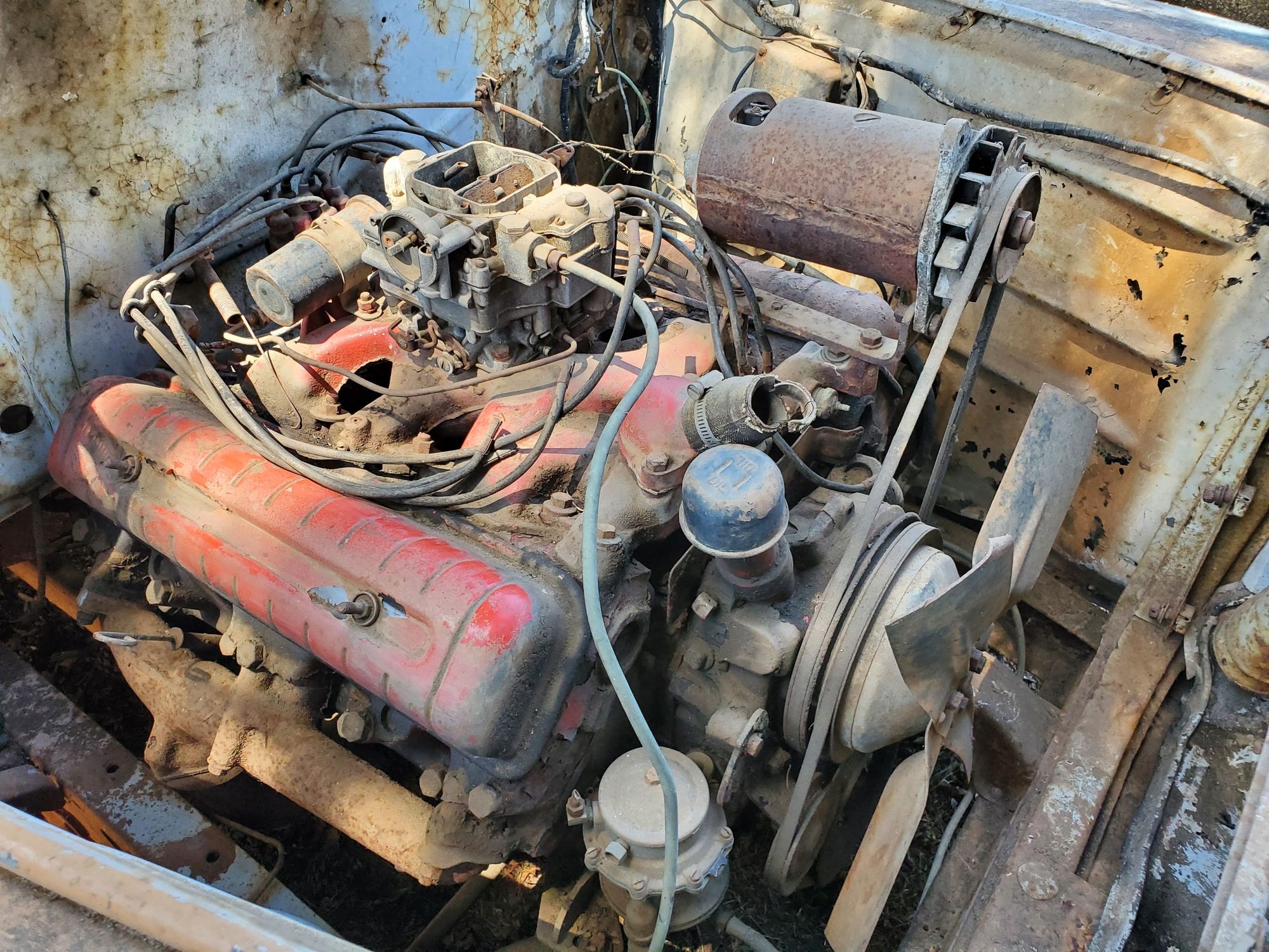

Old Jul 11, 2021 | 12:05 PM
bnwbass's Avatar
Joined: May 2021
Posts: 3
Here some photos.
Hello All,
Hopefully someone here may be able to help me identify from what I am told is an Oldsmobile engine. I am doing a restoration on a F1 Ford Truck. Two photos left and right angles of the engine. I know the block codes are on the timing cover shelf but hard to see, may need to steam clean first. Thought I would see if anyone may know from only a photo?
Old Jul 11, 2021 | 06:30 PM
Posts: 50,806
The valve covers in the photos look like an Olds 303. It's missing the spark plug wire covers.
Old Jul 11, 2021 | 08:43 PM
redoldsman's Avatar
Proud Viet Nam Veteran
Posts: 10,817
From: Rowlett, TX
The valve covers are 49 or 50 and as Joe said the spark plug covers are missing. These valve covers were a popular swap onto later 303 and 324 enignes. So it is either a 303 (most probable) or a 324. The double water pump and crankshaft pulley and the fact the generator is on the left side of the engine indicates it is a 49-51 303.
