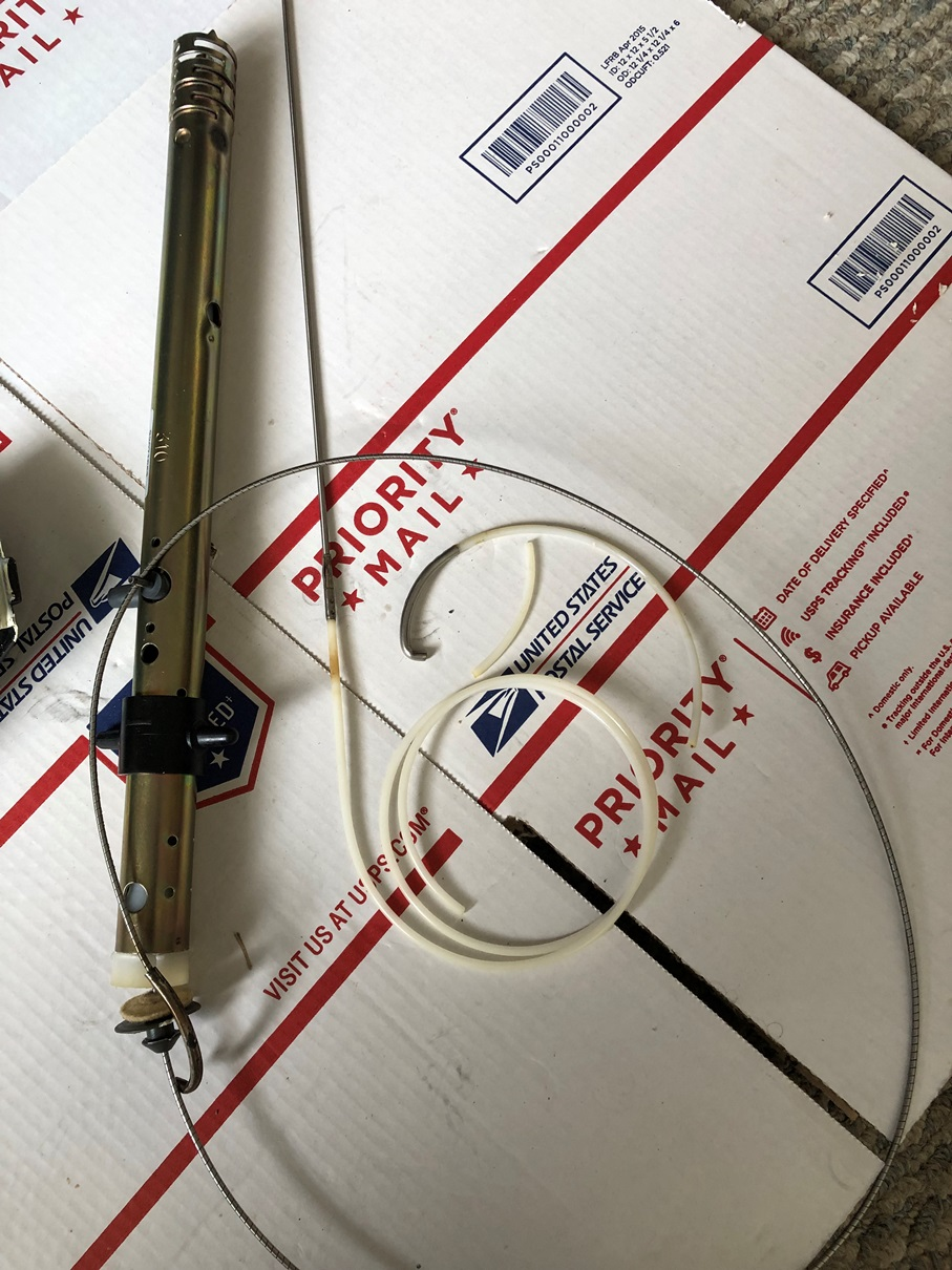

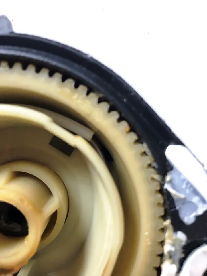

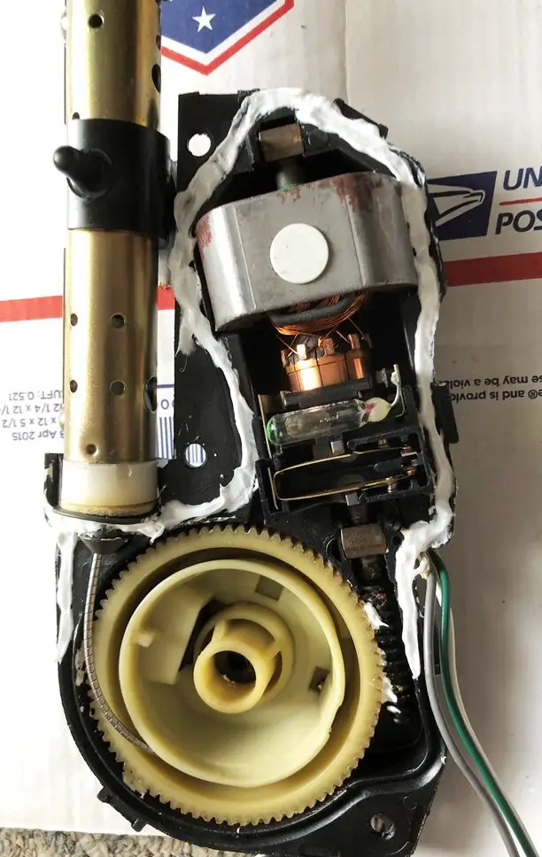

NOS doesn't always mean it's going to work, especially those nylon cables. And it's hidden. So you never know. I've had NOS antennae work never, once, and maybe twice before giving up the cable. Go with the metal cable and don't look back. So even before it was ever bolted to a car, it needed repair.
This is showing where an NOS antenna cable (named Felisha) broke just sitting in the box. Went to test it and it didn't work. Found the problem. Yikes.
Also, found the solution- metal beats plastic. You can see the breakage of the original nylon cord:
And ready to put the casing back together, new metal cable installed- bye Felisha:
