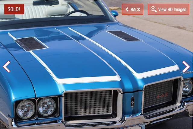

Had anyone converted the fake hood louvers on the flat 442 hood (not the W25 hood) to be functional? Either for heat extraction/ventilation or as a fresh air intake source. I really like the look of the flat hood over the W25 hood (as Joe P has stated, there are more cars today with W25 hoods than ever left the factory with them) but I would like to make the vents functional.

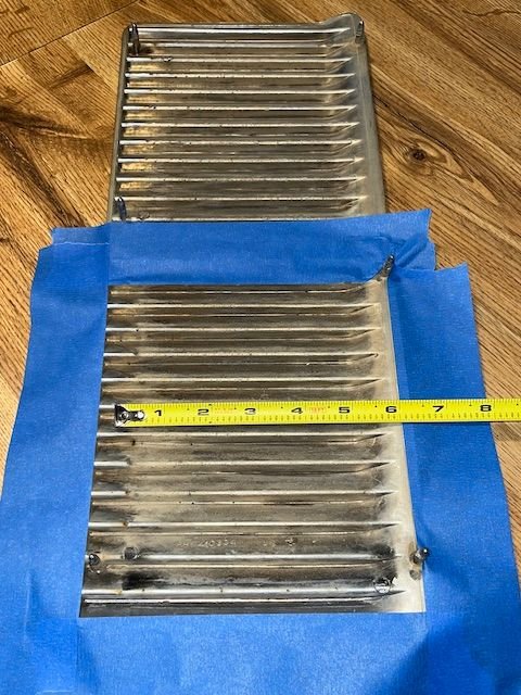

As a cold air intake, the rear half of each louver is situated above the brake booster and the HVAC suitcase making it impossible to fit an air box below, but the front half of each louver has room below that could be opened up as in air intake. There are about 23 fins in each louver; If I cut a 1/8" slot in 12 of the fins, each slot would be approx. 5' long; that would create a net opening of 7.5 square inches, 15 square inches total counting both louvers.
Any thoughts on this? Is the net opening too small? Crazy idea? Not worth the effort?

This is the flat "442" hood with the fake louvers.
This is the back side of the cast louver. Using a 4" grinder, I would cut 1/8" slots in 12 of the fins to make them functional. I would have to cut a hole in the hood as well to allow airflow into the engine bay.

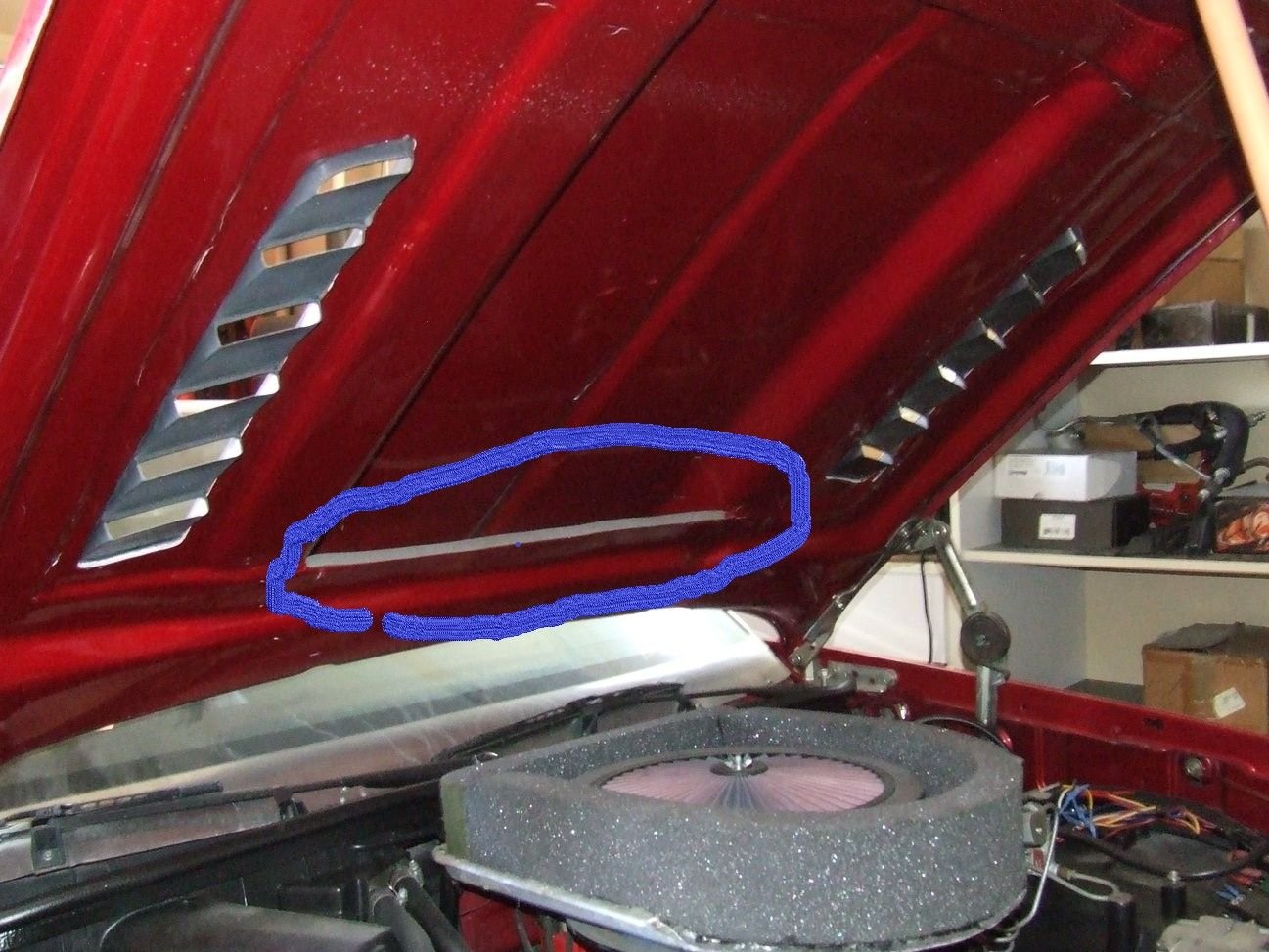

This works great for me. Cowl and 2 engine vents. Real world testing. No hot air or smells coming in from vents.
