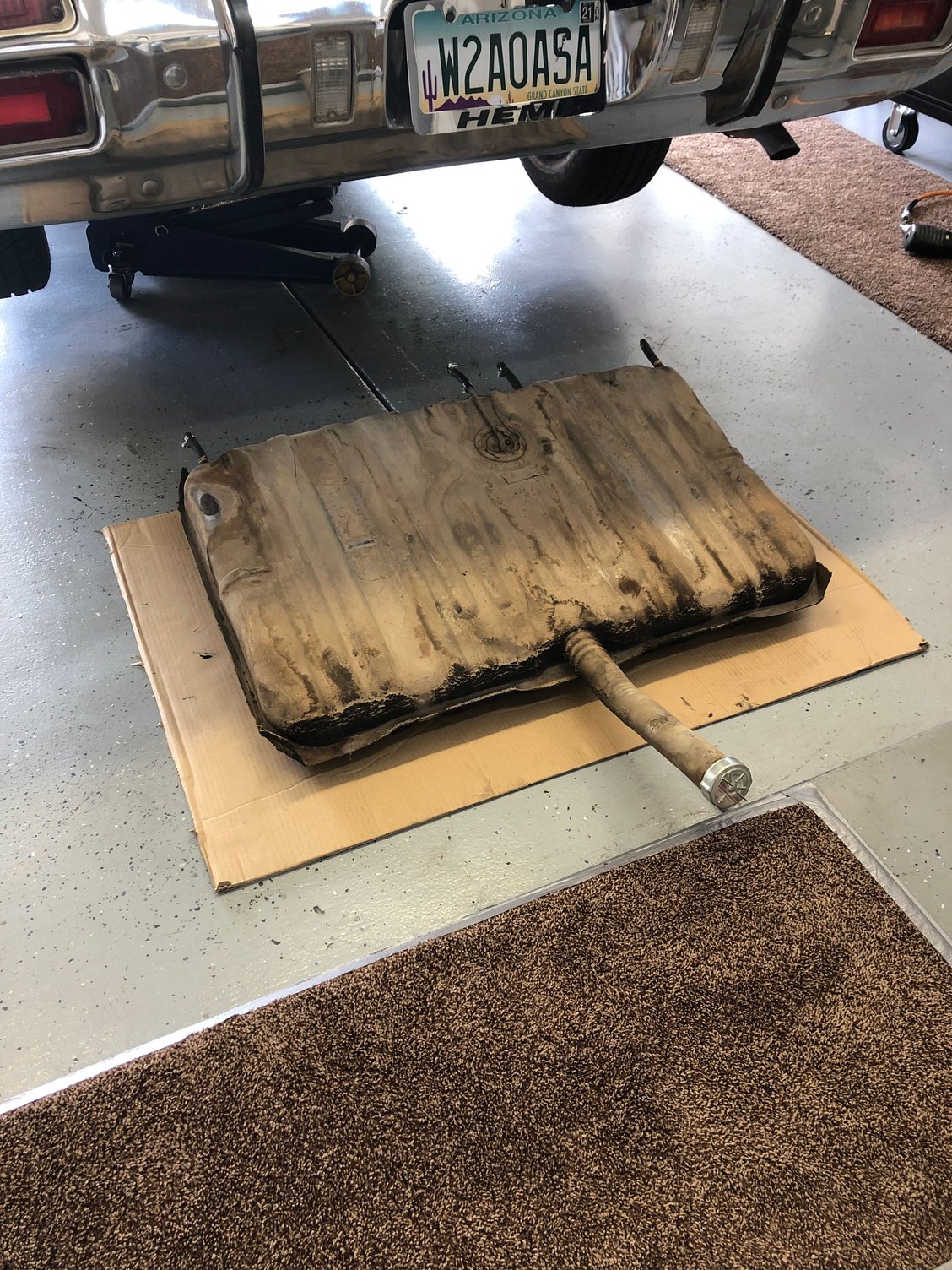

where is that located? i just took my tank out lastnight or is that a 699999-70 onlt item?
I’m replacing all the hoses they were leaking
Looking at your picture it’s on the right rear. Mine is off a 69, don’t know about other years.
