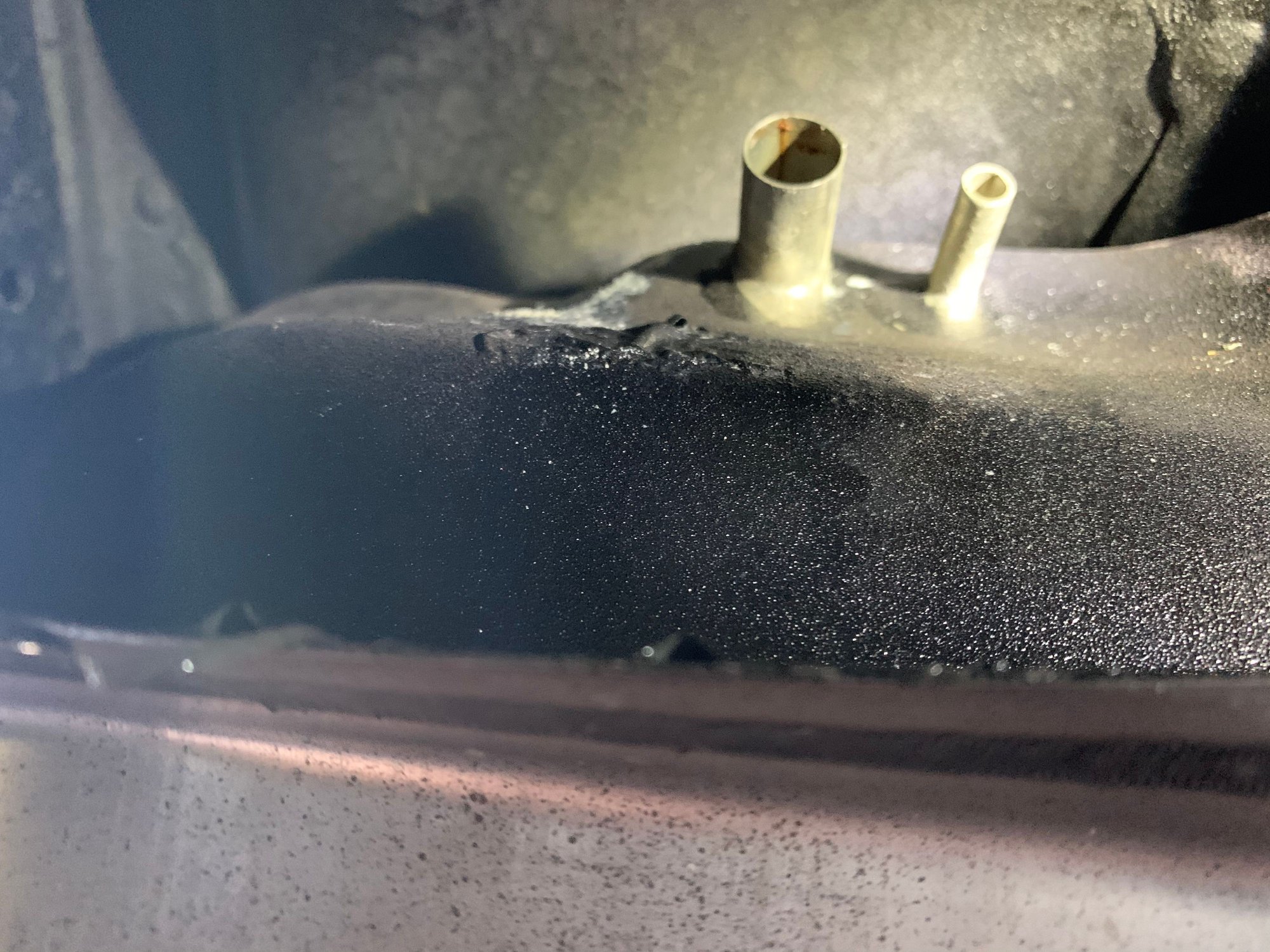

Hi All, so I just filled up my gas tank and when I stopped to visit my cousin and got out of the Cutlass, I noticed there was fuel dripping from the fuel tank. So we jacked up the car and looked underneath and it appears the leak is coming from 2 small vent holes on the fuel tank/passenger side.
Did I over fill the tank so it’s dripping out?
Are the 2 vents supposed to be empty or have a plug in them? Should I drain fuel tank to a certain level so it doesn’t leak from the vent holes? Thank you all...

there should be two rubber lines with a restrictor and clamp holding them vertical,

Oh wow, they probably fell off then I imagine. This is great info. Appreciate the help.

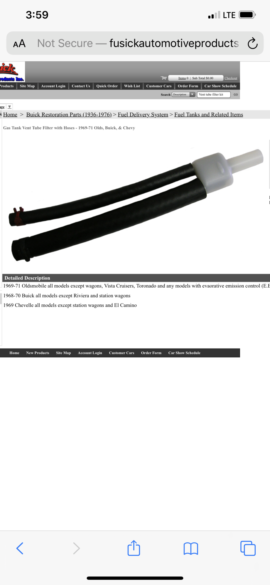

You might want to retrofit it with the "1969-70 Gas Tank Vent Tube Filter Kit", available from Fusick (www.fusick.com). The part number I have is GTF690K but that might have changed. Price is around $25-$30. The vent tubes on my '68 were old and cracked and there is something stuffed in the upper end of each tube to allow venting of the gas fumes without allowing gas to splash out. The '69-'70 set-up is very similar except the end of each tube is attached to a separate venting device that does the same job as what was stuffed in the '68 vent tubes. I put one on my '68. No one sees it - it's out of sight and it does the job it was designed to do.

Perfect. This is the part correct?

That's the part but I don['t have an after-install pic. It went in pretty easy with the hose clamps that were provided. And I used the metal tab on the gas tank to hold everything upright once I attached the hoses to the outlets on the tank. I like it because it represents an upgrade to what was offered in the '68 model year. Plus, my '68 is pretty much correct as it would have come from the assembly plant so, with this assembly hidden away where no one can see it, I found that acceptable to deviate from the assembly plant norm.

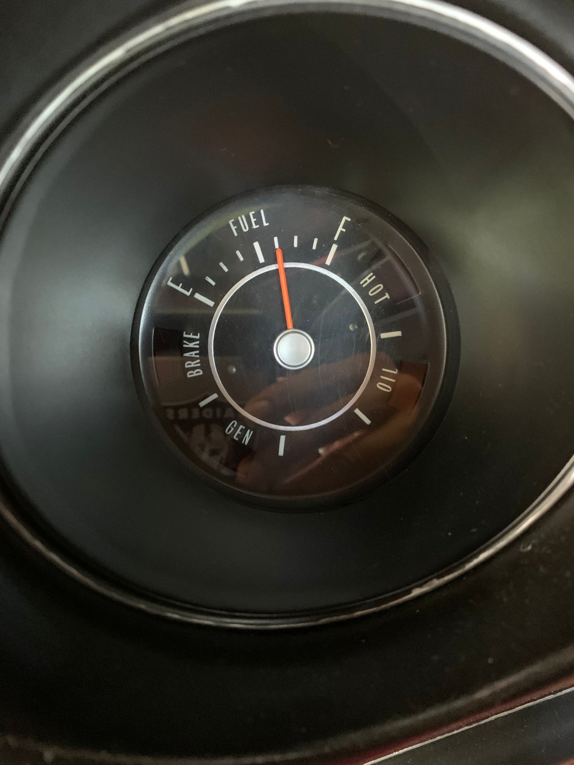

If your gauge / sender is anything like mine, it is nowhere close to being a linear representation of the fuel level. Routinely, after a fill, I can drive ~1/4 tank before the needle moves off "F". So by my estimate, the gauge's range covers only the last 3/4 of the tank, thus a reading of half-full is really only about 3/8 of a tank. Its been like this since at least '74 when dad purchased the car from its original owner (our neighbor) w/ ~23K miles.
