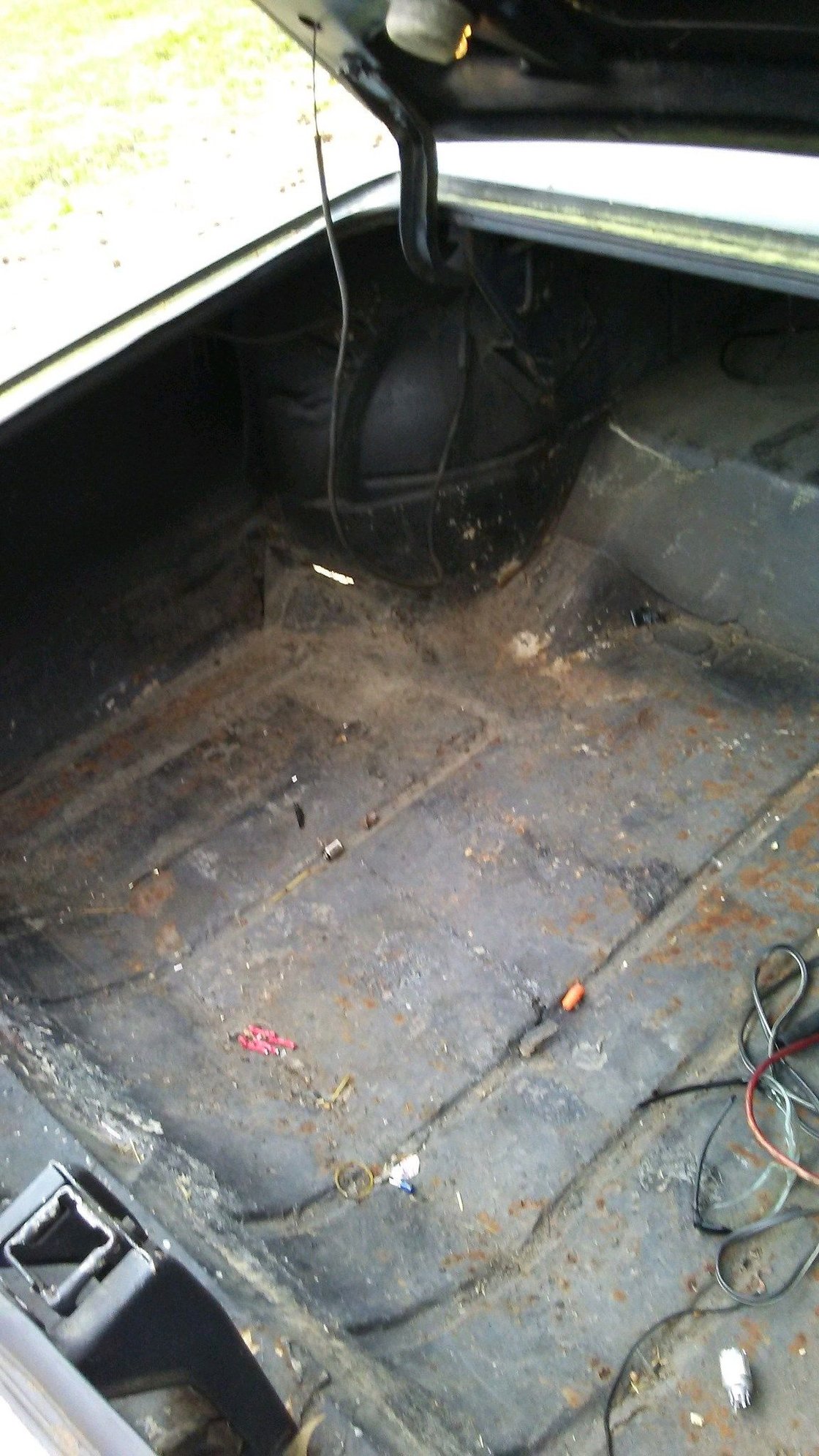

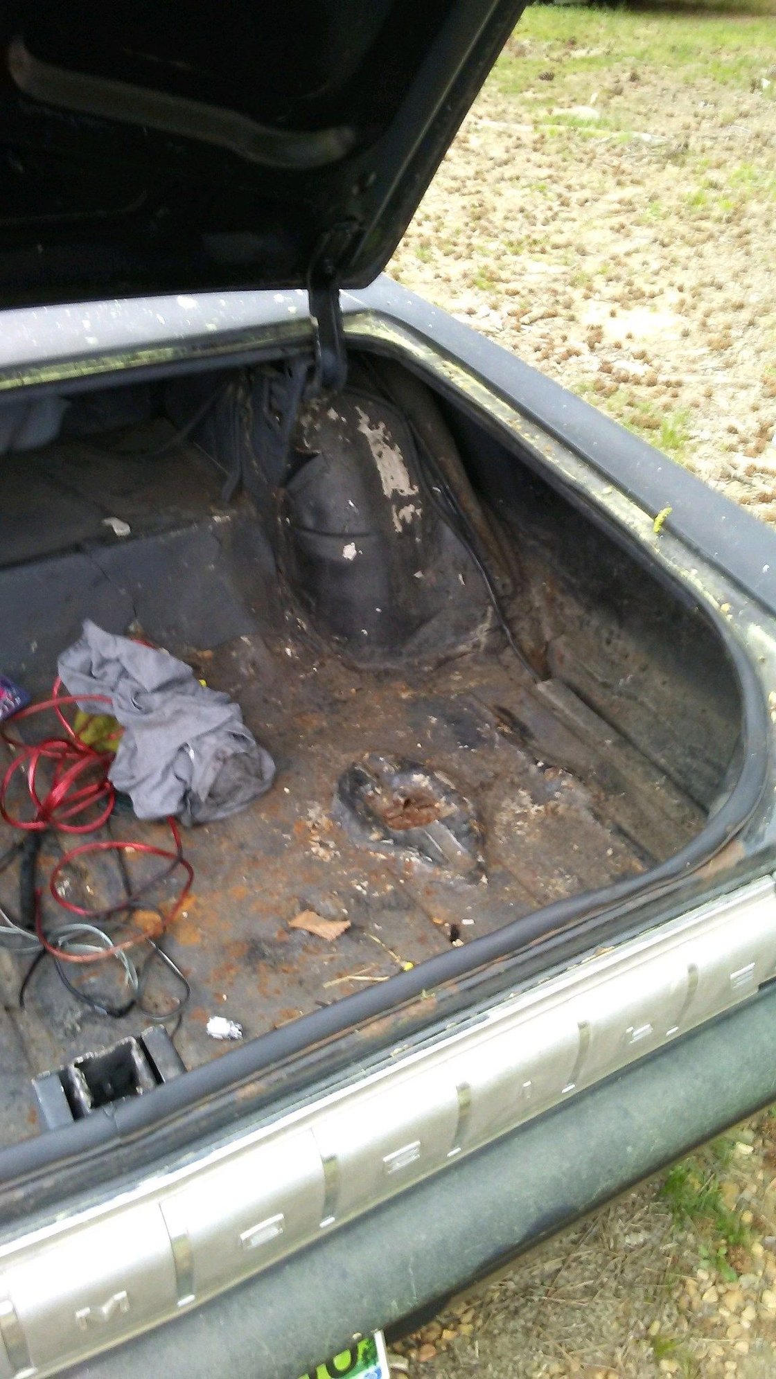

I’m not trying to restore to factory correct EVERYTHING but overall want to keep the stock look. Had a friend check this car out because I’m away at work and can’t go personally yet. He says that it has a fair amount of bondo, some of it probably needs to be redone but overall it’s a pretty solid car. It runs and drives but dies at idle. (I’m thinking probably needs carb adjusted) Has original 330 motor and power glide transmission.
im wondering if some of you guys that know these cars better can tell me about some things to look for. Floors are good with very little rust and trunk has some surface rust but not too bad. I think it can be bought for less than $6k let me know what y’all think!

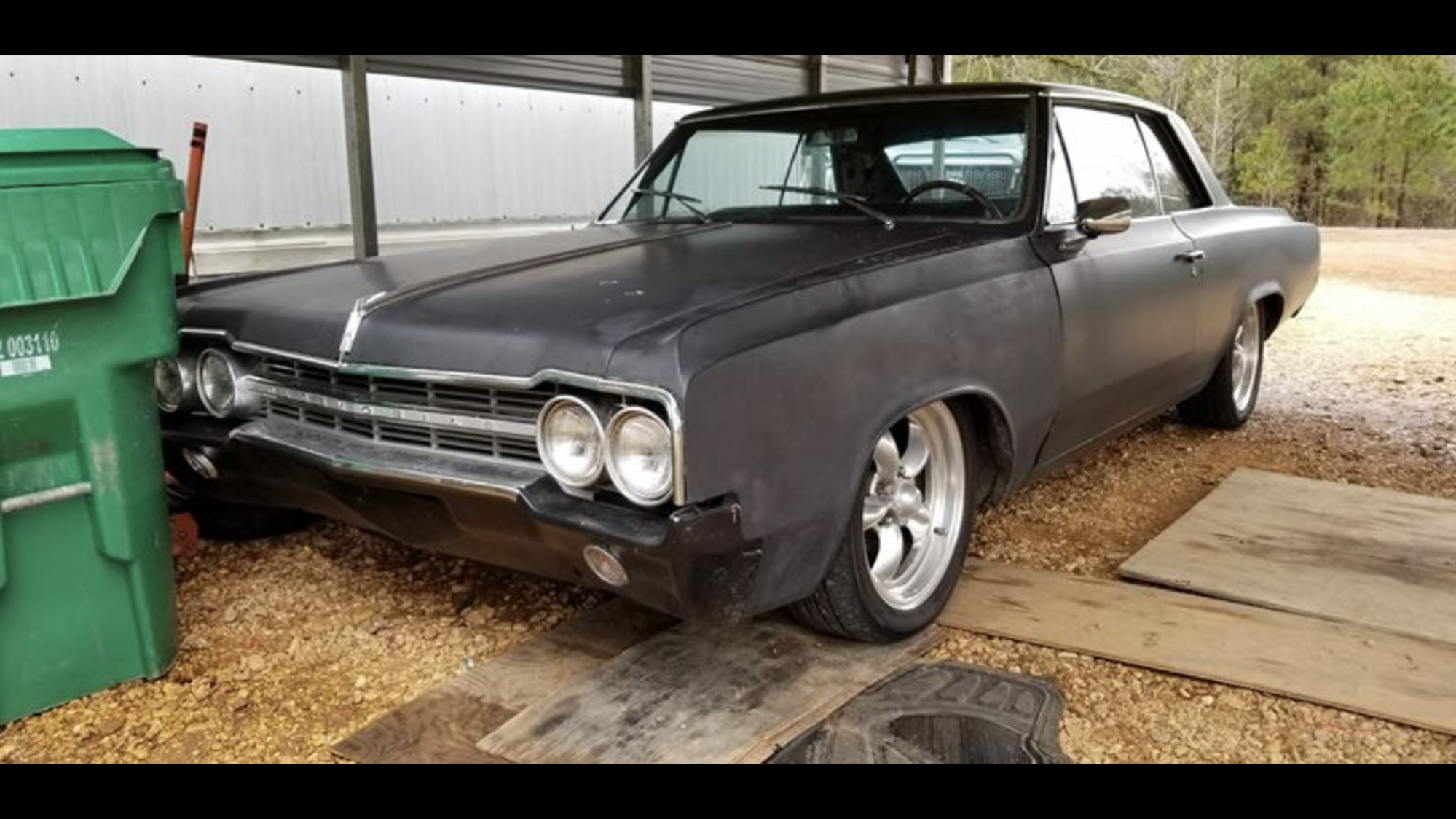

How much research have you done ? Whats it worth to you ? Sorta looks like a 65 front end to me. I am sure others could chime in on the subject.

I think you’re right after looking at pics of 65’s. Just going off of what the guy had listed. All I’ve researched is parts and it seems like most of what I need are available. Might have trouble finding sheet metal but that’s why I had a friend check it out and he says it’s solid.

That car has a '65 front end, from the doors forward, glommed onto a '64 Cutlass. You can see in the first photo how the left front fender doesn't align that with the driver's door. If it were me, I'd pass on the car and keep looking.

See this is why I joined the group! Looking at the front end and rear end and looking at pics online y’all are absolutely right... so other than it not being ‘correct’, what would be the problem with that? No different than buying a new fender for a wrecked car right? Again I haven’t even seen the car for myself, so I might see it up close and want to pass anyway. But as for just having a cool old car I wouldn’t really care if it wasn’t like it came in 64.

It's all personal taste. This car is what would be called "modified," which is anything done to it that wasn't available from the factory. Some people like this sort of thing, others prefer original. To me, the car is a frankencar, a little bit of this year, a little bit of that year. It reminds me of the Johnny Cash song "One Piece at a Time."

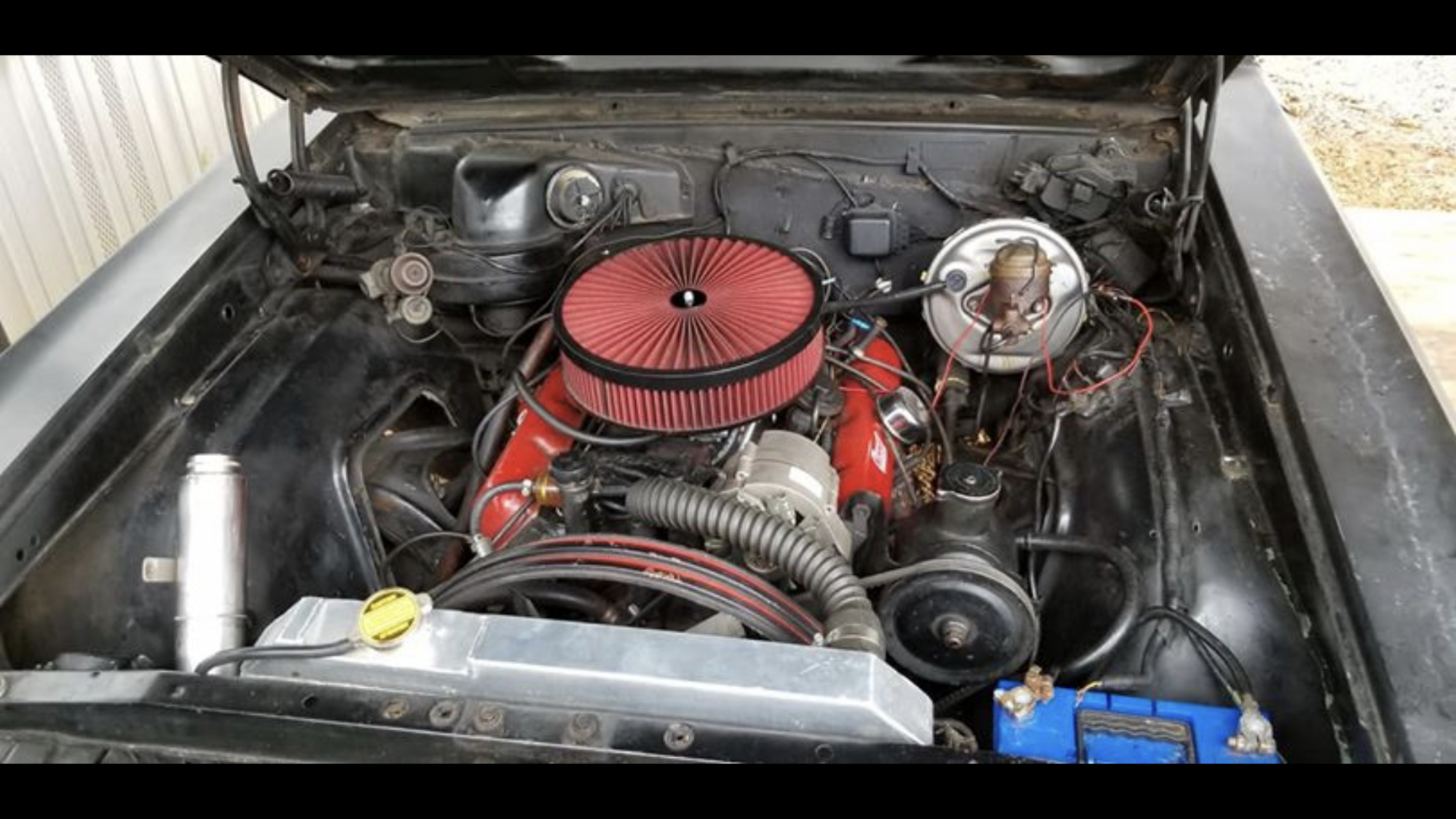

Since it has been modified in the past, are you sure the engine is a 330? All small block Olds motors look identical. And that is not a 330 oil filler cap.

No I’m not sure of anything, just what the seller has told me. And now that I look back he did say it was an st-300 trans. I’ll check the vin against the block numbers but there’s no title, just a bill of sale. Apparently in Alabama cars over 35 years old don’t need titles.
So if the block numbers aren't legible I probably wouldn’t be able to tell the difference between the 330 and any generic 350? Guess I should research some distinguishing features to look for.

Well I pulled the trigger. The body does look good and straight. There’s a few places that need some patching before it ready for paint but for now it’s more than ok. They guy really had no idea what he had. Thought it was a 1964 88 block numbers say it’s an olds 350 from 68. Gonna get it running and reliable first and then work on the interior and body issues. Thanks for y’alls input!
