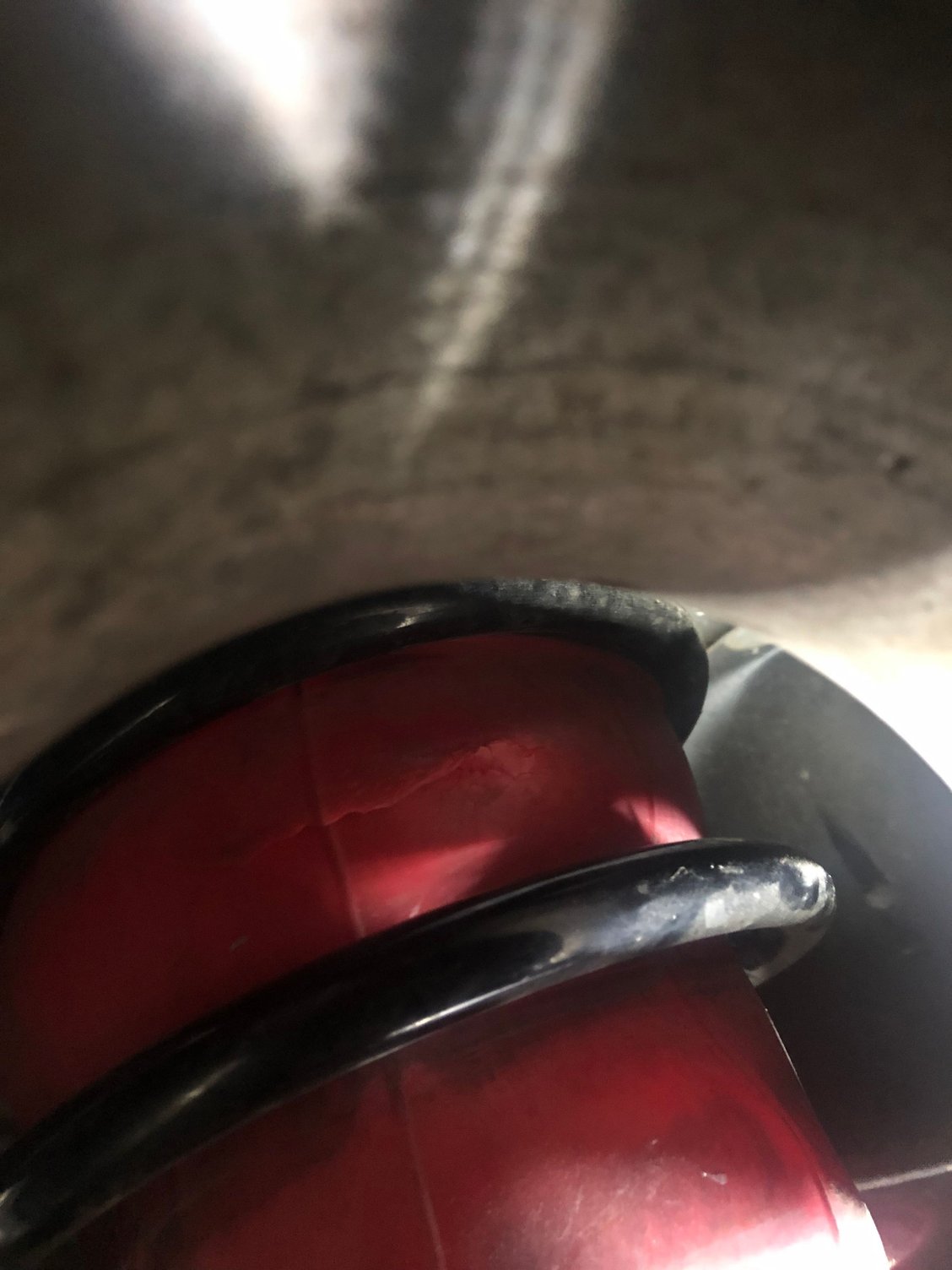

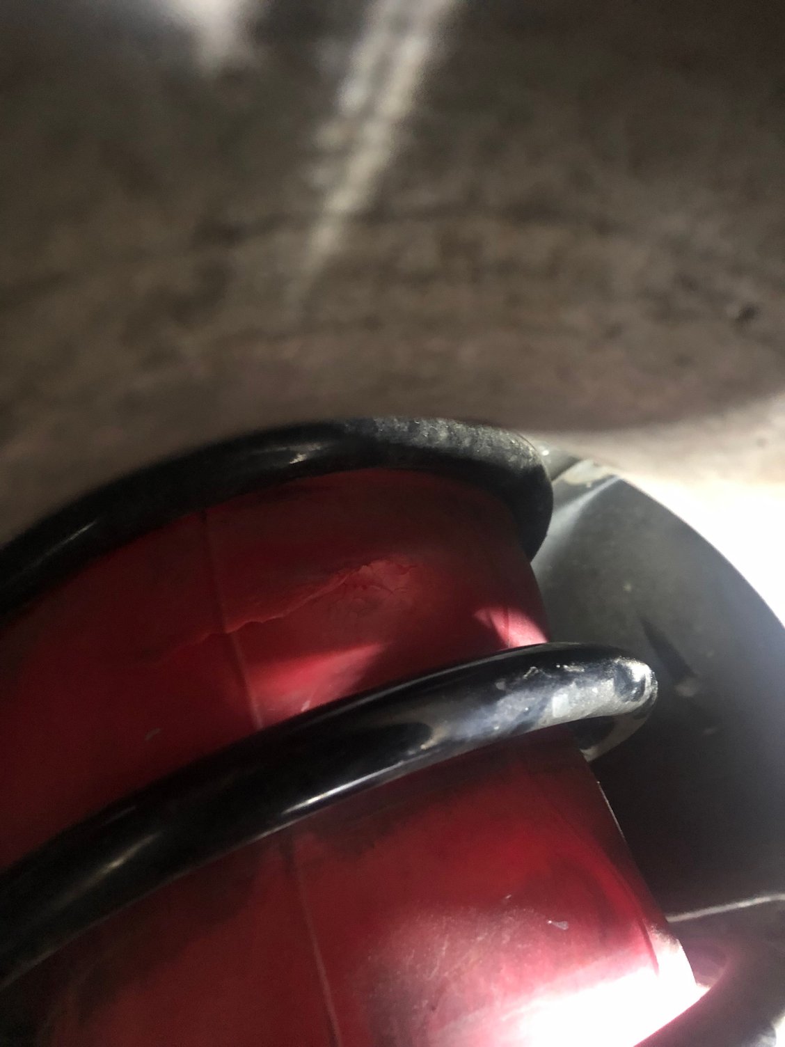

Now the bad: even though the tow company swears there is no way, there is an enormous gash in the drivers side airbag. It’s in the exact spot where the hook for the winch would go around the rearend. The tow company says there is no possible way their equipment can do that kind of damage, I’m not convinced. The airbags have been under the car for years, this isn’t a hole like something rubbed on it, this is a 2 inch rip. I noticed he car was sitting a little low on that corner, I assumed it was because of all the stuff I hadn’t unloaded after my trip to Murfreesboro. I’ll just add that to the expense report!

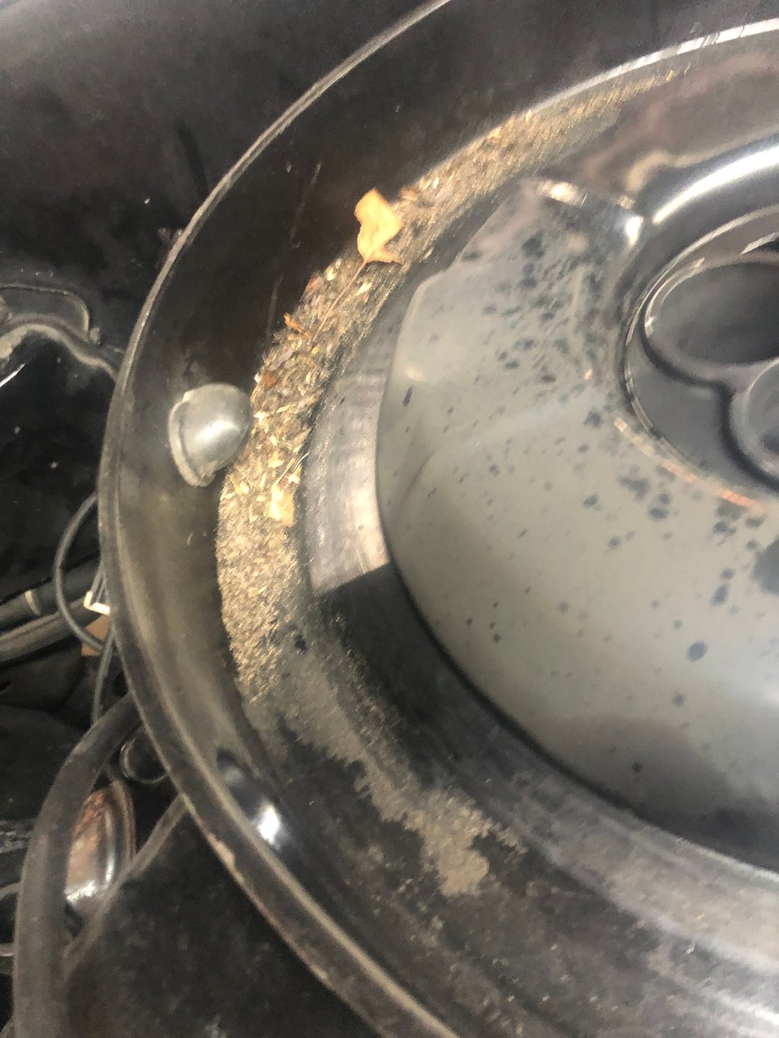

I thought this was kinda funny, the poppping back thru the throttle body did a excellent job of blowing all the crap caught in the air filter back into the air cleaner housing!!!!
The puncture wound to my airbag.
