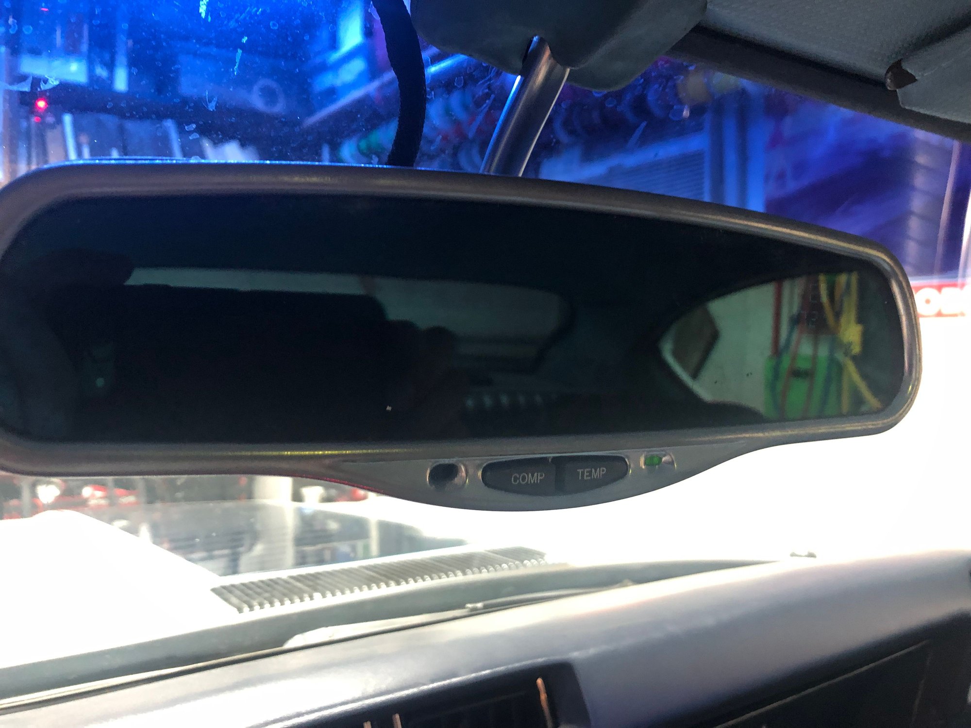

The finished project. Please note the mirror is dimmed. The car is parked in the garage, there is lots of light coming thru the windshield.
Same as above, except I put the shifter in reverse. This turns on the reverse lights, the mirror goes clear regardless of the amount of ambient light.

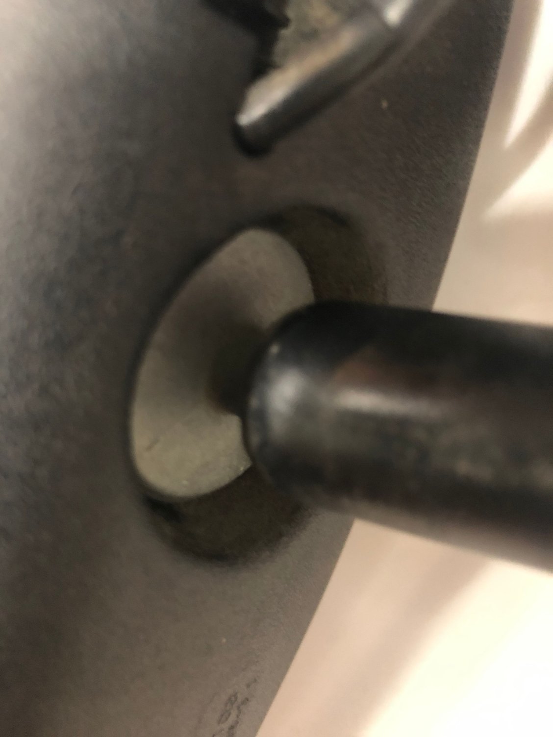

This is the dimming mirror ball mount. I made a couple cuts with a cutoff wheel around the ball, then peeled away the metal crimped around the ball.
Once I had the ball exposed. I carefully ground and filled the ball pivot until it looked like this:
I drilled a hole thru the center of the modified ball pivot
Once the hole was drilled, the new mirror will fit onto the original mirror mounting stalk.

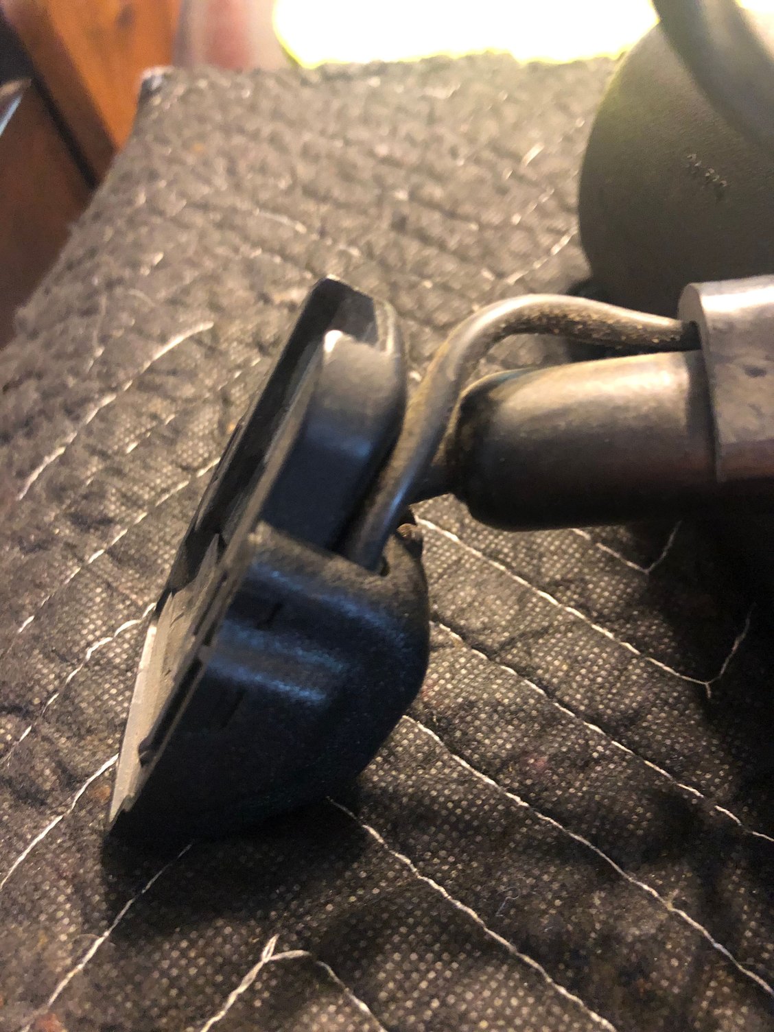

This is the original mirror mount.

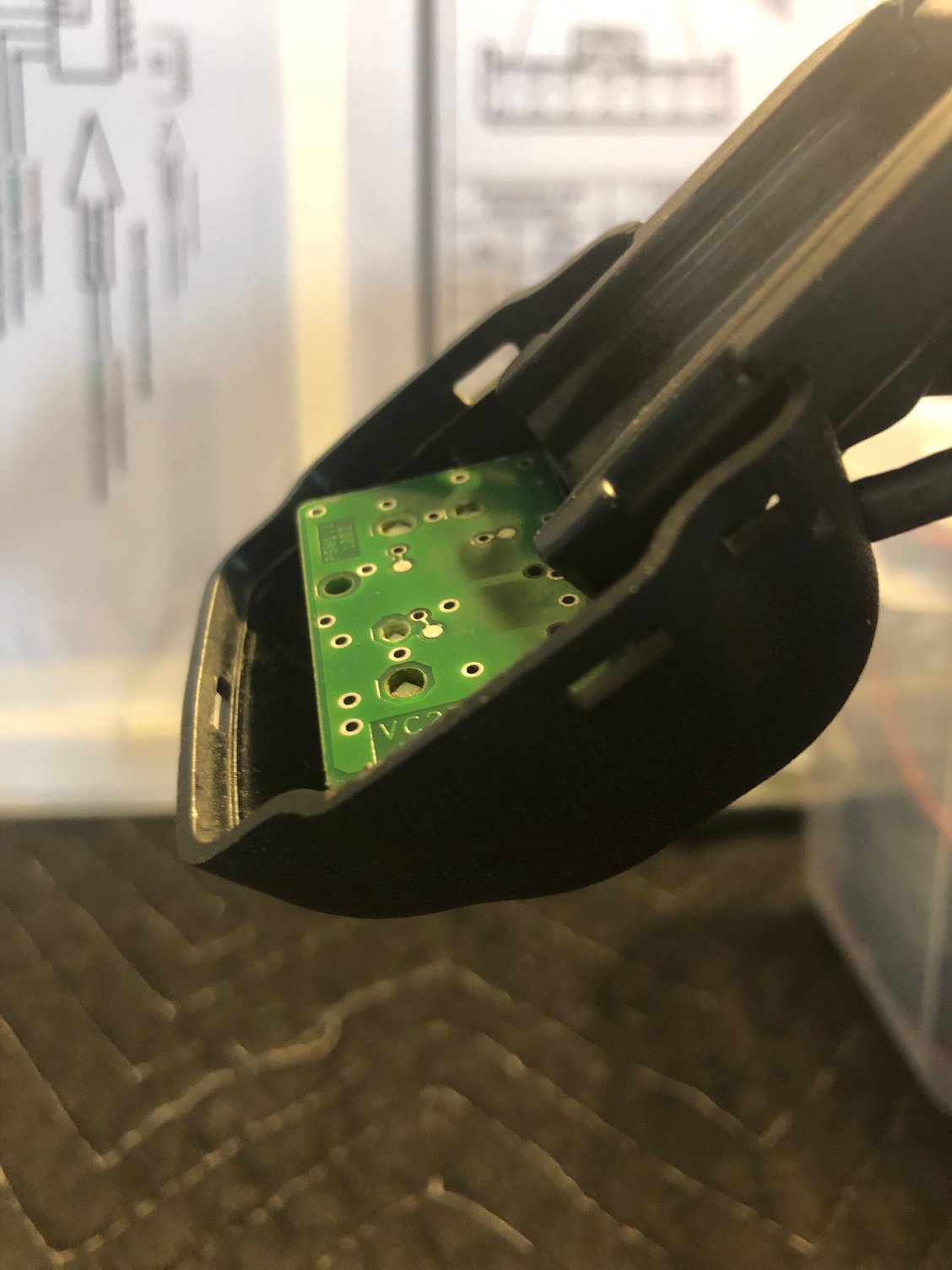

The original compass used sensor on the mounting button on the windshield. Since I didn’t want to glue a button on the glass, I needed another solution. After lots of brainstorming, I decided to modify the mirror housing and relocate the sensor.
My first attempt didn’t work, I couldn’t get the compass to calibrate. It dawned on me the orientation of the sensor is critical to accuracy. The sensor is tilted in the sensor housing at a 45* angle, and the windshield is also tilted at 45ish*. Add those angles together, the sensor is flat.
Sensor circuit board in the mirror mount, with the cover removed.

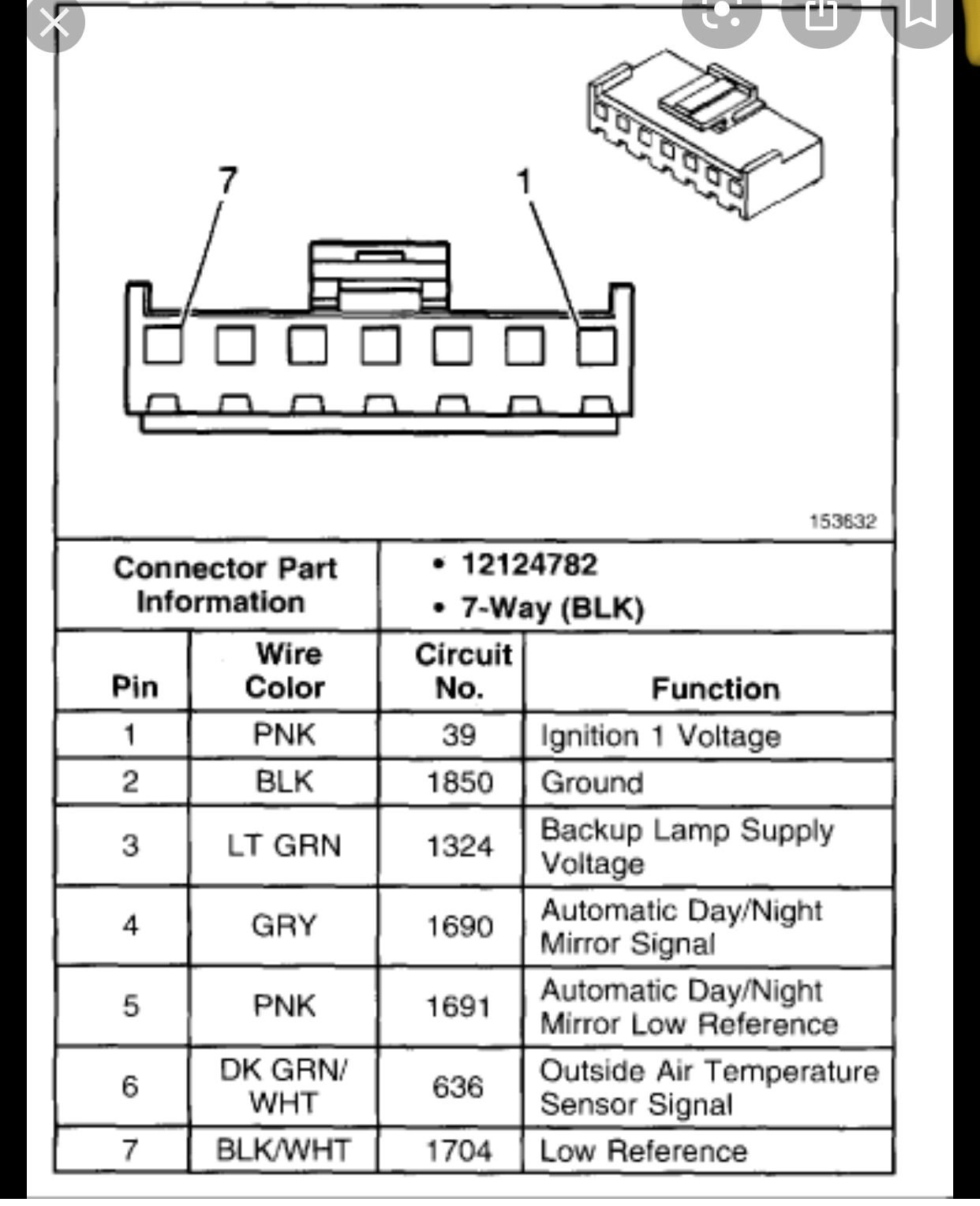

This is the wiring diagram. There are 5 wires that are required, the other pins are for the dimming door mirrors. I haven’t figured out a way to add those to the car, yet. 😋 pins 1 and 2 are ignition power and ground, pin 3 is reverse light input. Pin 6 and 7 go to the outside temp sensor.

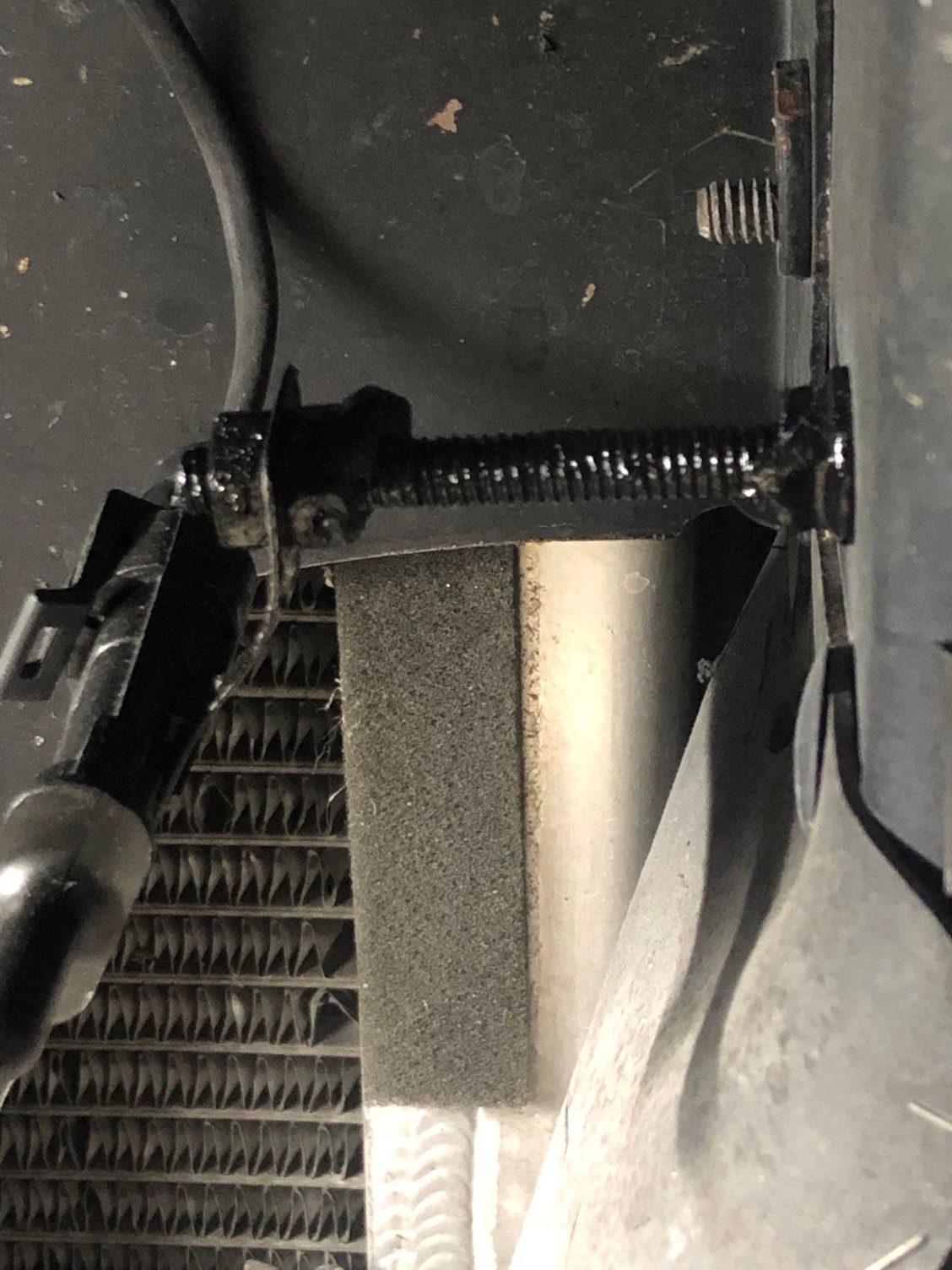

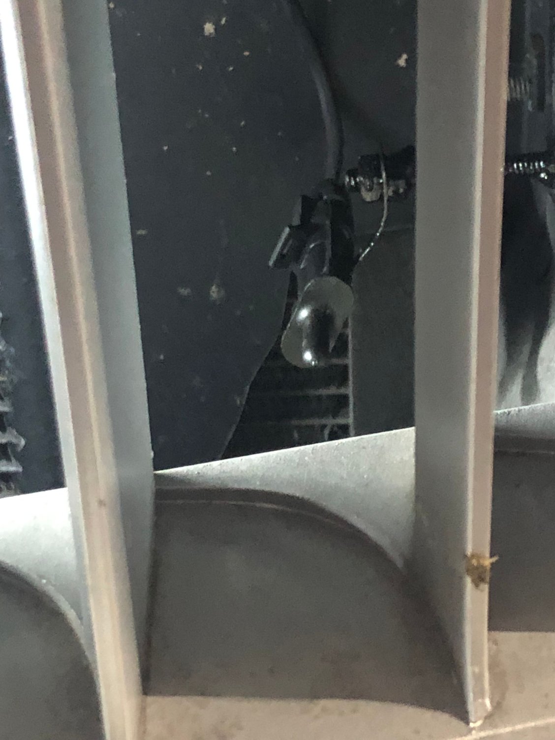

The outside temp sensor, looking thru the grilles. This is on the drivers side, near the battery.
I used 1/4 inch all thread to space the sensor away from the condenser, and in clear unobstructed airflow.
I put one of these mirrors on my daily driver Neon. I put the sensor way too close the the condenser, if there is no airflow (like sitting in a drive thru) the sensor reads the temp of the condenser. On a really hot day, after sitting awhile, the temp on the compass has gone as high as 147 degrees. I didn’t want to make the same mistake on the Olds.
The project is done. It works well. Would I do it again? Probably not. It would have been so much easier to glue the mount to the glass. And if I hadn’t already installed a new headliner, that’s exactly how I would have done it. I have worked on this project off and on for almost 2 years, I just had to see if I could make it work. For the most part, I’m pleased with the final result. I’m a little concerned with how the epoxy holds the plastic together. I’m a little worried about the sun and heat making the epoxy crack. Other than lots of time, I have maybe 60 bucks in this project.
Just one more thing to make my Olds unique.

I noticed you didnt mention pin 4 in your write up.
Your list shows it as the day nite signal...likely just a high or lo on this pin would fix the quto dim, or a toggle switch to pin 3 to simulate the reverse lite on

Pin 4 and 5 are both signals to cars with dimming door mirrors, cars with standard door mirrors have no need for those wires. I have installed this same mirror in 4 other vehicles with no problems using the 5 wires (power, ground, reverse input, abd 2 temp sensor wires). I verified that the mirror worked in another car before using it for this project.

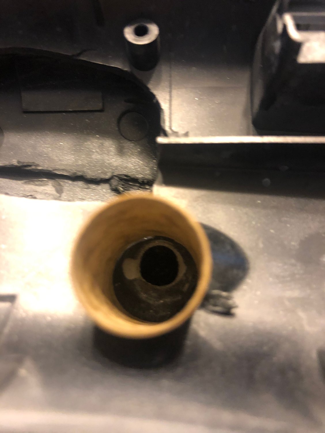

This is a modification I forgot to mention. There are 2 photocells on these mirrors, one in the front, another on the rear. The mirror compares the amount of light from both photocells to determine when to dim the display, and when to dim the mirror. Since the photocell is soldered to the circuit board it moved further inside the housing. I used a plastic tube to kinda funnel light to the cell. I’m wondering if I should have moved the sensor forward to sit in the same location as it originally.
