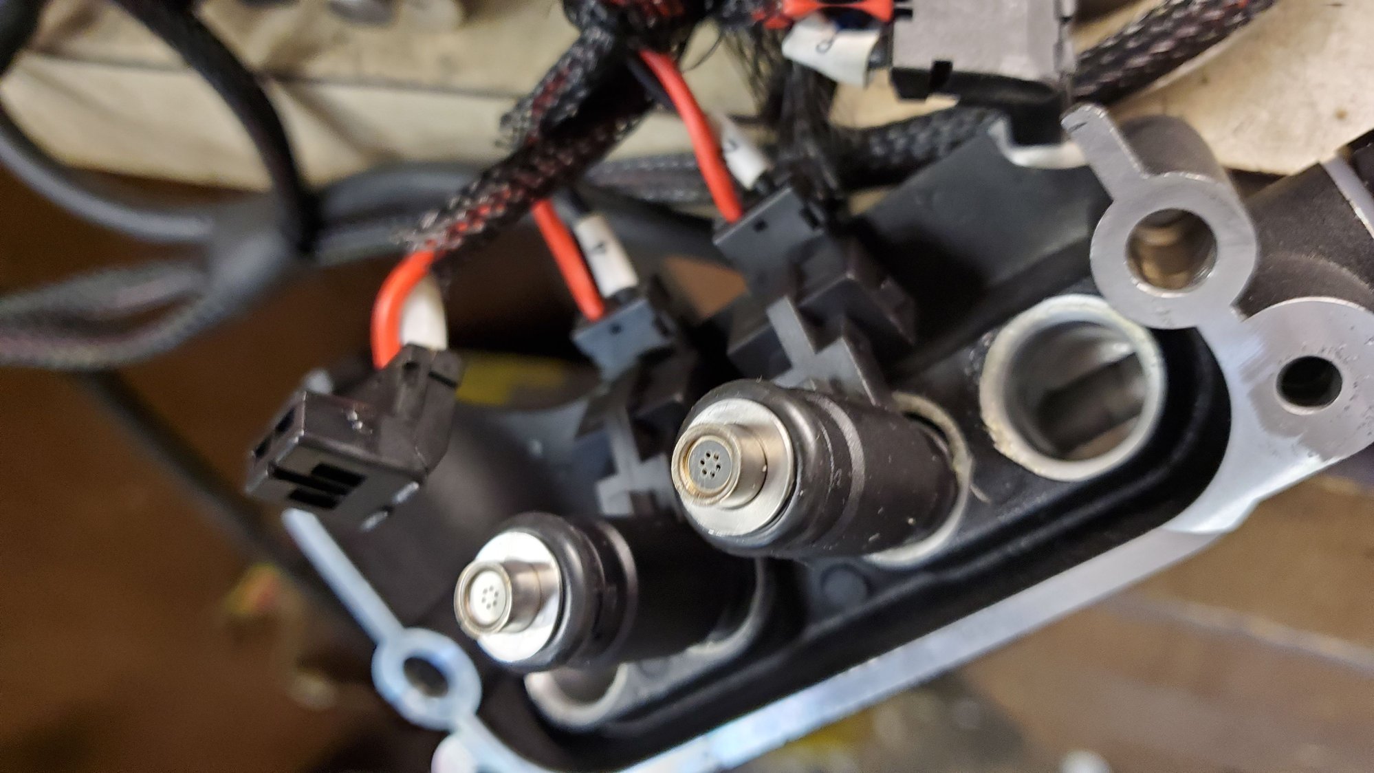

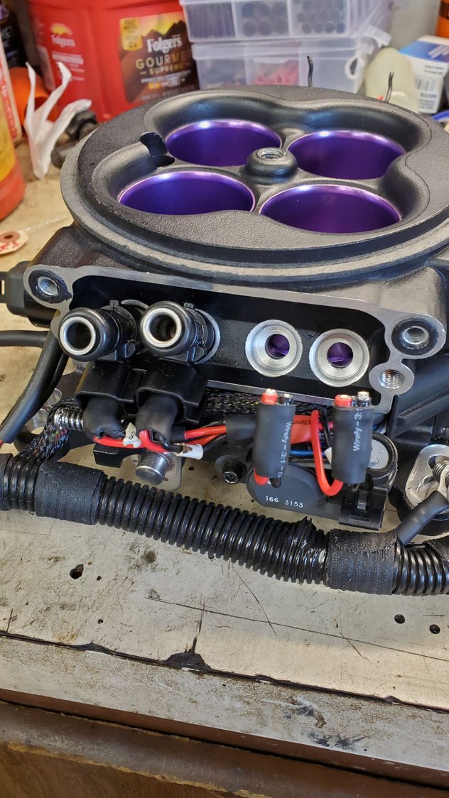

LS9 injectors are installed. Had to make some custom "plugs" out of Metripak connectors and shrink tube, but it looks like it'll work fine.

Hahaha! Thanks. There's probably 8-9 Folgers cans, plus buckets: plumbing, long bolts, injection stuff, clutch and brake stuff, weird electric stuff, etc

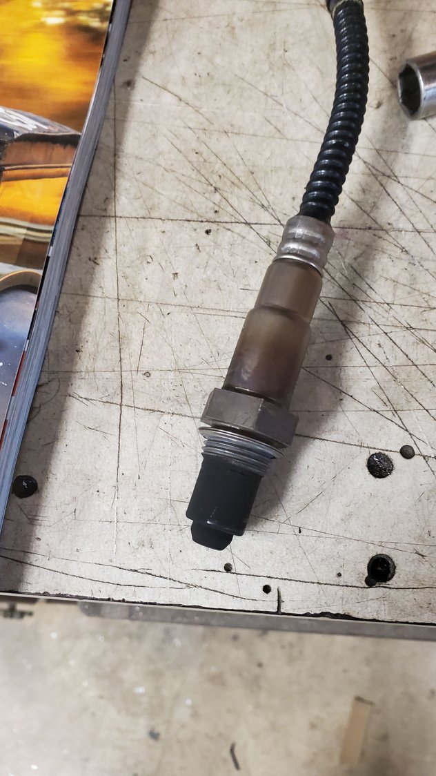

Man, just when I think I got this thing, BAM! It kicks me in my junk again. Vintage Chief helped me a bunch getting the laptop hooked up, and now I can access everything and stream data. However, in that process, I lost my "help" section that gives a description of each setting.
it has been smoking out the exhaust during idle, despite reading 14.3 AFR. I figured it was excessive fuel, so leaned it out and had it pretty good. Then, the idle jumped to 1500. I noticed that the TPS was being erratic, so that makes number 3. Prior to that, i had noticed that the rear injectors aren't firing. I have to call tech tomorrow to ask some questions. If the ECU is bad, I'm going to be really torn between putting their crap back in or ditching it for an MS3.
