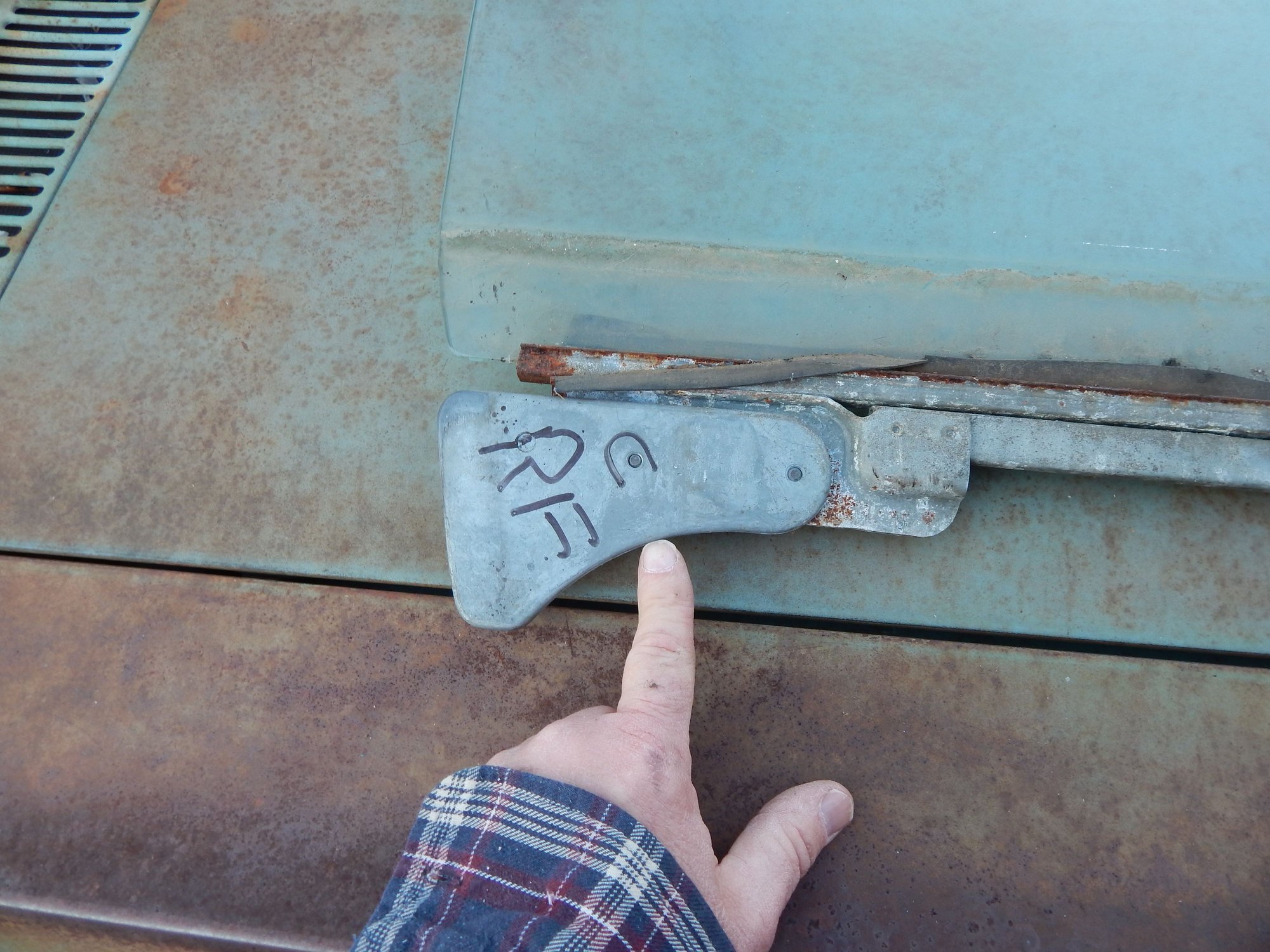

If you mean the trim in this picture. At the top you can see the rusty screw heads below the stainless that secure it to the body. Same on the front doors.

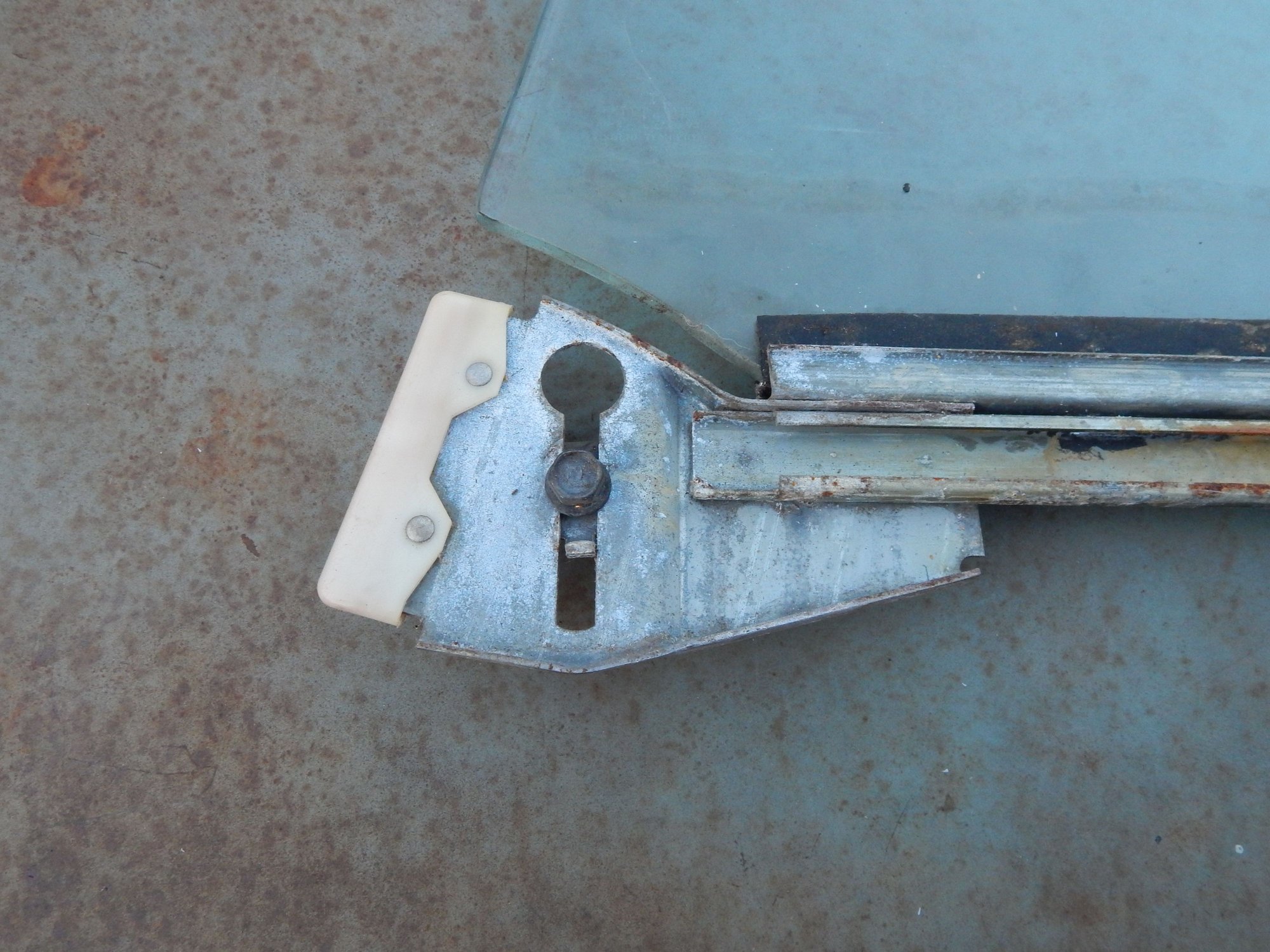

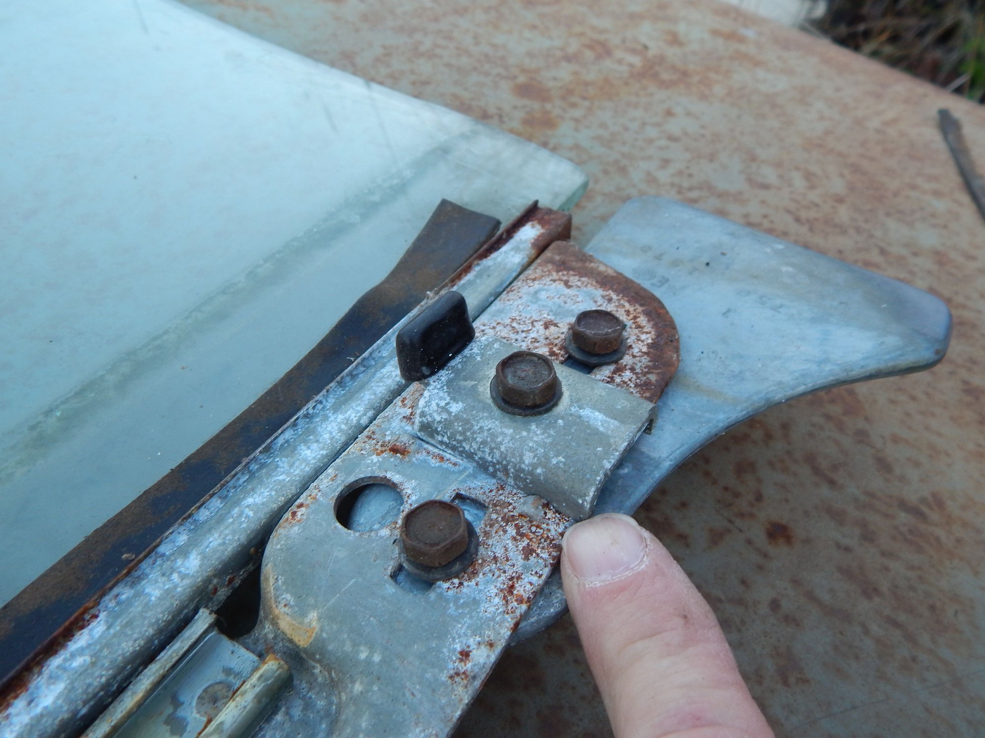

OK, not sure I follow the window glass stops. Here's one that stops it from going too far down, its a large L shaped bracket with rubber in it. If I'm on the wrong track let me know and I'll try to find what you need if someone else doesn't post it first. John

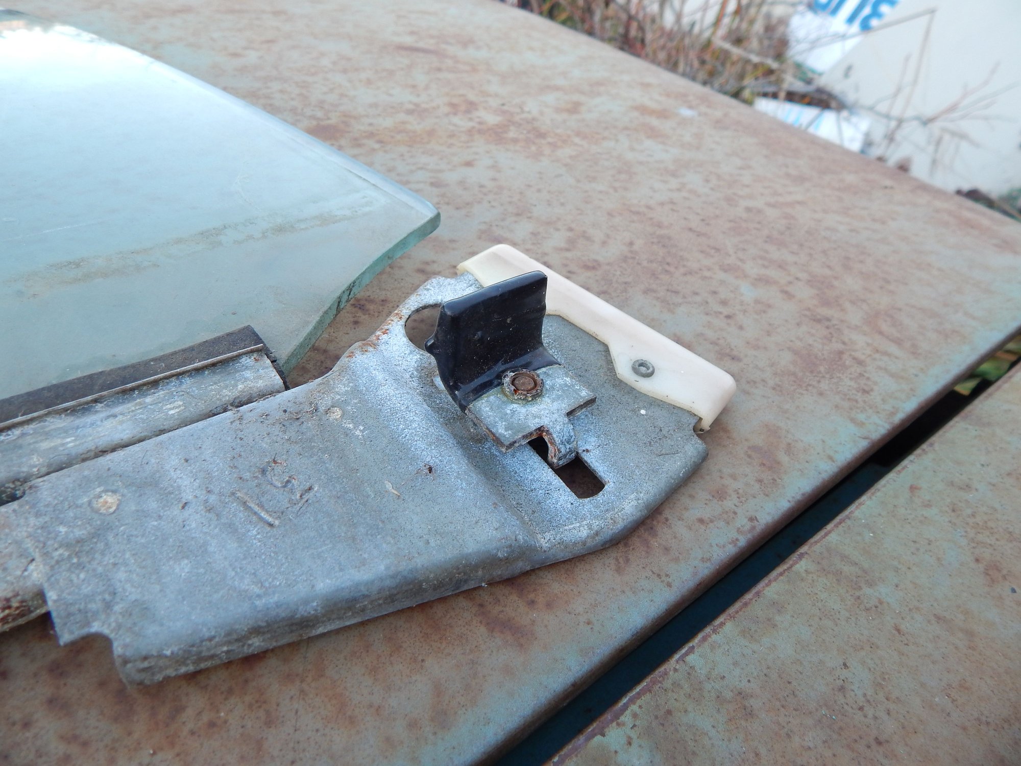

Thanks for helping me John, on my 442 which is a hardtop, I'm asking about the up stops which are bolted to the window mount metal frame thing, one is bigger than the other, the shop before mine took everything apart.

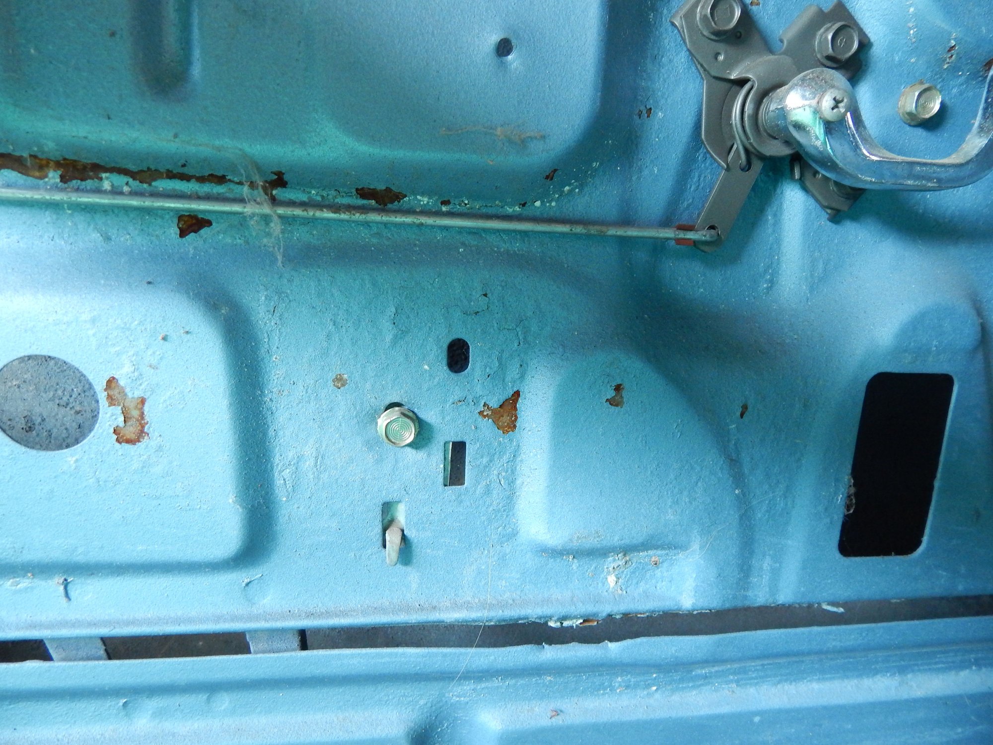

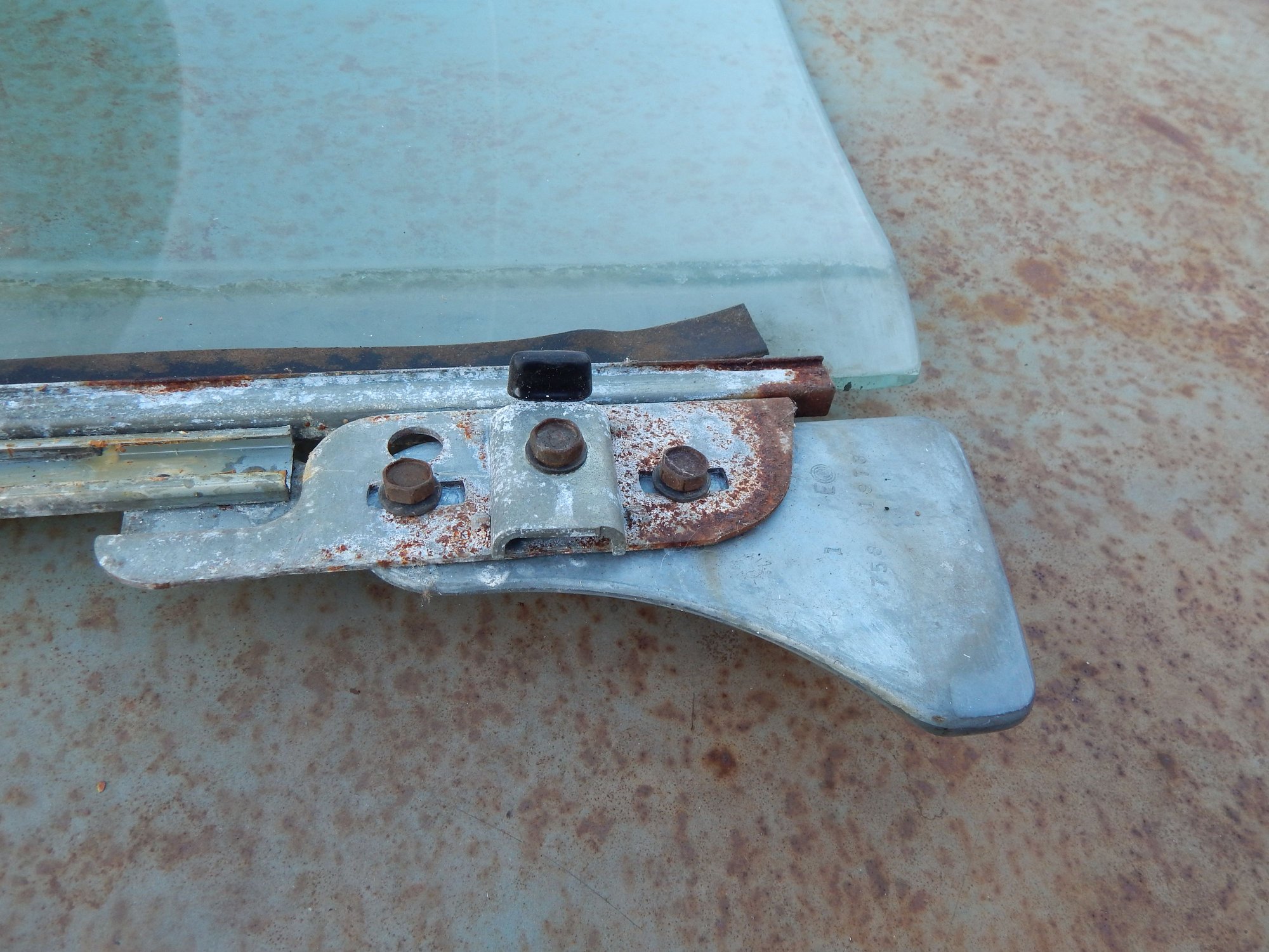

OK, I think this is what you described. This glass is loose, but I checked one inside a door and it also has one facing one way then the other facing the other side. Let me know if this covers what you needed. John

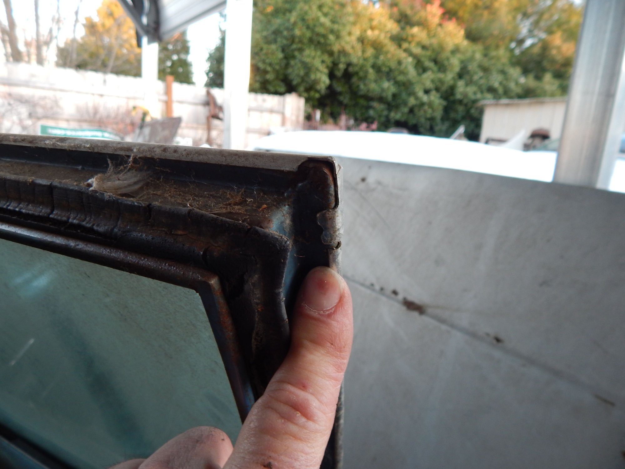

Here's some pictures of a 1964 F85 wagon. I believe your trim would be like this. If you do want to remove it, look for the tabs to straighten and gently work it off. I'd use something soft against it like a piece of wood and a hammer to tap it off.

100% perfection on the glass, thanks a bunch!!
