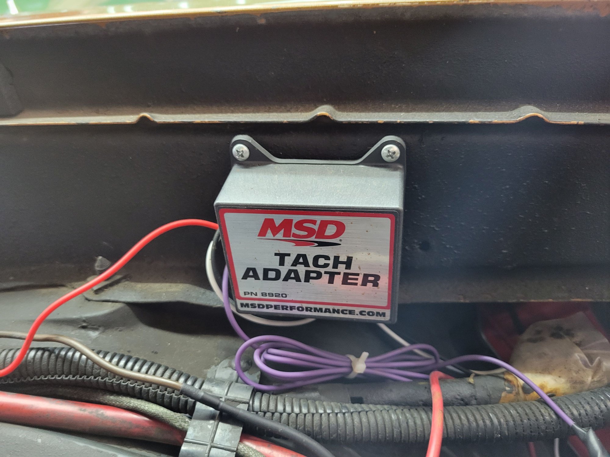

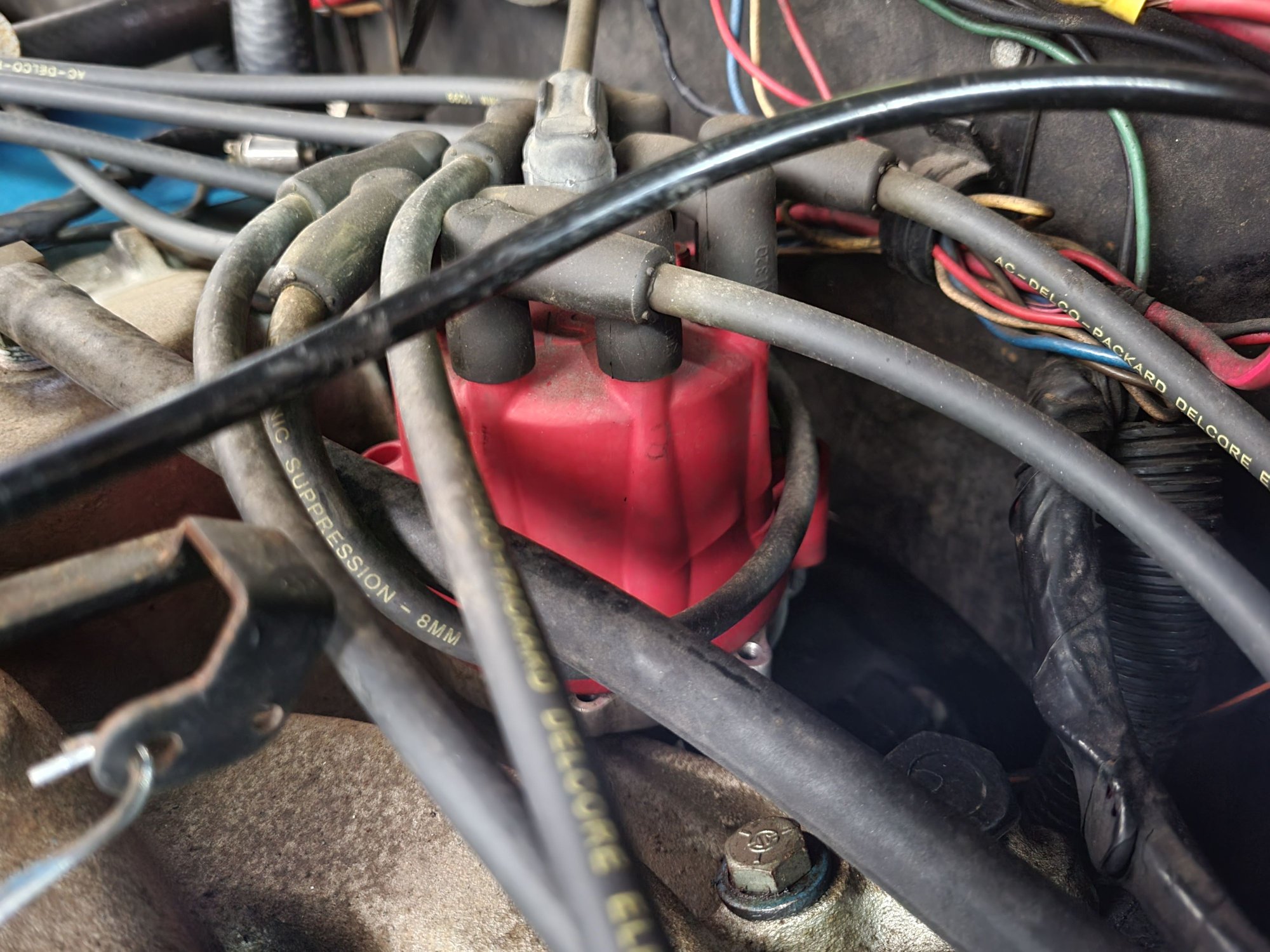

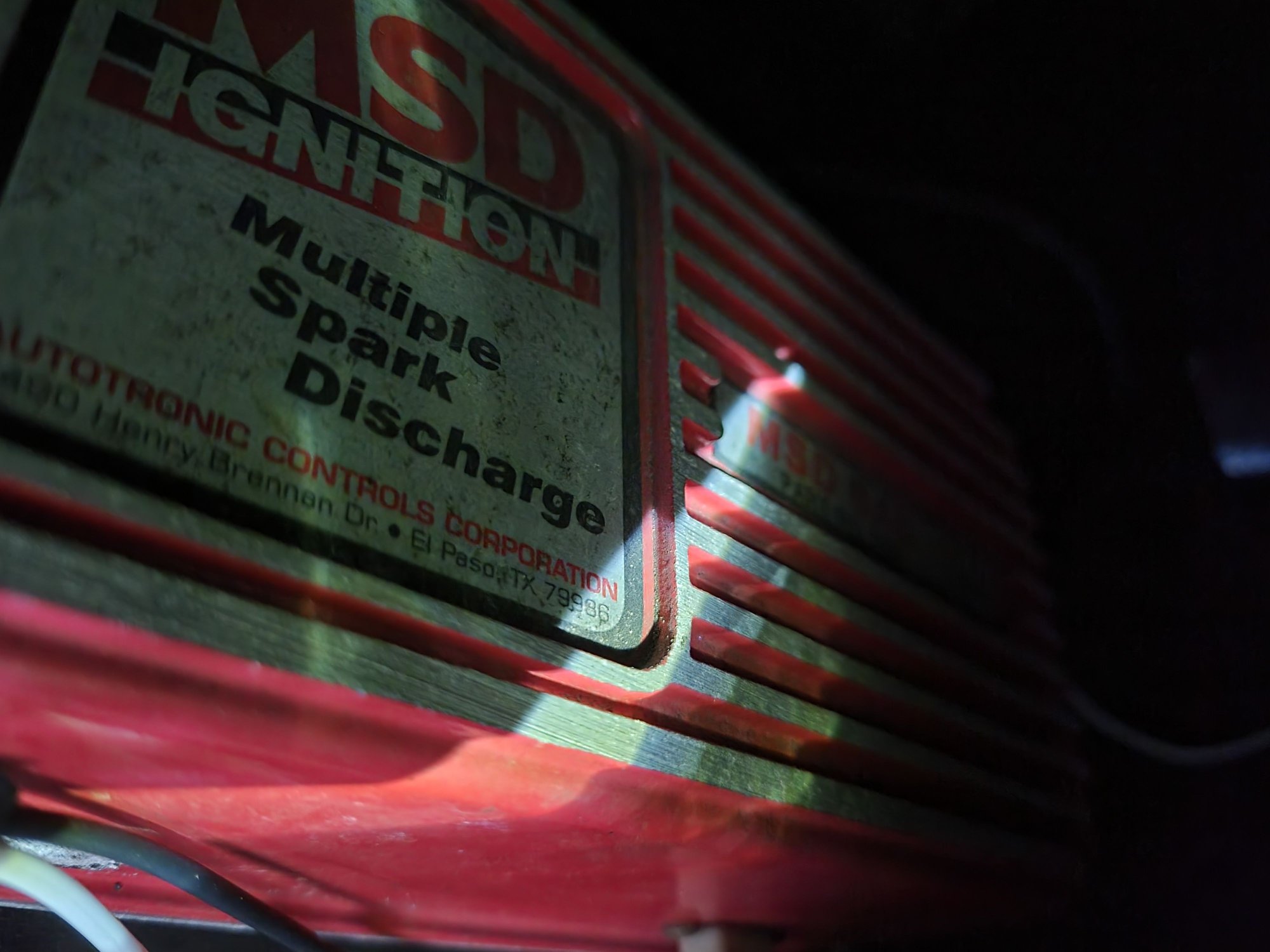

Do I need the 6AL box and tach box to run this distributor? This wiring is atrocious and I want it all to go away without replacing the distributor if I don't have to.

if you have one of their 3-wire Ready To Run distributors (such as the p/n 8529 for SBO) then no - you don't need the 6AL, and possibly not the tach adapter either depending on the tach itself - you need to provide more details as to what it's all wired to for any more real potential help though.

That's part of the problem, I have no idea. Can't see any part number on the distributor and it looks like a 1st grader wired it up. Running the factory tach.

you probably wouldn't have an issue running the factory tach off an MSD Ready to Run distributor - they're a simple 3-wire hookup essentially same as a factory unit, albeit it's electronic inside. Google the 8529 so you can see what it looks like inside and out - then take your distributor cap off to see if it looks about the same = that may help you a bit.

See if you can locate the wires coming out of the distributor base. If there's only 2, then you need the box(es). If there are 3, it may be ready to run or e-curve. If it's a 2, pro billet, i need a good, used base.
The wiring is pretty simple; if just needs cleaned up. Is the car a G-body, 82-88? I've only seen the tach adapter on those. If not, they may not have hooked the tach up correctly. It should be right on the side of the 6 box. The instructions are online; try Summit.

2 wires, purple/black and orange/black.

That's a pro billet. I'll buy it from you.
To replace, you need an HEI unit or poins distributor and coil setup. That's personal preference and/or year requirements for OCA shows.

I have run the factory Rally Pac tach with the MSD 6AL with no problems. No need for the tach adapter.

Where is the ignition box mounted? If you take the time to do it right, it’s pretty easy to have the box and keep the wiring neat and tidy. The problem is most hacks either are to lazy or impatient to do it neatly.

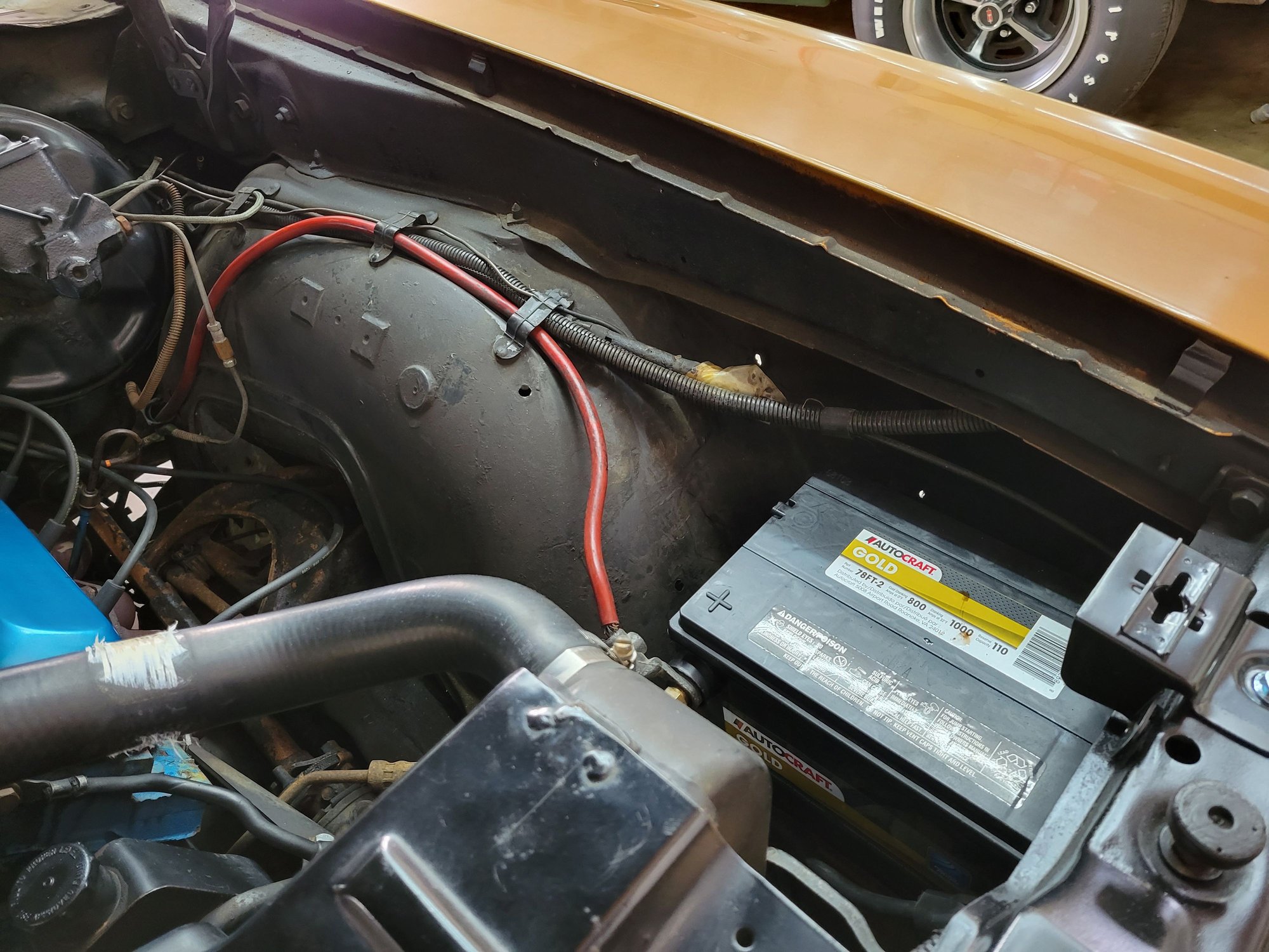

Right now it's up under the fender by the battery. I just want a clean, original look and I think all of the MSD parts are unnecessary. This is no race car and I honestly can't believe the MSD system is a huge improvement in this application.

The rev limiter is a nice feature, and longer ignition point life is a added bonus (not that it matters in your case) but I agree, for 99% of the people who just drive the cars, the aftermarket ignition isn’t needed.

Better already. Now to degrease and power wash. Even found the original battery hold down under the battery. 🙄

if you dont know a vacuum reservoir attaches to the two holes in the firewall just left of the voltage regulator

Thought that was A/C cars only? This is a non-air car.

hmm i dont know that. The holes in your firewall have definitely been used tho

That's where they drilled holes for the coil.

Why wouldn’t they have used the factory coil mounting bracket? Guess they wanted to show off their newly purchased go fast parts?
