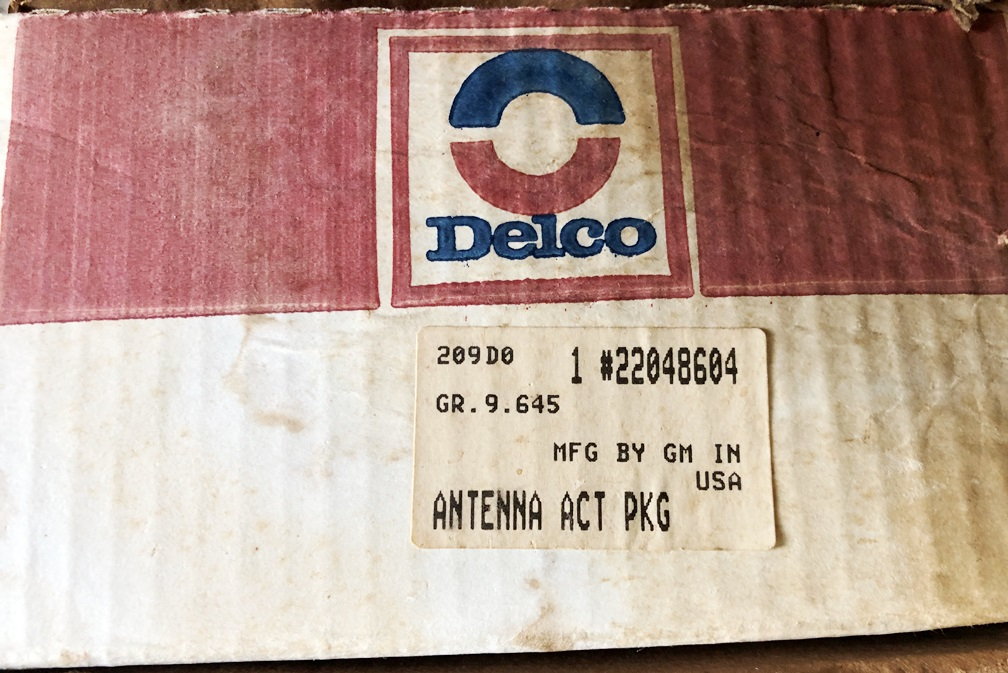

If you can find a new one, it's under part number 22048604. They have supersession numbers as well, but those antennae were not like the original style. This was the last of the good ones. However, even NOS you will likely run into nylon cable breakage.
I did a steel cable replacement for an NOS one I had for my 85 442 in June of '23. The cable was already broken when I took it apart. People can buy all the nylon cords they want, I never trust them because if it operates long enough, it WILL break. Could last 5 minutes, or 5 years. Who knows. I'm not taking that chance. The steel cable eliminates that. So far so good with no issues.
