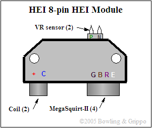

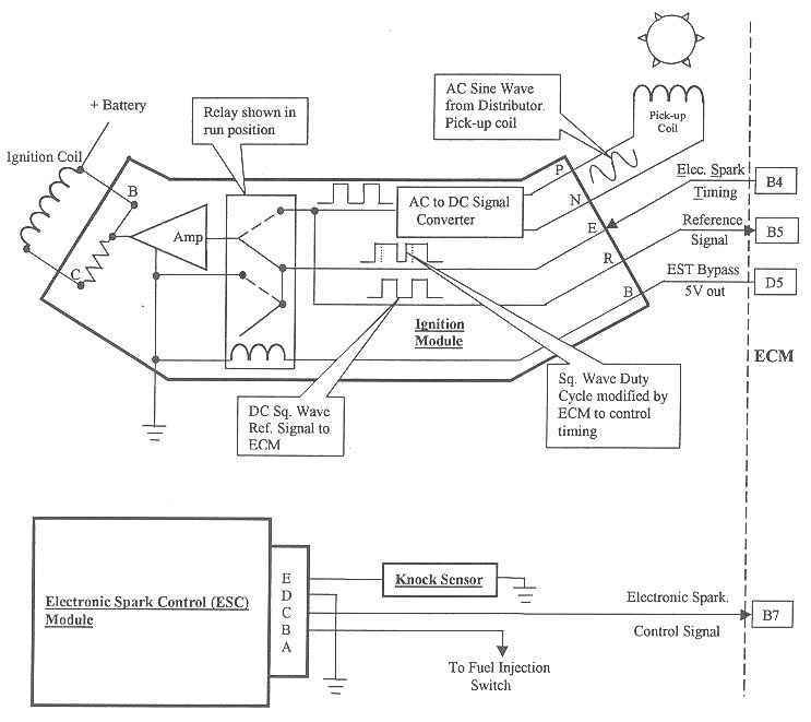

Here's more info on the GM distributor modules from the Megasquirt website. The small cap distributor uses the eight pin module (lower left), which is identical in function to the seven pin module used in the CCC distributor (upper right) except that the eighth pin is an extra ground.

Um, no. The Chevy distributor won't fit an Olds. The Chevy module won't fit an HEI body.
Get a CCC distributor from an Olds 307.
Here are the Chevy pinouts that mate to the Holley unit:
Here are the pinouts on the CCC module:
Note that except for the "G" terminal on the 8-pin module (the extra ground) the terminals are exactly the same. The +B and C terminals are the normal ones that go to the coil in the cap on the HEI. The P and N are the ones that go to the pickup coil inside the distributor. The E B R terminals are the three that connect to the ECU for timing sense and control. Just connect these three wires from the ECU to the CCC module instead of the Chevy module. You will want to get the correct CCC connector. If the ECU needs the extra ground wire, connect it to the distributor body or the ground terminal in the cap (the middle one in the row of three).
