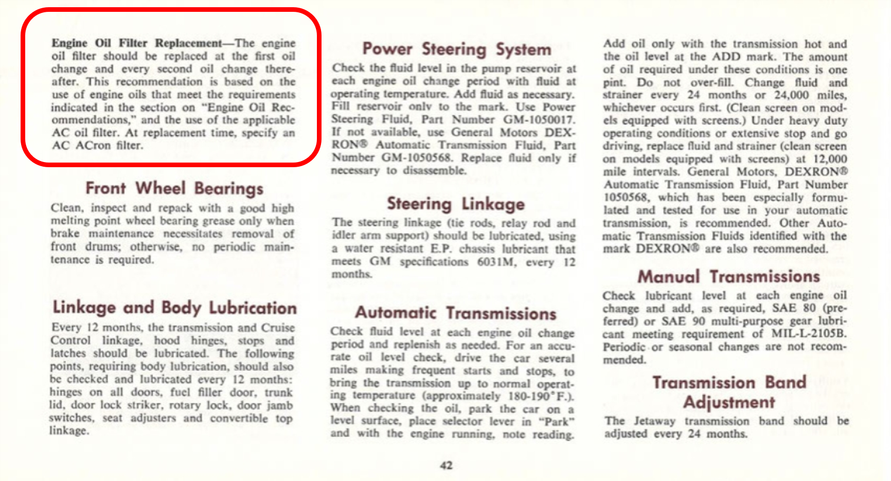

Years ago manufacturers recommended changing the filter with every other oil change. Not saying that was good but think about how much oil was left in the old filter.
I think you meant "NOT changing the filter with every oil change", but yeah. The recommendation was to change the filter with every OTHER oil change. Some sources suggested at least unscrewing the filter and dumping the old oil out, but given how much better filter media is today vs. in the 1960s, not changing the filter sounds even more ridiculous now.
From the 1969 owner's manual.

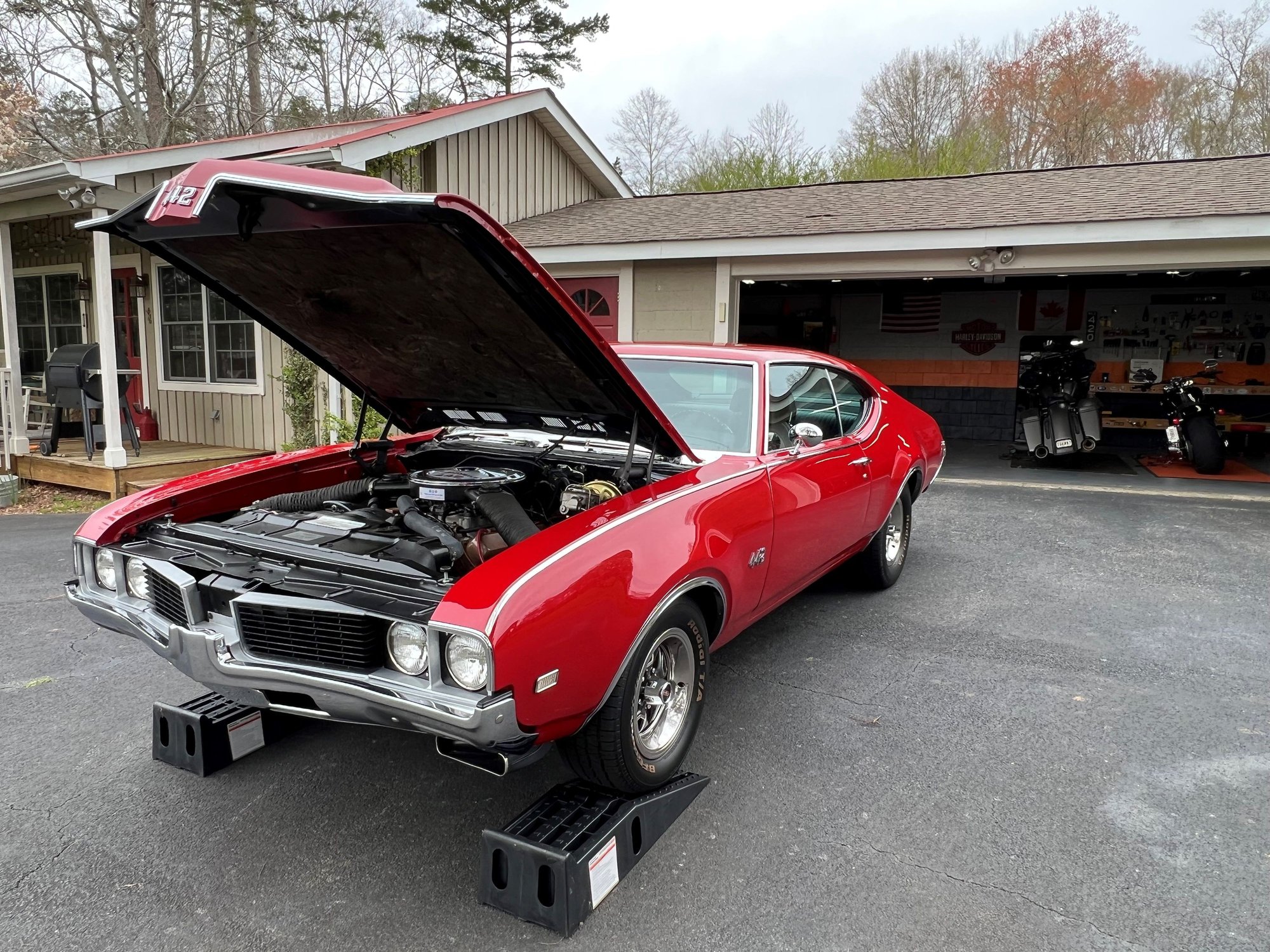

Thanks for all the replies. Forgot that my driveway does have a slight decline so I only had to drive a little onto the ramps to get enough clearance to reach the drain plug and filter.
Old Apr 3, 2022 | 11:04 AM
Posts: 42,495
You need to be fully on top of the ramps, they could have a tendency to shoot out like a squeezed banana and do you bodily harm in the position the car is parked in the picture.
