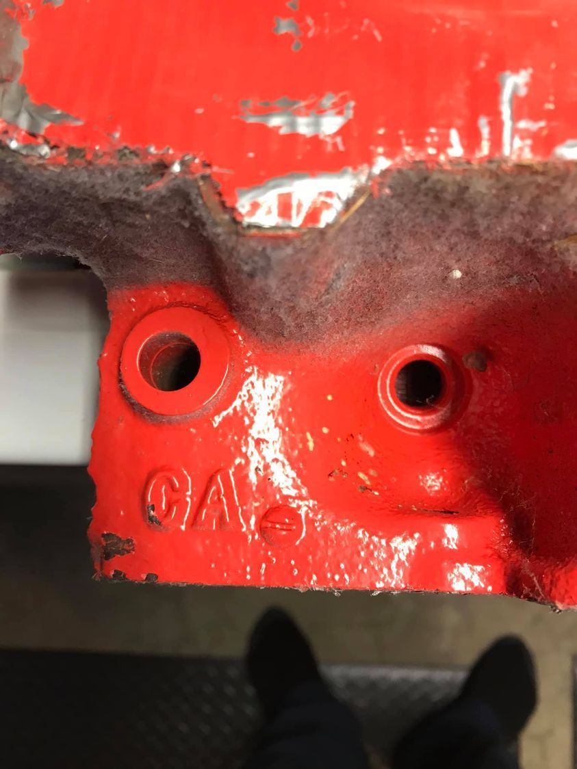

Interesting on the 3A heads. Those would have been 1967 heads, so this motor was assembled from parts. Those are decent heads also. I like the OL4B better than the Performer, but not as good as the Performer RPM. The RPM will be a little taller. I don't know that the downsized FWD cars have the same hood clearance problem as the early Toros. You will need to find the correct flexplate for a TH325 car with Olds motor, but that shouldn't be a problem, and that will bolt to any Olds 350 crank. The correct flexplate is available brand new under Pioneer P/N FRA146. There's at least one of those on ebay right now.
Sorry guys 7a

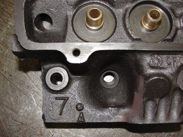

First I have heard of the 3 with the small A heads, must be rare like the 5 with the small A heads. Those might be the ticket for 79 HO and 80 442 owners.
Their 7a heads

Those would be 1972 heads, but yes, Olds did cast subscript "A" heads in prior years. While I have not seen 3A heads, I have seen CA and DA heads, in addition to CA and GA heads.
Old Apr 12, 2024 | 02:48 PM
  #45
Posts: 18,227
I've seen KA heads before. I don't recall if it was a big or little A. Here's a pic I found on the internet.

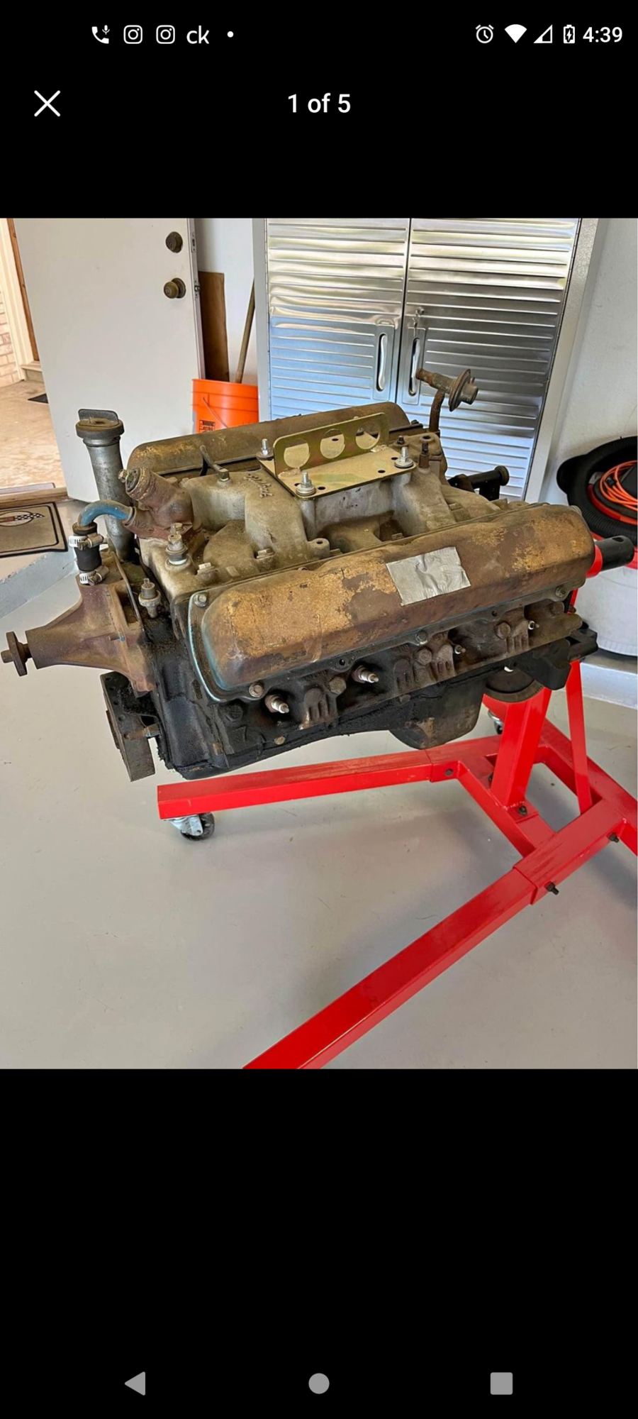

What #s am I looking at.. said 68 stock 350s had 300hp I think

Common, stock, 1968 350s were either 250 or 310 HP gross. And respectively 355 or 390 LB FT torque, gross.
A 1984 Eldorado HT4100 is 135 HP and 200 LB FT torque net.
Since the 350 you have is put together with random parts, the head swap changes compression and flow.... I would consider it 1972 spec, due to the heads being from 1972. So if healthy, 4BBL with dual exhaust, 200 HP and 300 LB FT net.

7A heads are 1972 issue.
Yes I know Joe but don't know what the cr or #s would be with a stock 68 motor with 7a heads would be I don't really want 300+ torque on that transmission... Tbh .. but I do have 3 transmissions.. the one imma use was in a restored car that was wrecked by a young guy who got it from a old guy who did alota work restoring it and putting everything new.. young guy had it for a few weeks in Houston and ppl drive crazy up there and hit him . (Luckily for me it was a H&E conversation which is super hard to find parts for)

...........don't know what the cr or #s would be with a stock 68 motor with 7a heads would be...........
'68-'70 used two different pistons to vary compression (three, if you count W-31); 8.5:1, 10.25:1 and 10.5:1. Add in the difference in factory head gasket compressed thickness (0.017") vs aftermarket (~0.042") and you have a lot of variables there.

The 68 to 72 heads have the same size combustion chambers so the heads won’t affect the compression ratio. As noted previously, it’s the piston dish that is different.

That is a 1972 motor with the correct 1972 heads. CR will be 8.5:1.
