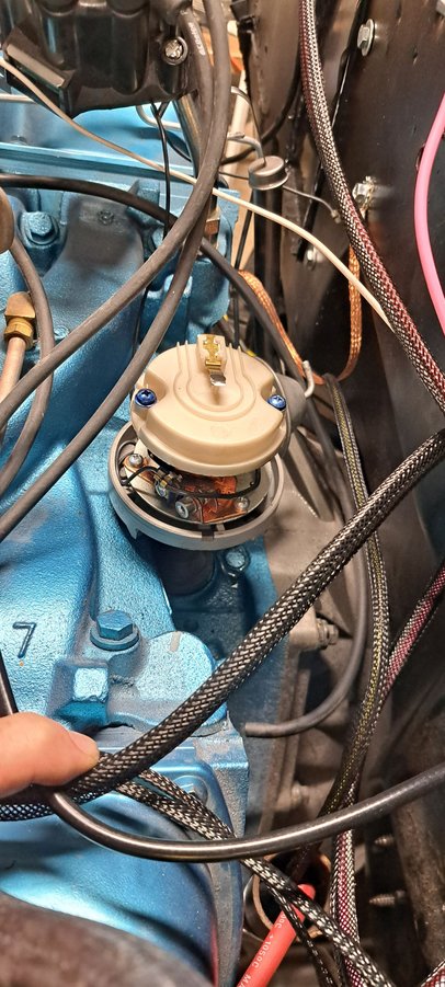

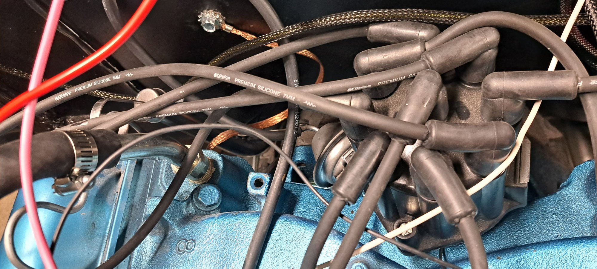

Is this distributor installed correctly?
Not sure how you could access the window on the cap to adjust the points
Also, it seems to wobble.
I would think having the distributor rebuilt and the engine professionally rebuilt and dynoed the wobble would be noticed.

Distributor housing is 180 degrees out.
It would run fine like that?
What's the easiest/foolproof way to remedy that?
Seems to be running strong

That things isn't moving around that's much. Leave it be. It will run just fine with housing 180 out. I've seen way more movement from a billet distributor.

As others have noted, Olds motors put the vacuum advance diaphragm on the passenger side, which then orients the window in the cap for easy access. You would need to re-clock the plug wires on the cap to match.

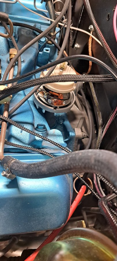

So it should be as simple as removing the distributor rotating the housing180 reinserting, and arranging the wires correctly?
If that fails go to the #1 TDC route. how do ensure you are at TDC on the compression stroke?

He's already found #1 since the engine is running. Just rotate the engine until the rotor is pointing to the #1 spark plug wire and line up the balancer with the timing mark. Then restab the distributor where you want it and wire accordingly.
You still need to look at the end of the shaft to see if it's bottoming out causing the wobble.

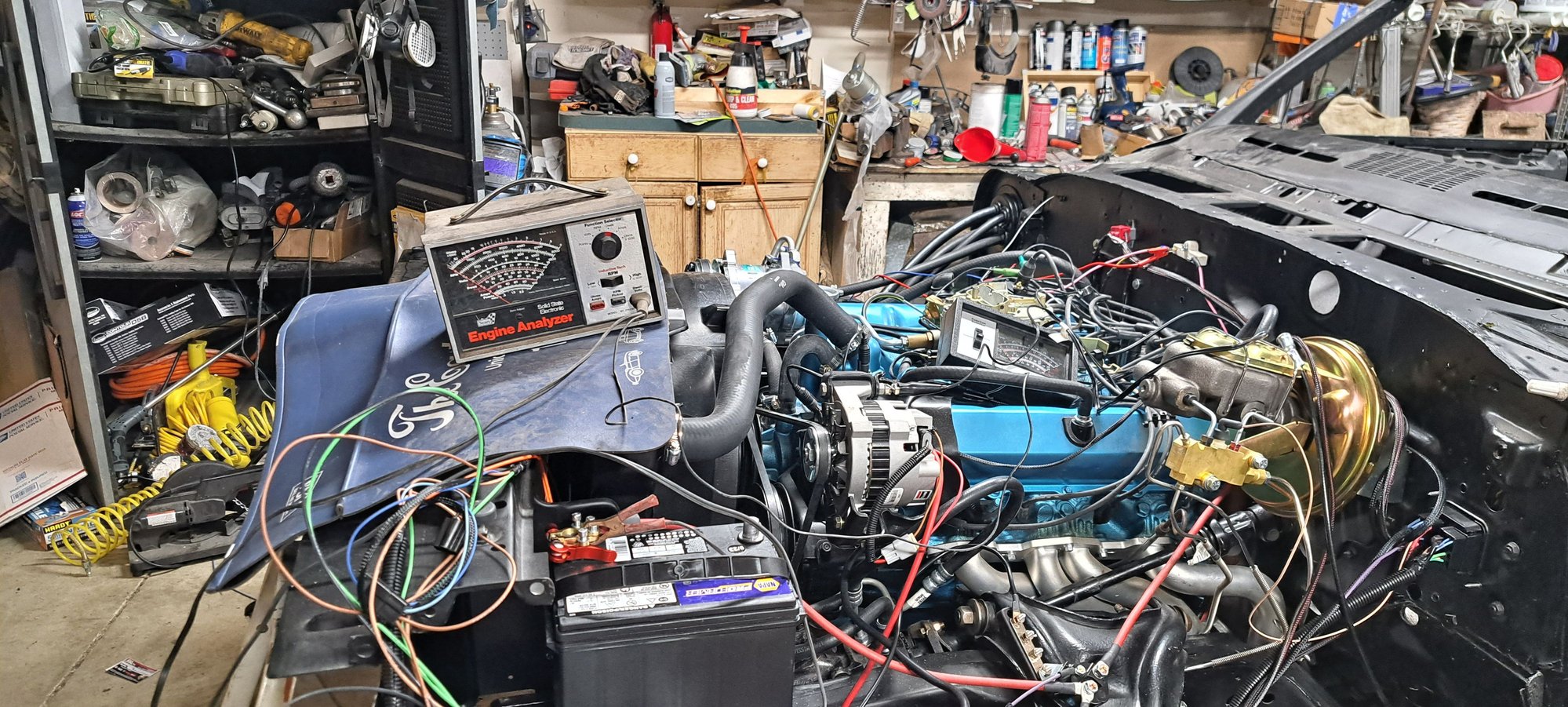

Took out my 50 yr old Sears remote starter switch and engine analyzer bumped the starter till my thumb made a farting noise when pressed against the spark plug hole.
Rotated the crank a tiny bit back to zero it out.
Looked like it was off by two teeth.
Pulled the dizzy rotated to #1 wire and reinserted.
Fired right up (after reinstalling #1 plug and wire)
The first of many dwell meters didn't seem to work so I just set the timing. probably a little advanced at around 14-15 btdc.
Pulled out my stash of meters and got 2 to show 37 dwell. Can't find my flexible hex key at least I can get at the window now that the dizzy orientation is correct.
Good time to go through my meters and timing lights to see what works or not.
So need to set dwell and redo the timing.

He's an oldtimer. He's got the super huuuuuge version of that sears analyzer.
Old Oct 30, 2023 | 01:10 PM
twilightblue28A's Avatar
Posts: 1,101
Analog or digital?? Lot of equipment displayed.
