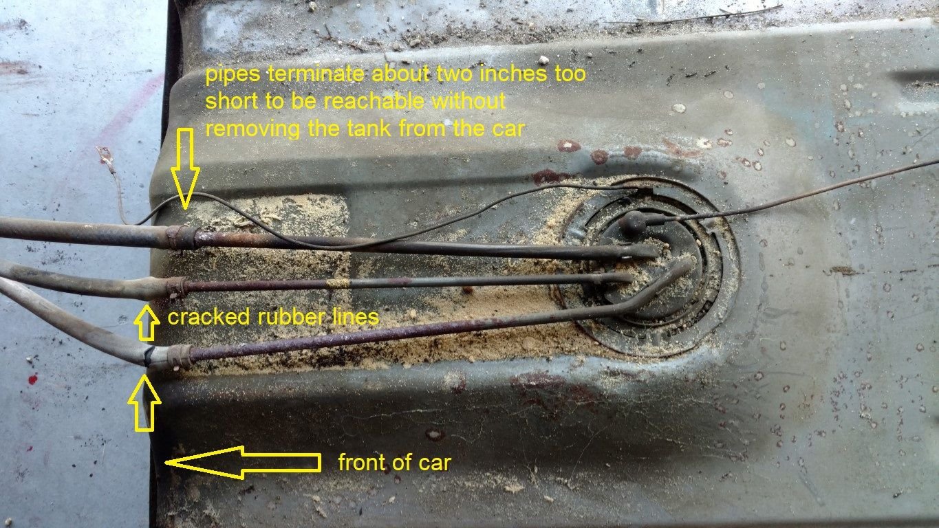

I have a '78 Toronado that was leaking fuel from the rubber line at the fuel tank. Here's some things you need to know.
The short rubber fuel lines connect from the steel hard lines that go the front of the car to the pipes coming off the sending unit, which is on top of the gas tank. On my Toro, and it's likely the case on your Delta 88 as well, the pipes coming off the sending unit do not extend beyond the front edge of the fuel tank. This means that you cannot detach the old lines from the sending unit pipes and attach the new lines without dropping the fuel tank from the car.
Here's is a photo of the top of my Toro's gas tank after I removed it from the car. See how the steel lines coming off the sending unit don't quite reach to the edge of the fuel tank let alone extend beyond it. There is no room here for you to get in there with the tools necessary to remove the old lines and attach the new ones.
Note also that all three rubber lines were hard and brittle, and I'm guessing the same will be true for the rubber lines on your car if they're original.

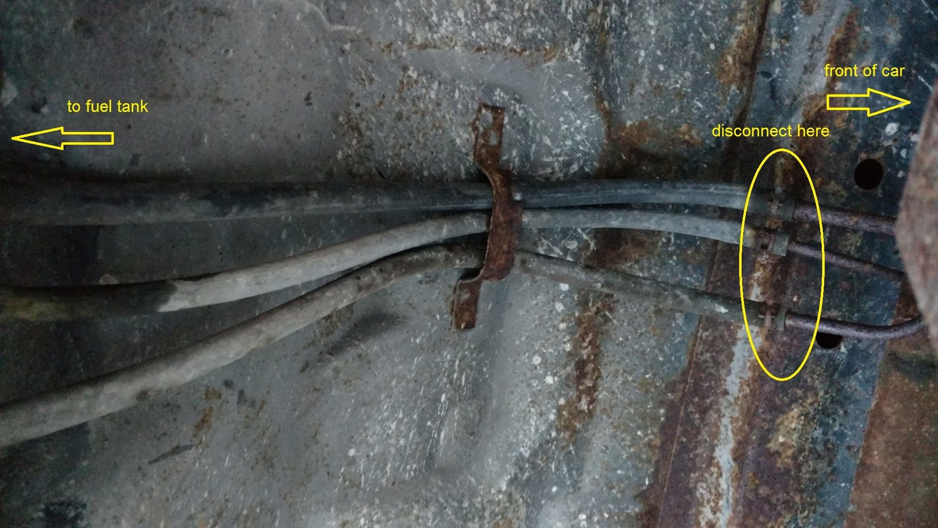

Here's a photo of where the other ends of those lines attach to the steel lines coming from the front of the car. Again, I'm guessing the situation is similar on your car. Since you can't get at the connection between the rubber lines and the sending unit, unless you want to just cut the old lines, you can disconnect the rubber lines at this end, pull them through that bracket, and the remove the tank from the car with the rubber lines still attached to the sending unit. This is what I did. Then you can unclip and remove the rubber lines from the sending unit and take them with you to the auto parts store to get the lengths and diameters you need. Note that the lines are not all the same diameter, so don't just assume you can go buy a 10-foot length of a certain diameter and then cut three 3-foot or whatever pieces out of it. Take the old lines with you and get exactly what you need.

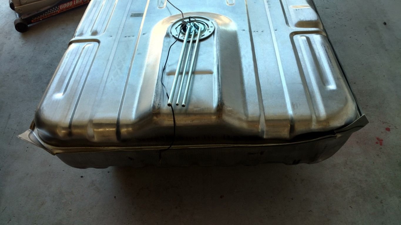

While you're at it, I strongly recommend that you replace the fuel tank sending unit at the same time. Removing the gas tank is a pain in the #$Q#$%, so you don't want to have to do it more times than necessary. New sending units are available for your car for under $60 from rockauto.com. Spectra Premium model FG10A. Buy one and put it in before you re-attach the tank.
Also, while you have it off the car, clean and inspect the tank itself. If it's questionable, replace it. New tanks are readily available for your car from rockauto and certainly other sources as well. You can probably get both a new sending unit and tank from any local auto parts store. You'll have to order them and wait a day or two for the parts to come into the store.
I replaced the fuel tank on my Toro as well, and here's a photo of the new tank with the new sending unit installed. Note the three pipes. Each is a different diameter.
That's not true. While it is definitely easier to drop the tank, I've been able to reach in that gap with a pair of pliers, squeeze the spring clamps, and slide them back. Slit the hoses as I noted and you can get them off. Dropping the tank unnecessarily pretty much guarantees that you'll break one of the clip nuts or tank strap bolts, and the collateral damage multiplies. It hurts nothing to try to disconnect the lines before dropping the tank.

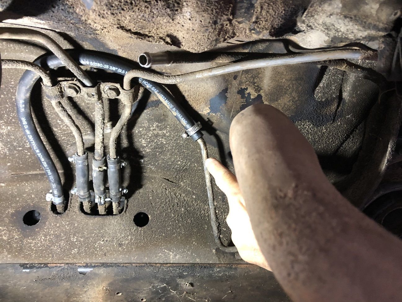

The fuel tank lines on my A-Body CS convertible which come off the fuel tank are nestled up in there pretty good - but they're manageable. I sliced through the rubber hoses as Joe did and cut the rubber fuel lines leaving the clamp and underlying rubber hose attached to each steel fuel line. Then, I used a long 11" pliers to reach each clamp - that worked great. It was pretty easy attaching the new rubber fuel hoses to the steel lines and the 11" pliers made short order of attaching the clamps.
