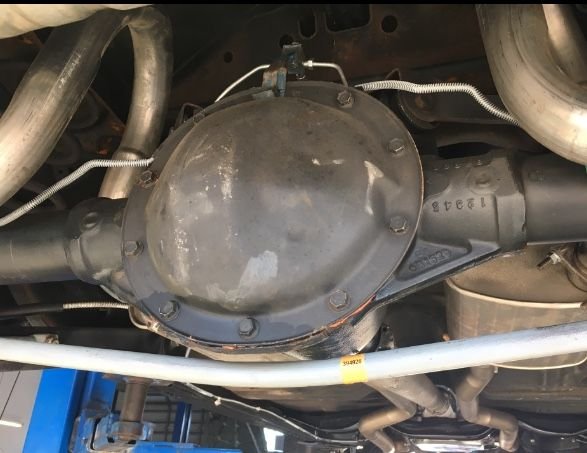

Wow I just looked at that second photo and the driveshaft looks awfully close to the one exhaust pipe, is that because it’s on a lift or is that trouble

IMHO that exhaust job looks like crap, and your driveshaft is way too close, I would have the pipes between the down pipes and the mufflers remade, crappy work.

That exhaust pipe is really close to the driveshaft. Look for shiny spots that would indicate rubbing; if there are some, it may be your issue.
The rearend doesn't look like a 71-72 Olds 10 bolt. Post pics of the sides of the center section for better identification.
All of the times when I had axle bearings failing, they made a rumbling vibration while driving. Your issue of a grinding only upon deceleration seems to be something other than axle bearings to me.
I would recommend you get that drivesahft to exhaust pipe clearance corrected and see if the noise goes away before doing anything else.

Here’s the best photo I could get of the driveshaft side of the rear. And oh yeah I have a small leak where the speedo cable comes into the trans and also a small power steering leak. Lots of warts.

To me it looks like the left exhaust pipe is hitting the driveshaft.

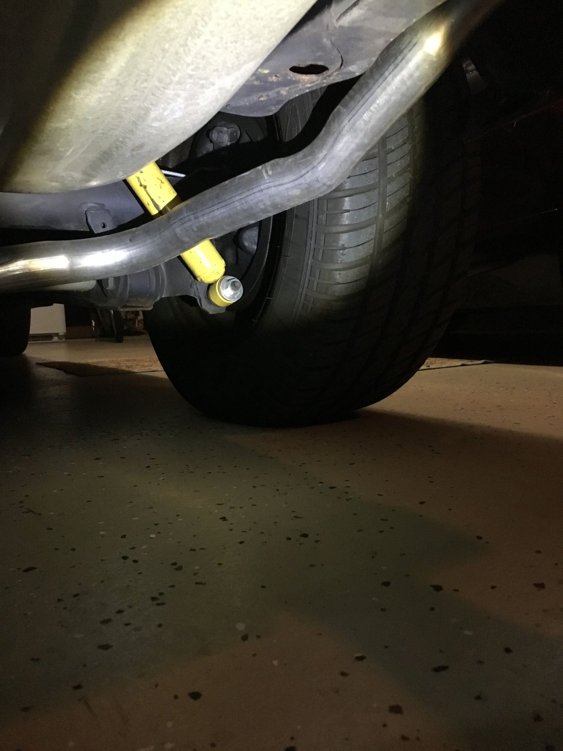

That first picture looks like the exhaust is rubbing on the shock'

I'm leaning towards a Chevy 8.2" 10 bolt, but that is just a guess.
- Two parallel ribs on side of center section.
- Brake line bracket attached to upper cover bolt.
Hopefully monzaz or someone with a lot more knowledge than I will post.

those black lines on the inside of your tire is oil being centrifically flung from brake fluid or axle grease ...
its not a 71 72 8.5 10 bolt

What about that scrape on the passenger side shock. Is the tailpipe contacting it? Those pipes look low and the angles are off a bit..to me.

Exhaust job mediocre at best, will redo first. As fun and dc2 initially point out, right rear shock rubs when on lift and too close for comfort when all four tires are planted.
Also noticed no rubbing on driveshaft but will fix as well. After that rear wheel bearings/ seals and rear brakes.

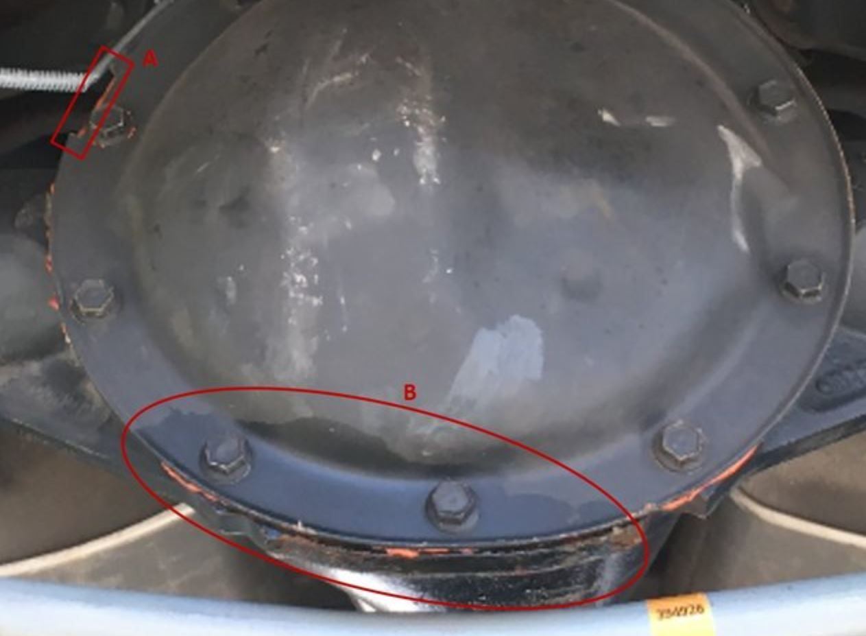

Tom- When you have the rear axle/wheel bearing(s) seal(s) evaluated, have them check the fluid level in the differential. Also, ask them to evaluate both item 'A' (broken missing edge) and 'B' oil deposit. As has been mentioned, the rear axle/differential is not OEM (probably not Oldsmobile, as well) and possibly a Chevrolet 8.2 - anyone's guess. None-the-less, the right time to evaluate items 'A' & 'B' (including differential fluid level) is when you take it in for rear axle/wheel bearing(s) & seal(s) inspection.
Better image (below).

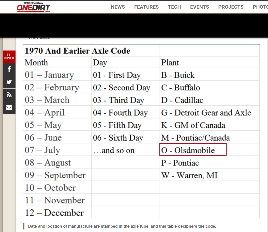

Posts: 15,411
I did some internet searching and apparently the Chevy 8.2" 10 bolt cover has that notch on the left side from the factory.
https://www.onedirt.com/tech/drivetrain/10-bolt-chevy/
Old Mar 10, 2020 | 04:22 PM
Posts: 26,066
Nice. Great catch, Ken.

Hi Ken, I read that article as well it’s very informative but I think the photo you posted is of the beefier 8.5 Chevy 10 bolt. Note the protrusions at the 5 and 7 o’clock positions on the carrier.
According to that site, all the emblems being sold are incorrectly spelled.
