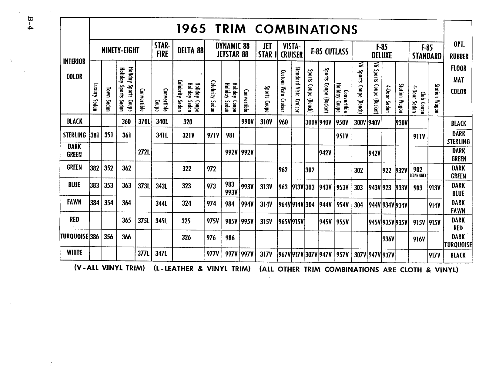

TR 088 doesn't exist in the trim table published in the factory parts book. Can you post a photo of the actual tag?

I should add that in the 1960s, the last digit of the trim code represented the color, and Olds was pretty consistent across the model years.
0 = black
1 = silver/pewter
2 = green
3 = blue
4 = gold/champagne/maize
5 = red/burgundy/garnet
6 = turquoise
7 = champagne (yes, this does duplicate "4")/white/ivory/parchment
8 = yellow/sandlewood/desert gold
9 = dubonet (toronado only)/saddle/sienna
The first digit typically tied to the model line.
0 = C-body and E-body cars (Ninety Eight and Toronado)
3 = B-body cars (Eighty Eights)
9 = A-body cars
This convention was used into 1972. A 1965 442 would have a trim code that started with "9". If it were a red, it would end with a "5". The middle digit would vary depending on bench or bucket and the specific body style.

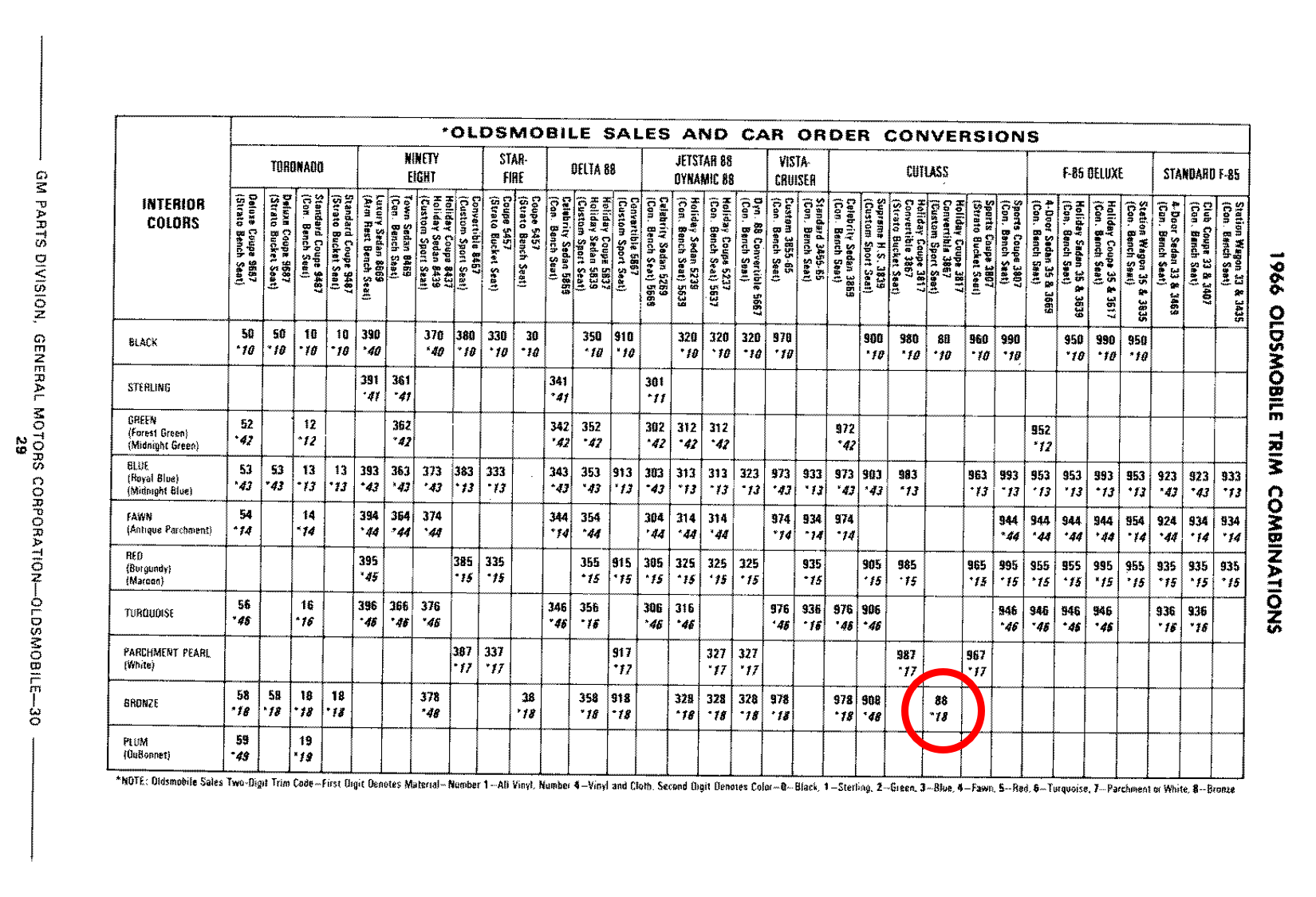

And that makes all the difference in the world. In 1966, your 088 trim code signifies a bronze interior with the custom sport bench seat (RPO A65). This is the bench seat with the armrest, and I suspect the "C" is "Custom Sport seat". The Custom Sport seat was the ONLY Olds A-body trim code that doesn't start with "9" .

Bronze, actually. What color is it now? No one offers replacement upholstery in the original bronze, so if it's been recovered, that's why it's a different color.
