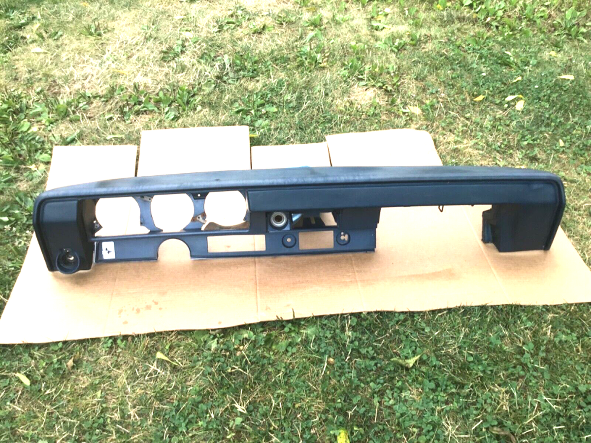

Cars with wing windows and no A/C got dash pads like this with no cut-outs for vents.

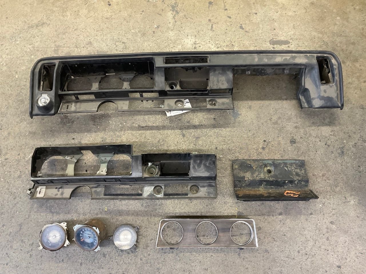

Wing window cars with A/C and all convertibles and 2 door hardtops got pads like this:
