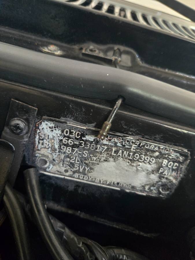

I found a listing on the internet I like the car then there's a picture of the cowl tag and it puts me off. what do you guys think, you belive I have nothing to worry about or walk away. Thanks

Not sure what "F" in Accessory Group 4 is??
Old Sep 14, 2024 | 06:27 AM
ACC Group 4F is outside remote mirror.
To the OP, the rivets look to be factory correct. Other than the ham-fisted scraping on the tag, what exactly worries you?

Agree with Joe on the rivets. Simple explanation- cowl tag had thick paint or even body schutz on it making it difficult to read so it got scraped to make it legible.

Yes it was just the scraping that made me feel uncomfortable, thanks to all who responded.
