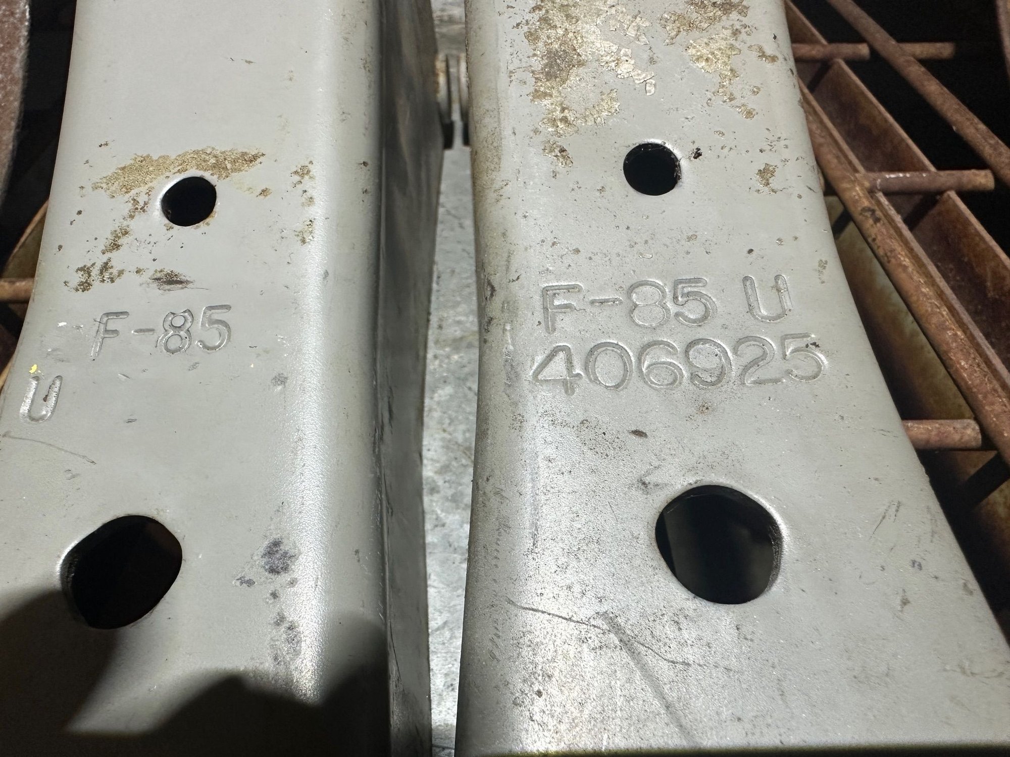

Which one of these 2 Jack hooks is correct for 1970 442 for “Concourse” restoration?
Left Hook is stamped ( F-85 ) on first line, then ( U ) on 2nd line
Right Hook is stamped ( F-85 U ) on first line, then ( 406925 ) on 2nd line.
Yes Yes, I know they both probably work the same but asking about correct concourse judging quality application

The lift to the right 406925 is correct for 1970 F-85 model cars. However, would not be concourse as the rubber pad is missing.

The lift to the right 406925 is correct for 1970 F-85 model cars. However, would not be concourse as the rubber pad is missing. You would also need the correct mast assembly and base.

My '70 442 has the hook on the left with the 'U.'
