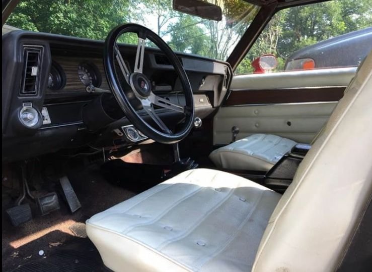

Hi Everyone - how can I tell if my 1971 Oldsmobile Cutlass S came with the 4 speed transmission from factory or if it was converted?
Thanks in advance.
Konrad

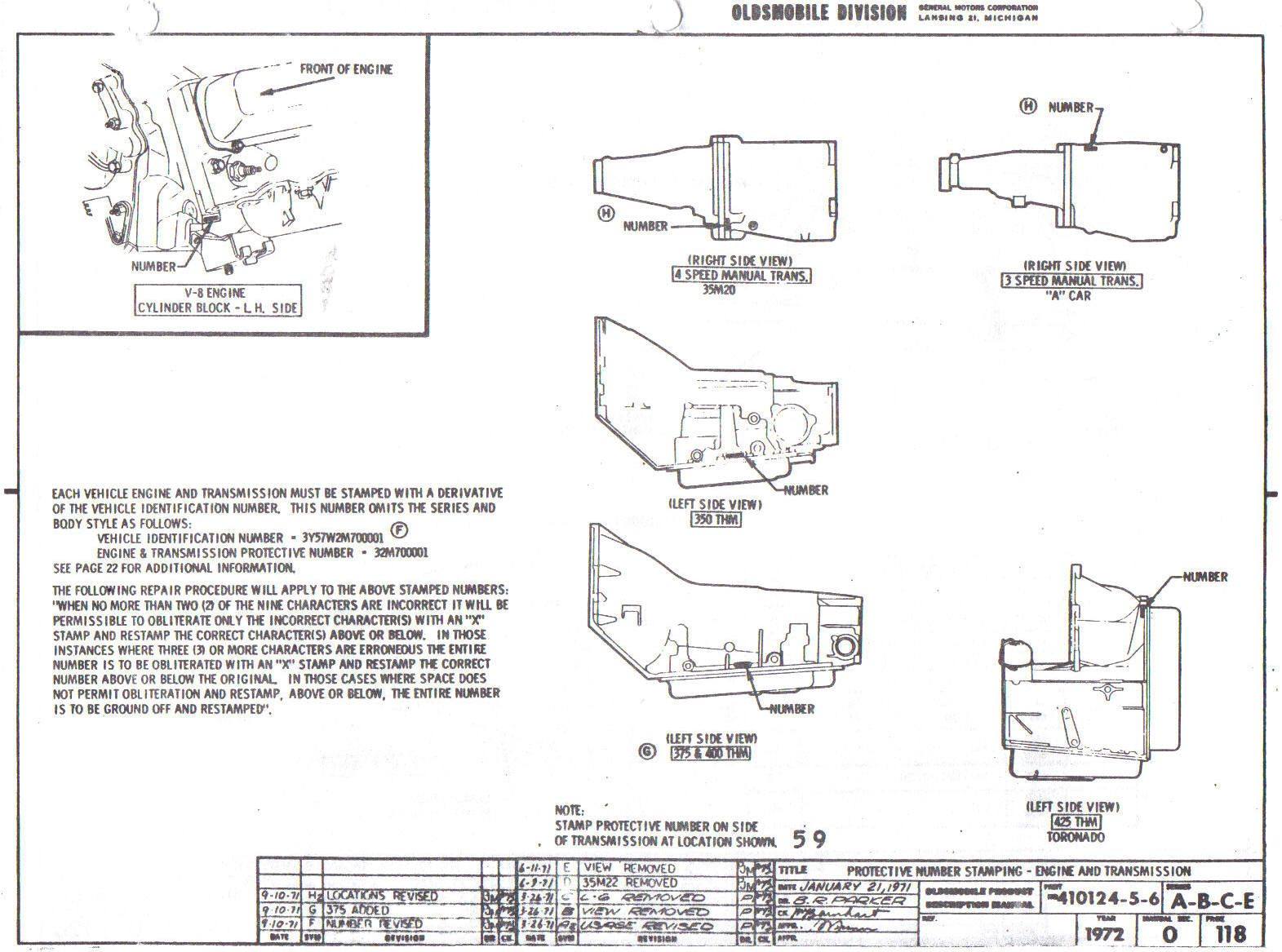

And of course, the easiest thing is to check the VIN derivative stamp on the trans. If it matches the VIN of the car, that's the best proof you'll ever get.

Hard to tell from pictures, as suggested above, shifter hole smoother or rough cut. No prn2l on dash under speedometer. The shifter boot on console is incorreclyt installed, think it was mounted underneath console.

Thank you all. I thought that there would be an indicator number, or letter, in the VIN, but I can't find any info on this.
I will check first to see if I can find the vin on the transmission and if not, to look further into what you've all mentioned.
To answer some of the questions V8al posted
- the speedometer does not have the auto trans indicators
- I can start the car without clutch depressed
- reverse lights do turn on in reverse
Again, the rest I will verify. It either is the factory 4 speed, or someone went into great lengths to make it look like the factory 4 speed.
The shifter boot on the console is definitely aftermaket, I was thinking because of the hurst shifter probably.
Is there a specific area on the transmission would I would find the VIN derivative stamp? Or is it random?

The VIN derivative stamp is located here:

The VIN on my factory 4speed car was stamped on top of trans..

Joe is right on the VIN number stamped on the transmission. A build sheet is also 100% rock solid.
