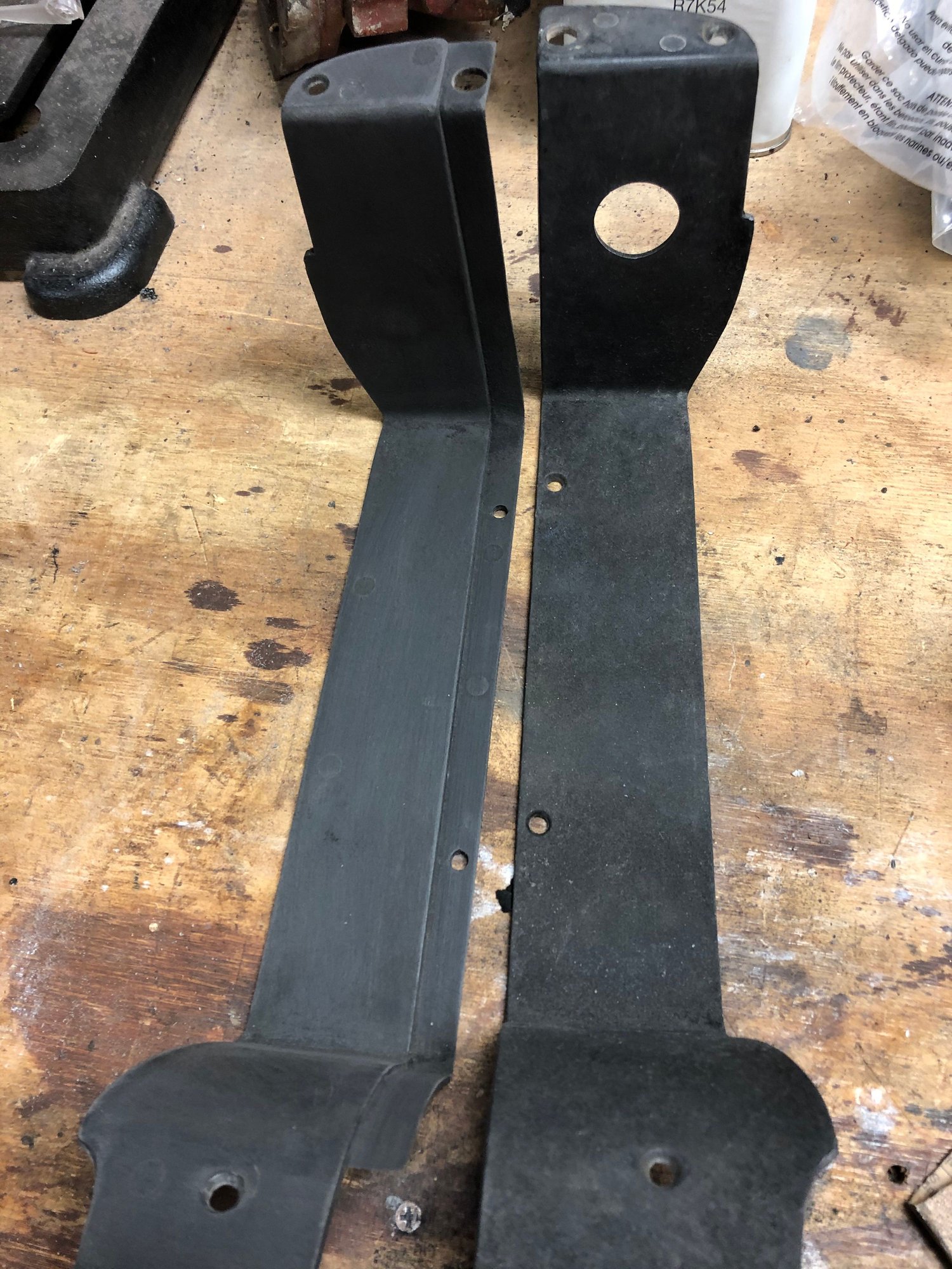

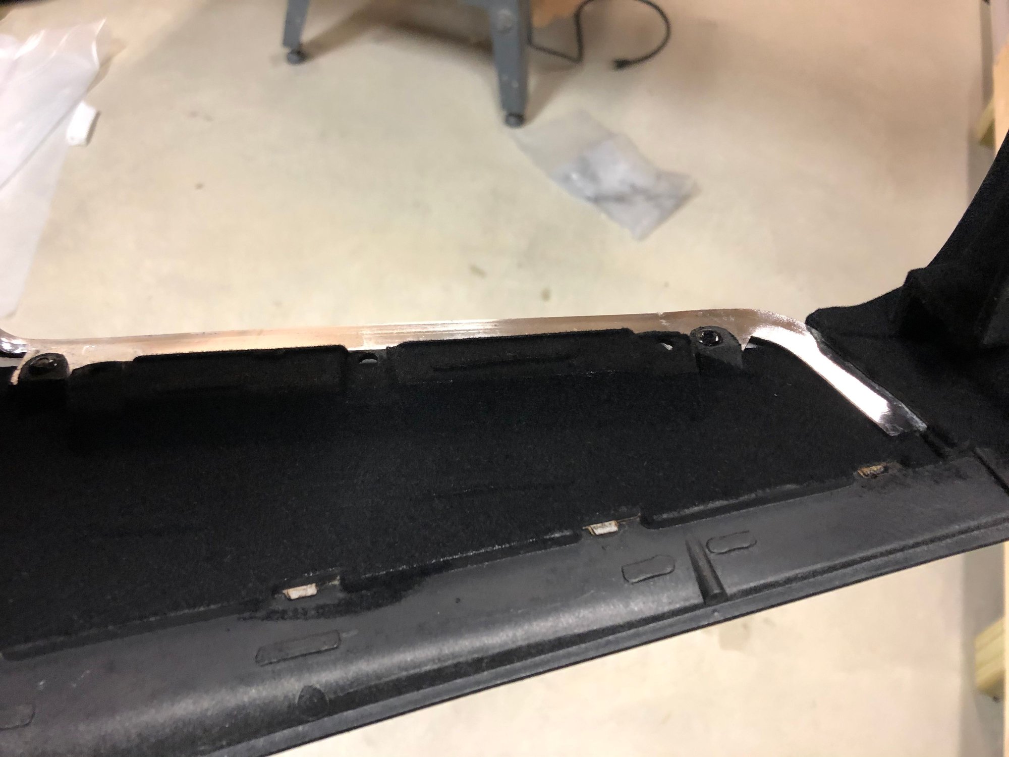

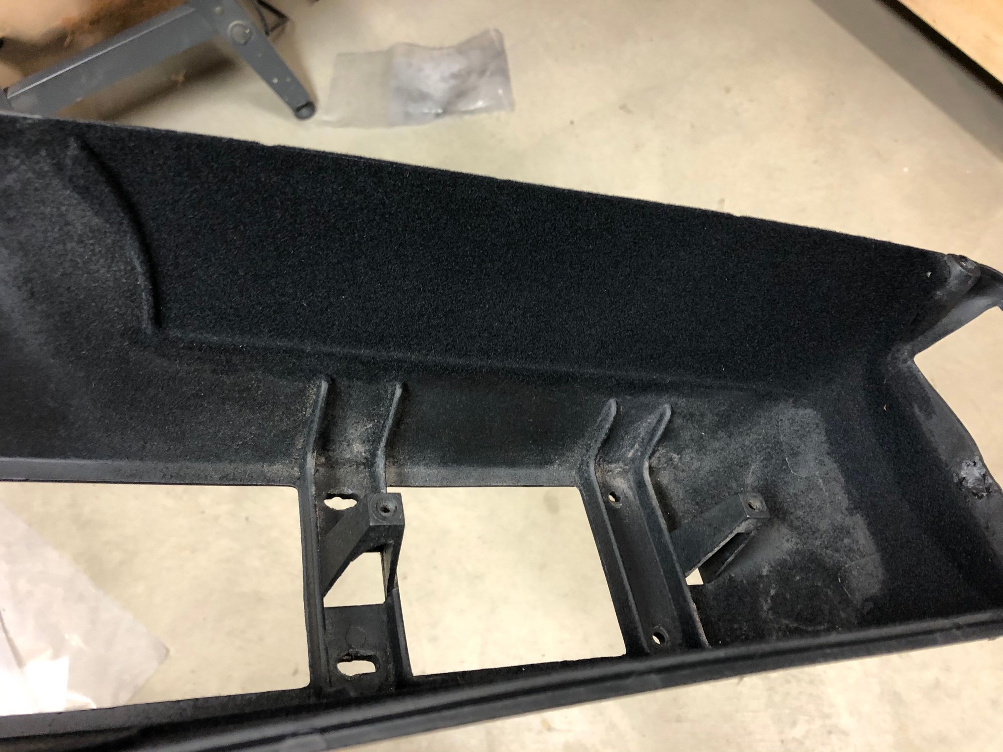

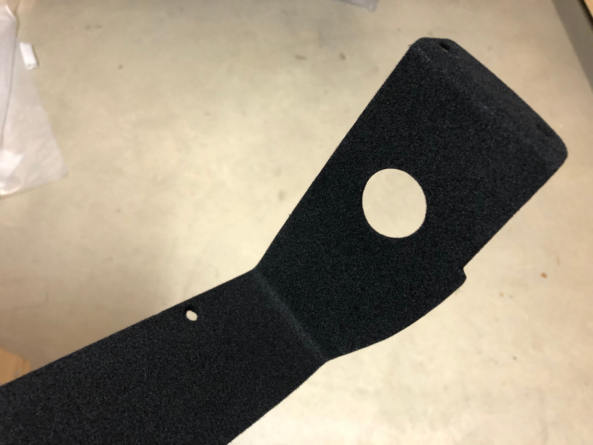

Thanks to everyone who has answered my questions on finishing my console, from the interior to the exterior. So far, so good! I didn't see anything here on how to flock the interior of the box, so I thought I would post up a how-to after doing my own and getting excellent results.
First you need to get the flocking, the paint/glue, and a flock application tool. There are many tools out there from $100 electrostatic to $6 cardboard tubes. I went cheap. There are quite a few kits for sale, but when I went looking, all were sold out. I was able to buy the bits separately. A 3-ounce bag of flocking was $13, and a pound was $16 - so I bought a pound. This is enough to do 425 Oldsmobile consoles, I'm sure. The half-pint of adhesive is way more than is needed for a console, but it's nice to have extra. I noted that there are tons of colors for flocking and all have their own color-matched glue/paint.
I didn't realize, but the inside of the console and the bottom two pieces were flocked at one time. I hit every surface lightly with 100-grit sandpaper and the old flocking came off completely, leaving a nice, clean surface. I wiped each one with denatured alcohol, but since the paint/glue is oil base, you can use any solvent you like, providing it doesn't melt the plastic.
Now is the time to fill the flocking tool with flock, before you apply the paint. You have 10-15 minutes to flock once the application is done. Get a dust/particle mask on for the flocking - you won't really see the fine fibers flying around, but they are. If you don't use a mask, you'll have some Kleenex surprises later.
Apply the paint/glue, brushing from the inside out, which gives an even coating all the way to the edges. Wipe the edges clean. Take the piece over to the application box (flocking instructions tell you how to make this) and set inside. Using the tube applicator - or whatever one you choose), apply the flocking GENEROUSLY over the surface, shooting it on at a 45 degree angle, from several angles of attack. When the piece is done, pick it up without knocking any excess off, and place it aside to dry. NO FANS! You can use a heat lamp, but make sure it doesn't melt your piece.
The paint/glue is sticky, so doing alternate sides at the same time is OK, as I did with the console base. I brushed the paint on the top, flocked, then flipped it over and brushed from the bottom to get the inside walls and glove box hinge area. Then I shot the flock on the opposite side.
After 24 hours, it is still not completely dry, but enough so that I knocked off a bit of the excess. Instructions say that it will be at least 72 hours for full adhesion and a week for full cure. I'll just leave these where they sit until I'm ready to reassemble.

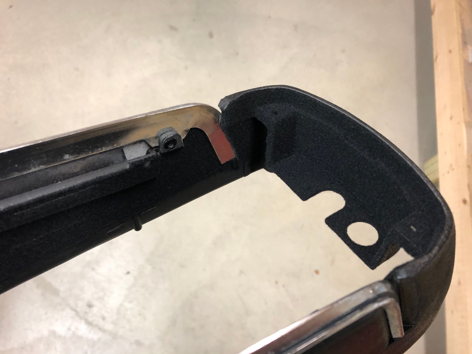

I forgot to post a pic of the final assembly... Very happy with the way this turned out.
