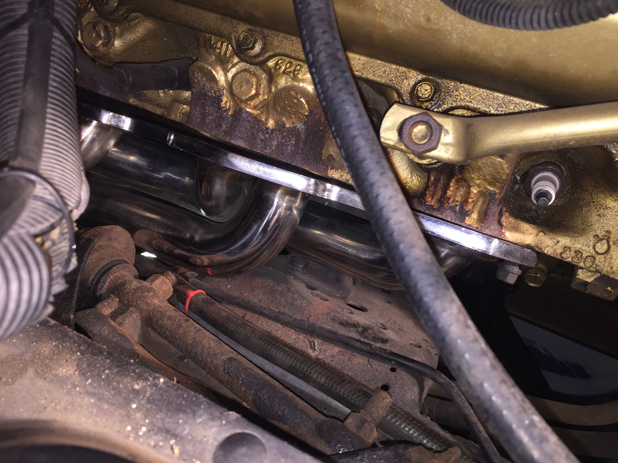

I have a set of the small block version I’m currently in the process of installing on my g body. I will attest to the comments on construction quality. They’ll be easier to install than it was to remove the old manifolds, but I may have to remove the steering shaft, not sure yet. I’ll have to relocate my O2 sensor to the start of the downpipe on the starboard side, no biggie. Brand new exhaust from the manifolds back. That rear bolt on the starboard side does seem to be a pain because of the tight curve of the tube; bolt must be inserted with the header off the car and then installed.
With them side by side, there’s no way they can’t pick up a little power over the stock manifolds. How much though is anyone’s guess.
Are you going with A body down pipes or custom exhaust? Did you have stock 442 exhaust before this?
