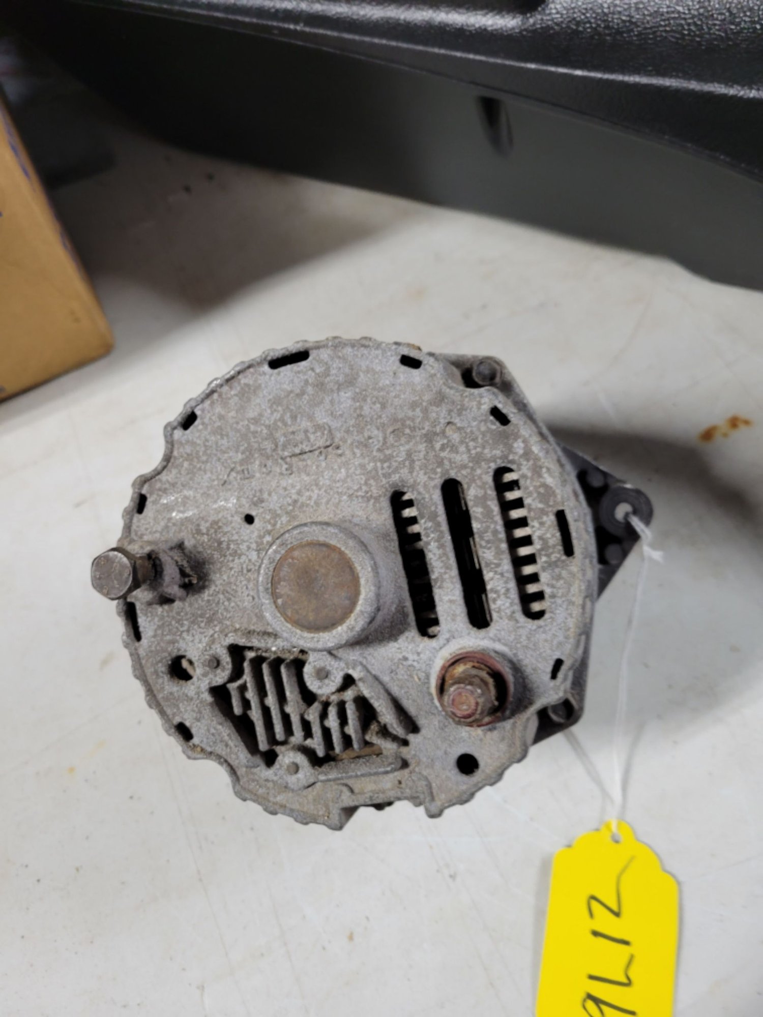

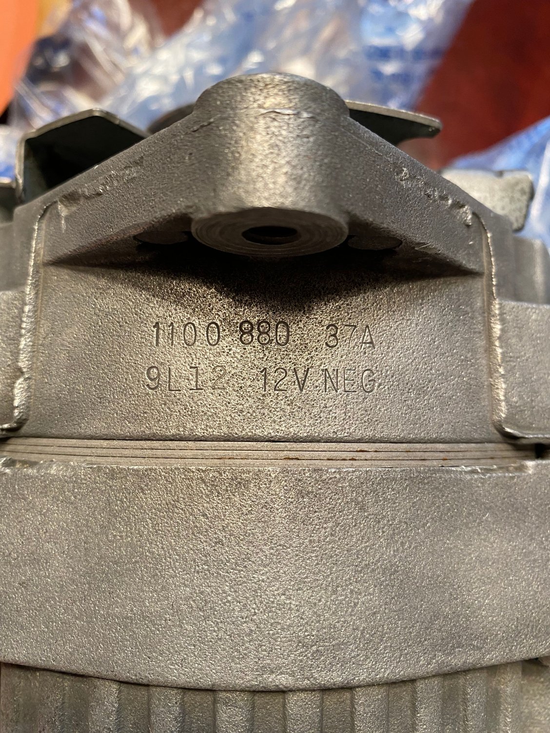

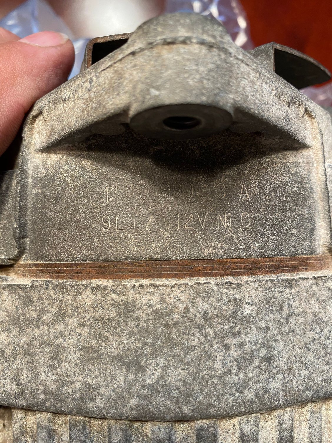

I’ve been assembling parts for my ‘70 W-30 for a while, and locating a correct 880 alternator was about the last thing to find. I located two, and one was in much worse shape than the other, so I figured why not see if I can clean it up? It came to me looking like it had been under water and then abandoned in the desert for 30 years. Full of mud and rocks, and mud dauber nests. Totally frozen. I dropped it in a bucket of Evaporust for two days.
Once it had soaked, I was able to get the shaft spinning easily, without force. It took a good hour under flowing water to clear the remaining dirt and rocks.

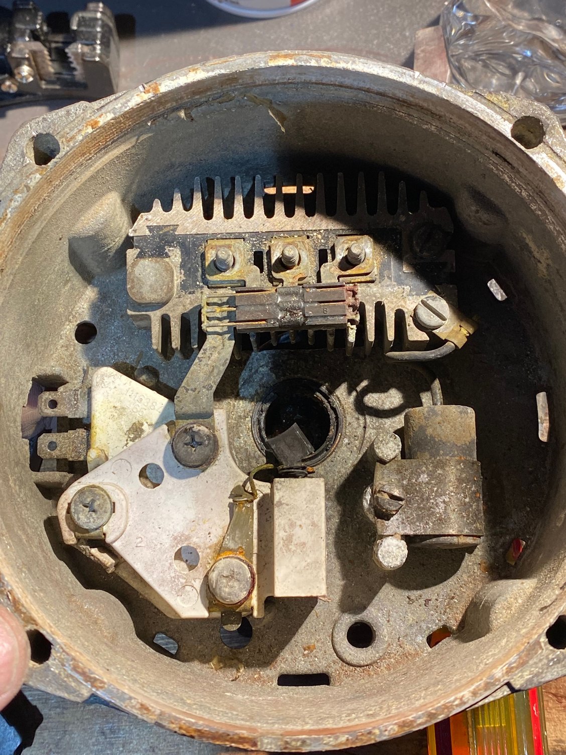

I carefully pulled it apart, using a trim remover tool so I wouldn’t damage the metal. Everything was stuck. And dirty.
I didn’t realize how simple these really were. I got the rebuild parts on eBay - rectifier, regulator, brushes, bearings, etc. About $25 all told.

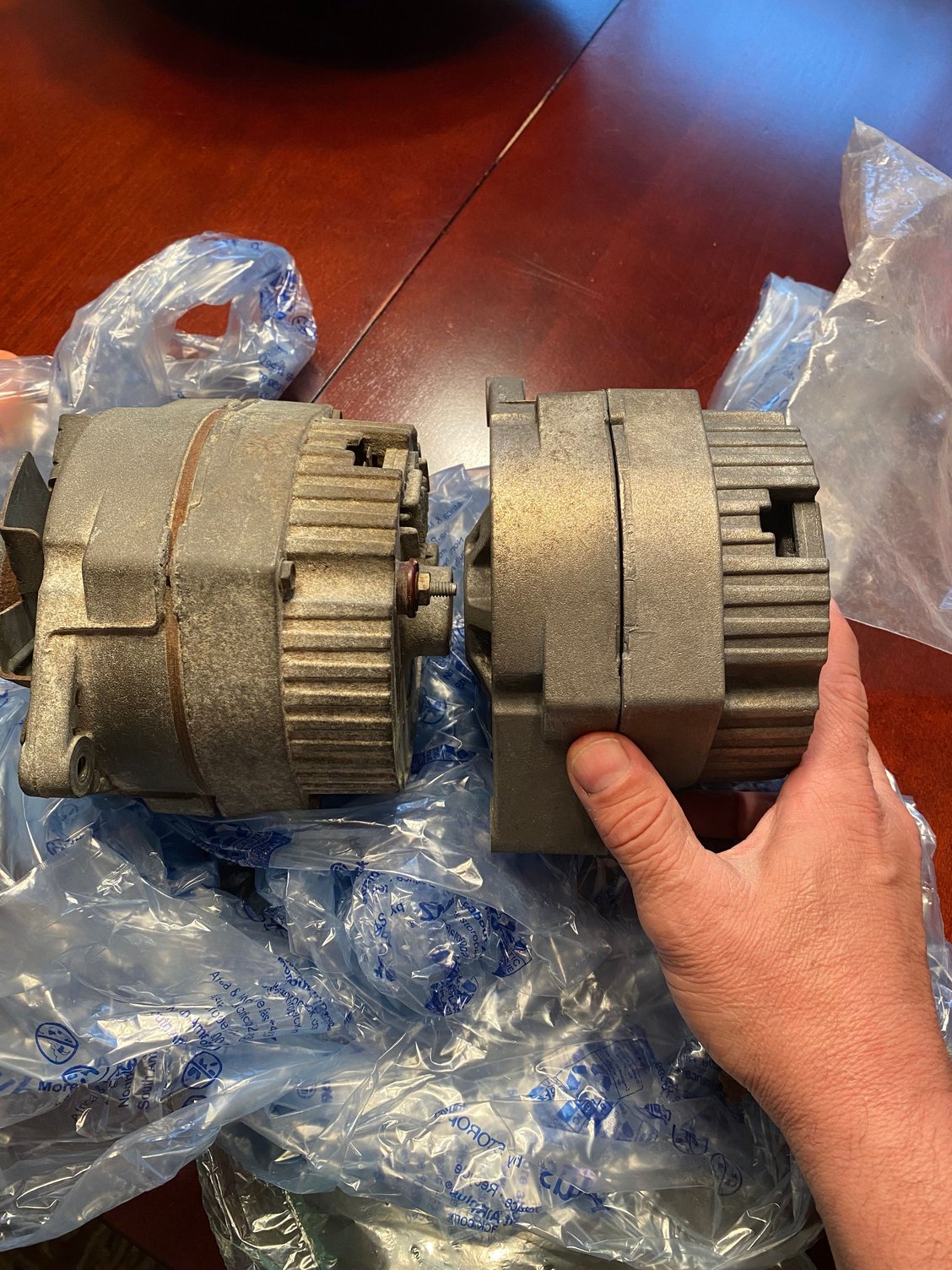

After cleaning - empty case on right, other unrestored alternator on left.

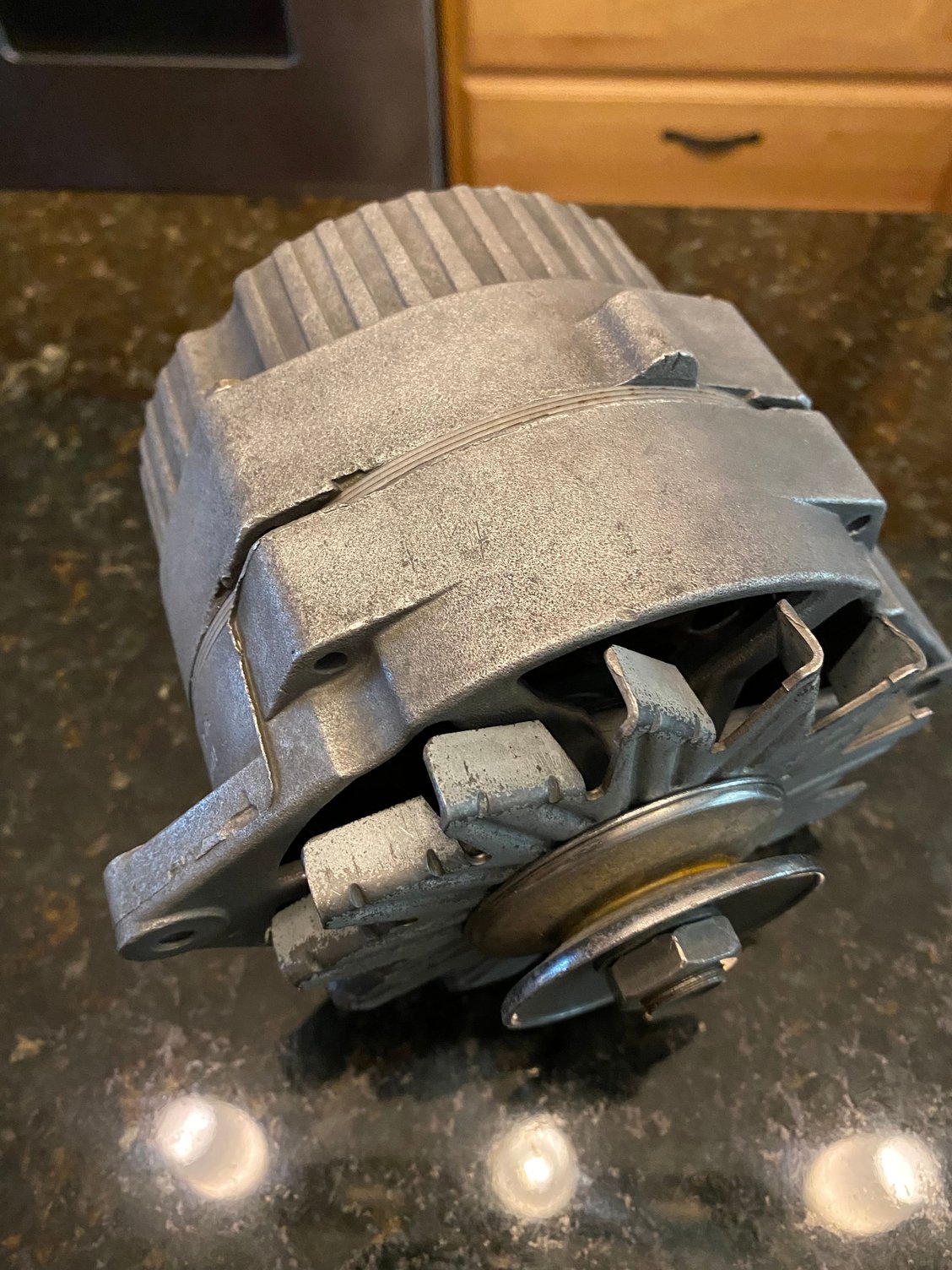

I did a full cleaning with Eagle 1 Mag Wheel cleaner, then wiped the case with lacquer thinner. Once dry I rubbed everything with NevrDull and wiped it down with a terry towel. Reassembled with the new parts, and I’m thrilled with the results. Tested fine at Autozone!
I was impressed that the original finish on the fan and the pulley was still there under the dirt.
From this:
…to this:
All I did was clean - and I’m sure I can get this even better when needed next year. Bottom line, don’t be scared of an alternator rebuild - kits are available everywhere and it’s super simple.
