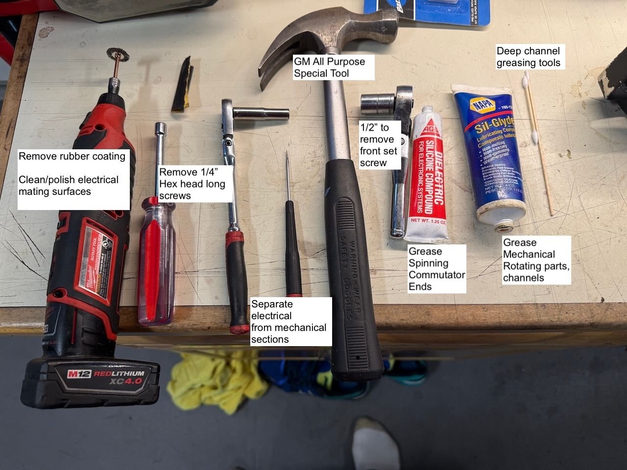

Before I start with the disassembly gore, this is a good time to review some tools that help:
Dremel, socket, BFH and grease. Typical restoration tools.
GM didn't seem to want anyone to service these motors. They are extremely well sealed. Dremel wire wheel on the left allows you grind off the goop and get at the screws to open the motor.

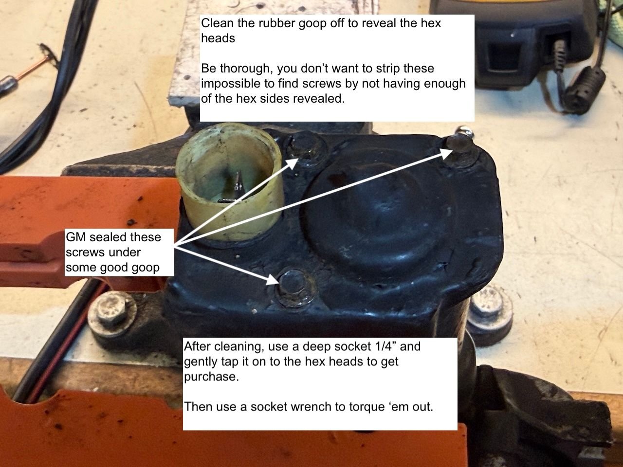

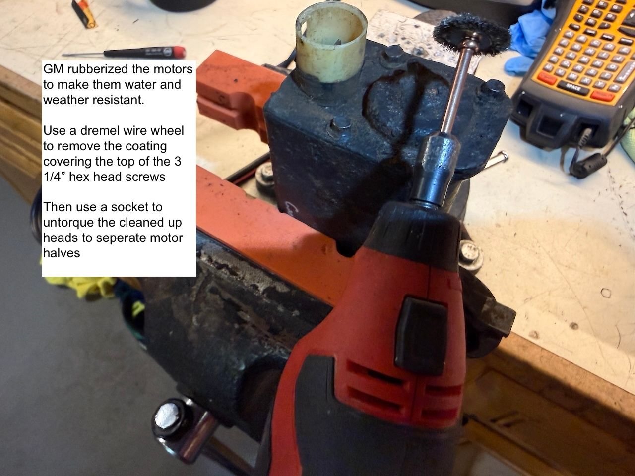

The first problem is getting the motor open. These windows live in a wet, weather-exposed environment in your doors and quaters, so Delco sealed them up very well.
So well that 60 years later it's a pain to open them. There is a set screw at the front of the motor and 3 1/4" hex head screws at the rear. Remove these and the 2 halves come apart.
Wire wheel only the flat side of the hex head. Don't round it off.

Assuming you've cleaned the sealant goop off the 3 long rear screws, you should see something like this:
A 1/4
A 1/4" deep socket and hammer tap to seat it helps remove the screws without rounding them off. They're tourqued pretty tight from Delco.

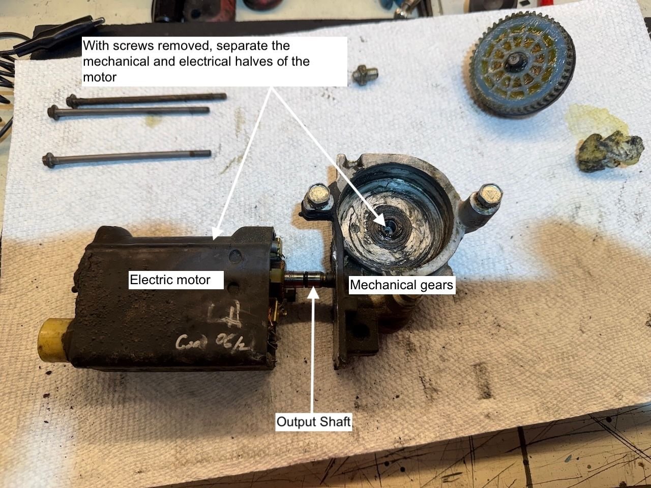

So now you can separate the electrical half from the mechanical half. The idea is to clean both and grease up any mechanical spinning mating surfaces for smooth operation. With the screws out, the two halves may need a little tiny screwdriver to pry through the sealant goop.
The electrical half will need cautious polishing. The mechanical half just needs cleaning & greasing.

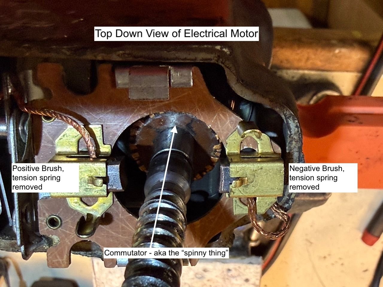

The basic job here is cleaning the collar of the commutator (a.k.a. the spinny thing) and the contoured surfaces of the motor brushes. I did that with my dremel with a wire wheel. The job is really just polishing the dust and grime off. I aimed at a shiny finish on the commentator collar and just lightly cleaned the edges of the brushes.
Looking down at the top of the electric motor, you'll get this view:
This photo is missing the springs that hold the brushes fast to the commutator, but this is what you'll see when you slip the mechanical half away from the electric motor.
To get the commutator out for cleaning & polishing you'll need to take the brush springs out (and store them safely....). Once the brushes are den-tensioned, you can slip the brush holder up by pulling on the side clips which hold it in place. When the brush housing is up a half inch or so, you can gently slip the brushes out of their brass housing. Be gentle, don't break the brush wires...
When the brushes are out of their housings and loose, you can slip the brush housing up over the end of the commutator using a high angle:
Slip the brush housing over the front end of the commutator. Then you can lift the spinny thing out for polishing & greasing.

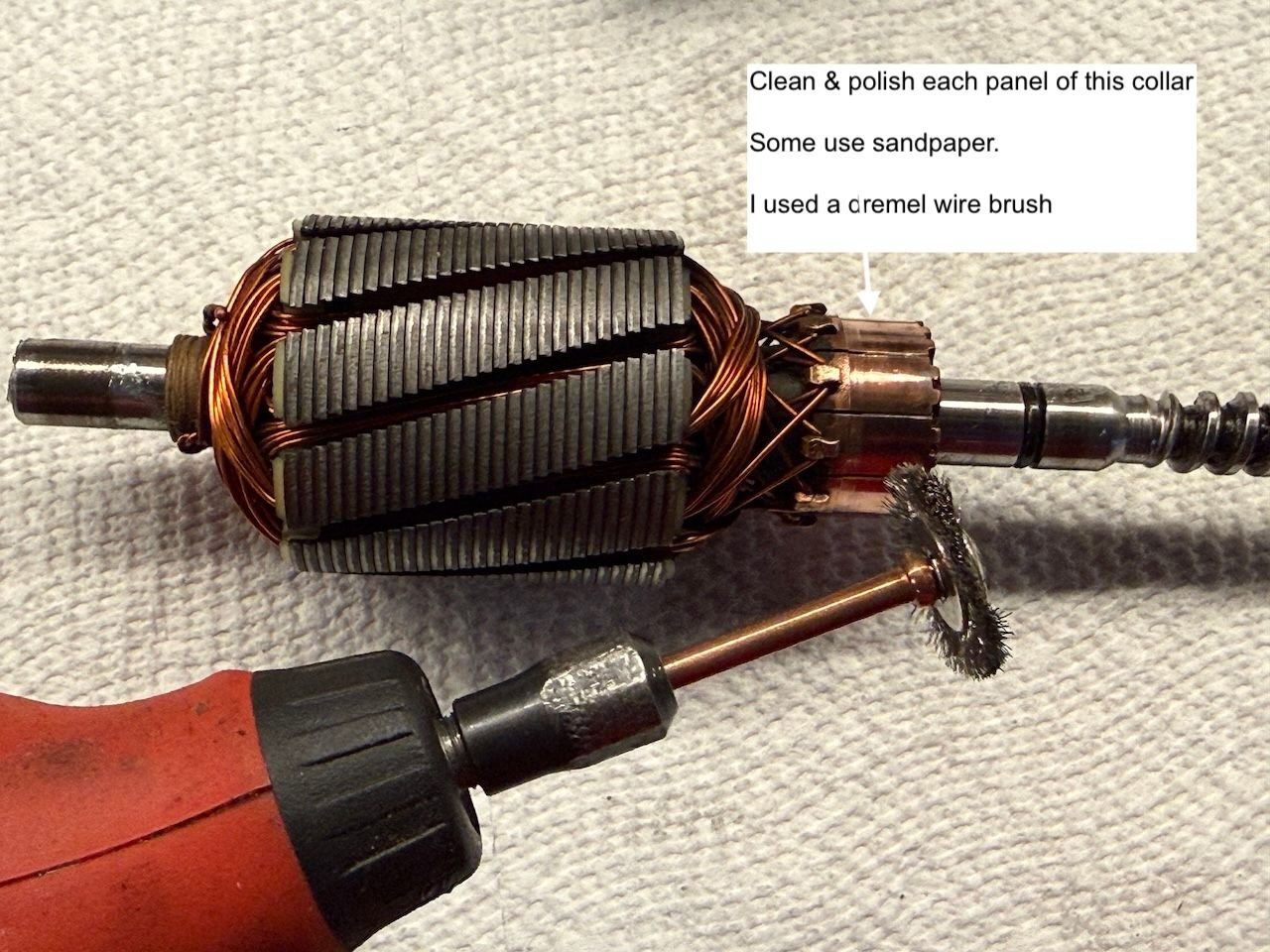

Up close and personal on polishing the commutator brush collar:
I went for a shiny finish figuring that would be best conductivity / max voltage. With dremel it takes just a few minutes. But those d*mn wires fly off here & there and become splinters for _Months_ afterwards...

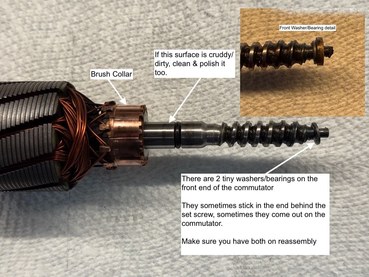

There's a gotcha on the end of the commutator. There are 2 bearings/washers that can get lost. Here's what they look like. Just be sure you remove them from the mechanical side on disassembly and keep safe. Then stick 'em on the end of the commutator with a little grease to hold 'em in place as you slip the electrical side back into the mechanical side. This is what to keep track of:
Don't lose the two washers on the nose of the commutator. They often get stuck in the mechanical side of the motor beneath the set screw.

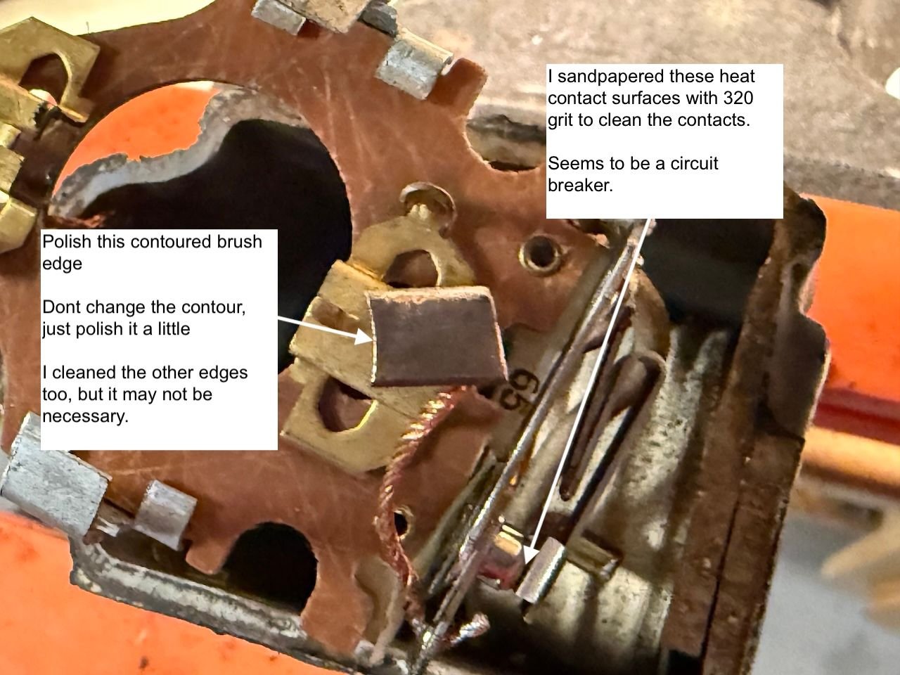

The brushes are carbon and wear down over the years spreading dust inside the motor and onto the collar of the commutator since they're spring loaded to ride against it. My goal here was to clean the contoured (and all other) edges of the positive and negative brushes to restore the mating surface to something like what it was 60 years back. Here again I was very gentle with my dremel wire wheel. The goal is clean without recontouring the mating surfaces. A couple of shots may help:
Clean the contoured surface of the positive brush. While you're at it sand the circuit breaker points clean too. Decades of arcing can leave a pitted mating surface.

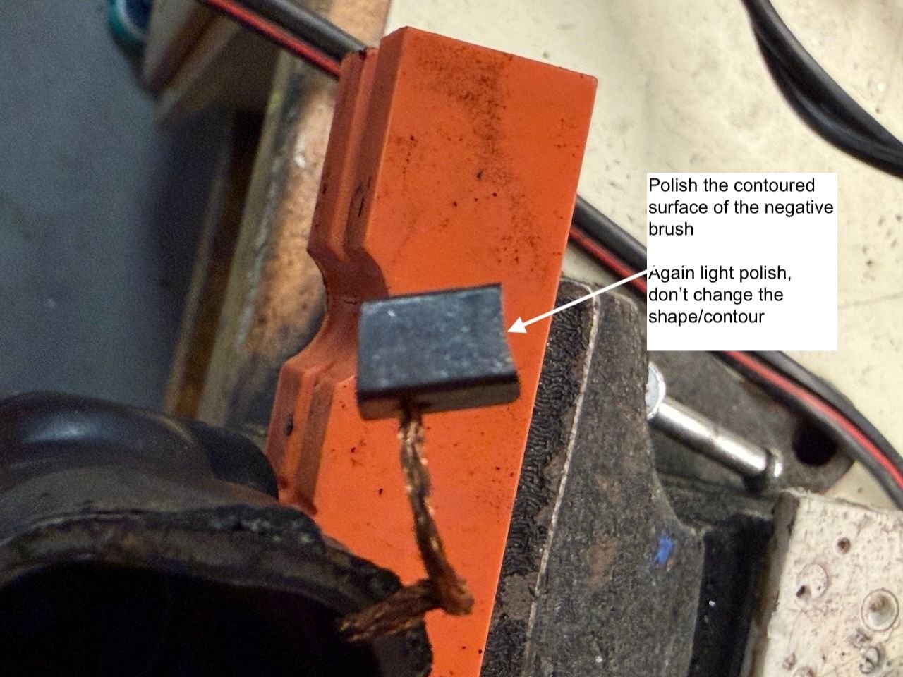

Well, what good is 1 cleaned brush? Here's the negative side. Gently clean the contoured surface like you did the other side:
Clean the rounded contoured edge first. I did the other edges too just for good measure.

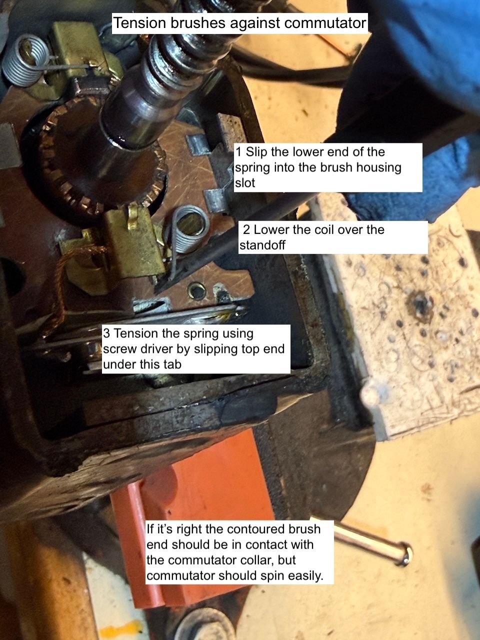

Once the brushes are in, it's time to put the tension springs back on. These springs hold the brushes against the spinning commutator collar. Here's what I did:
Tension springs hold the brushes against the commutator. I used a small screwdriver - bottom of spring slides against the rear of the brush, top of the spring is hooked under the tab on the brass housing.
