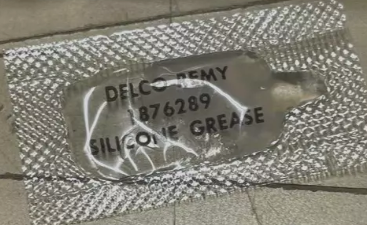

Posts: 18,227
Originally Posted by 69HO43
That little silicone grease tube that comes with the Delco units is indeed intended for the baseplate. I don't use it anymore anyway- I use the heat sink paste, just because. GM claims it's a special heat sink silicone grease.
It's been years since I've seen one of those "ketchup style packets" of thermal paste included with an HEI module. As I recall, the last time I got some it was white.
Just order the computer chip thermal paste from Amazon and you should be set.
