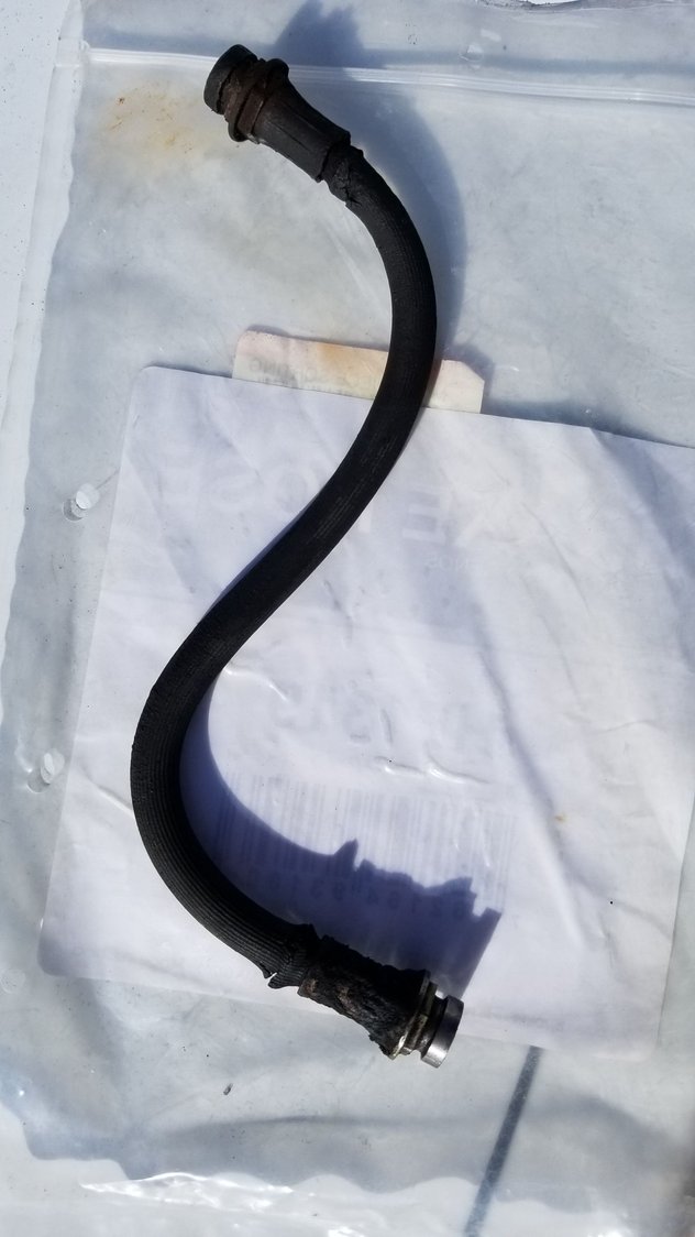

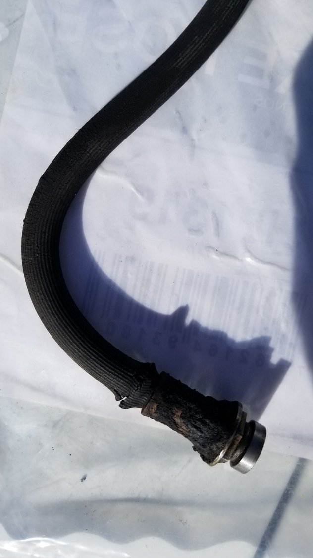

Well, I lifted the car, found out the right front wheel wasn't braking, took the drum off, and the wheel cylinder was bone dry. But I also discovered what I'm guessing was the real culprit in the process:
The master cylinder reservoir was also filled with water and rust, both chambers. I think I skimmed all of the water off of the top, but there's still a lot of rust in the system. Do I need to get it all out?
Old Nov 24, 2018 | 02:49 PM
Posts: 42,475
The hose is a common issue when they get old, might as well do the opposite front hose also. I would suction out the fluid in the master, wipe the inside down, and refill with fresh. I start with farthest rear wheel cylinder (RR) and bleed until it flows clear while refilling the master cylinder as needed, then the LR. Move to the fronts, do the RF and then the LF.
