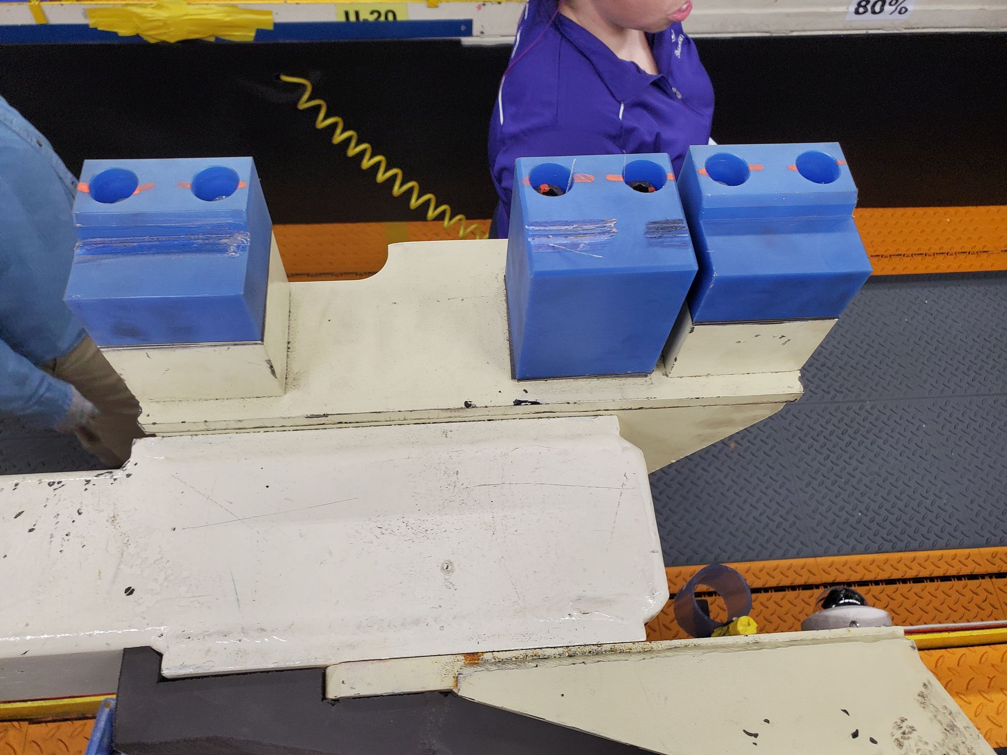

Posts: 12,804
Toyota method is a block that sits on the inside of each pinchweld on the back, so it can't slide left or right, and a pin on the front ones for a convenient hole in the body. You could do the same with a bolt. Our cars go up and down at a 45 on the conveyors.

Posts: 12,804
I was trying to avoid drilling a hole through the pinch weld Koda.
I’ll try the adapters and see where it goes.
thanks guys!
Body mount hole....
Like this.

Body mount hole....
Like this.
the lower picture is like the factory used to locate the body to body "truck" that the line chain pulled.. there were several on each truck. dont know how sturdy your dolly would be by adding beams to each side so you could put more than 4 on it
