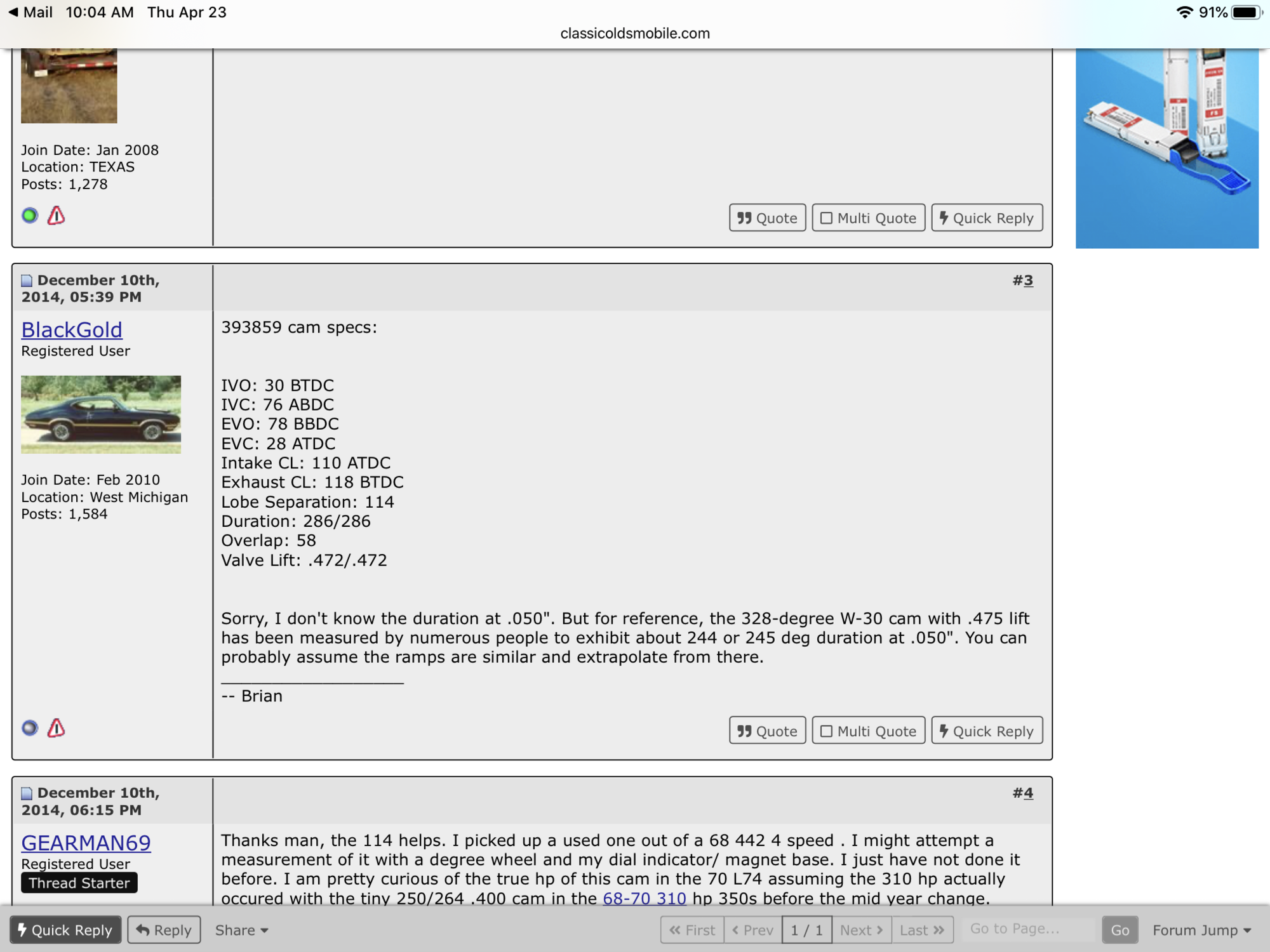

Th
is is off an old post, shows it at 114.

ok so 114 Lsa for sure. w-30 cam 328 - 245 so thats -84. 286-84 = 202@.050 right ? or 245 is 75% of 328, so 75% of 286 is 214@.050. whats the right way lol

The Spring, 1970 Supertuning booklet from Olds confirmed these specs for the "1970 310hp Sync. Trans":
P/N: 393859
IO: 30° BTDC
IC: 76° ABDC
EO: 78° BBDC
EC: 28° ATDC
Intake CL: 110°ATDC
Exhaust CL: 118° BTDC
Lobe Separation 114°
Advertised Duration 288°/286°
Overlap: 58°
Valve lift: 0.472/0.472"
Other articles have shown this information on the 393859:
Duration at 0.050": 221°/221°
