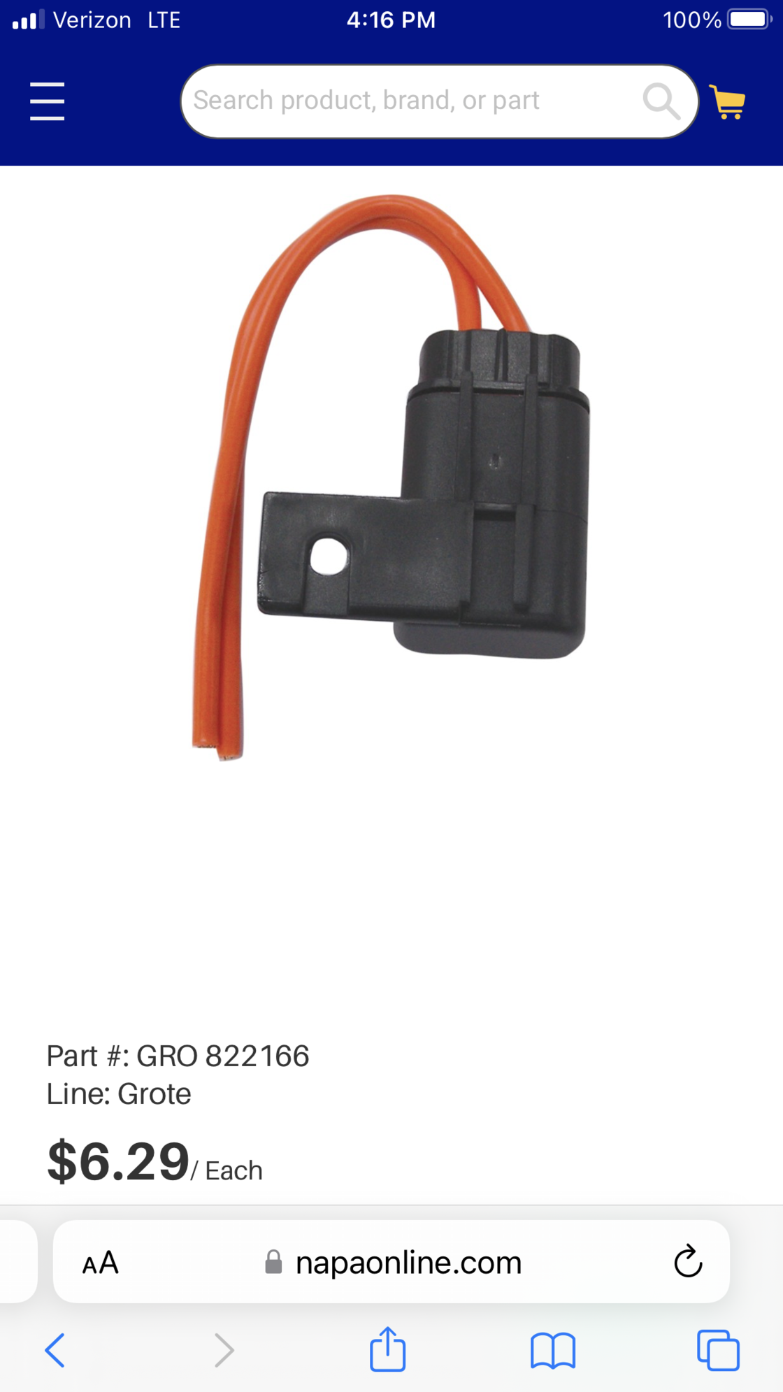

I have fixed many cars with this issue using a ATO fuse holder.
Les than 10 bucks at Napa.
Obviously not 100% “correct” but a much better design than the factory fuse and holder.
