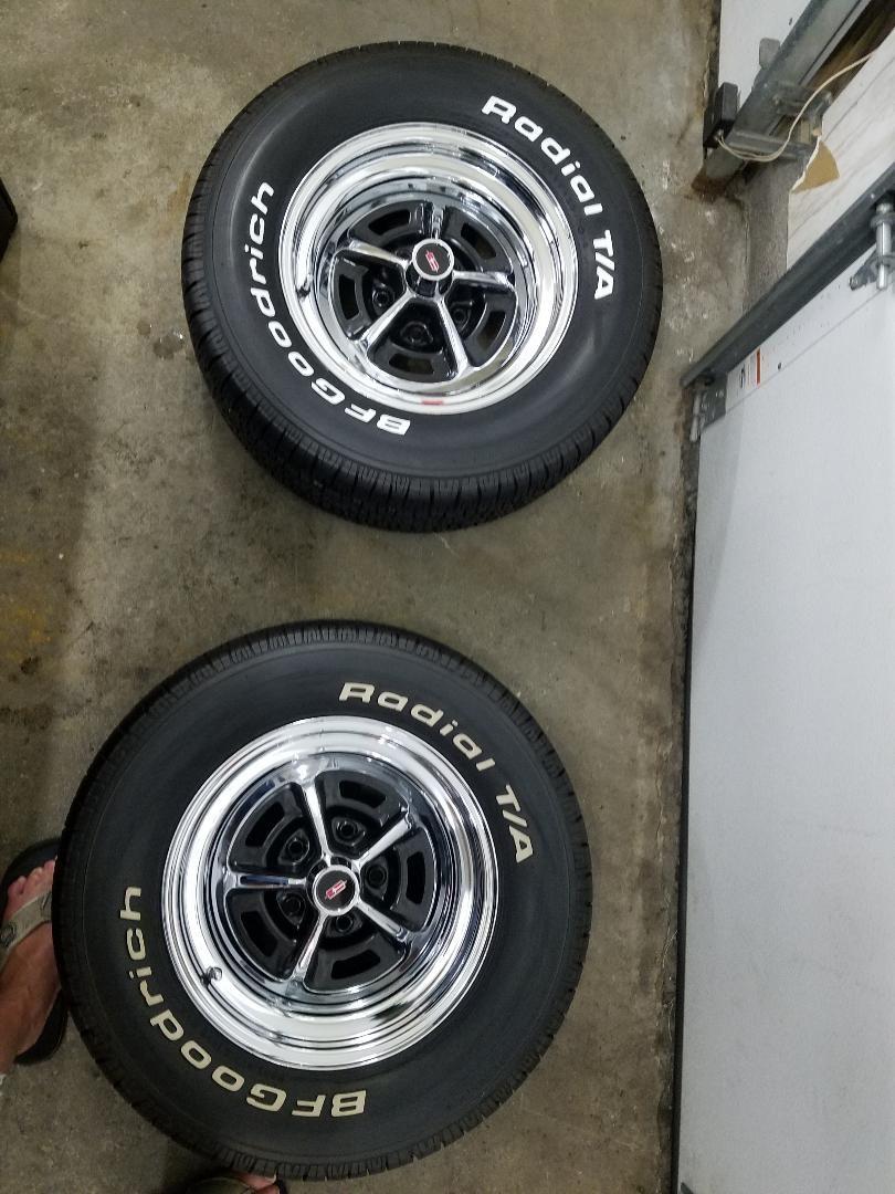

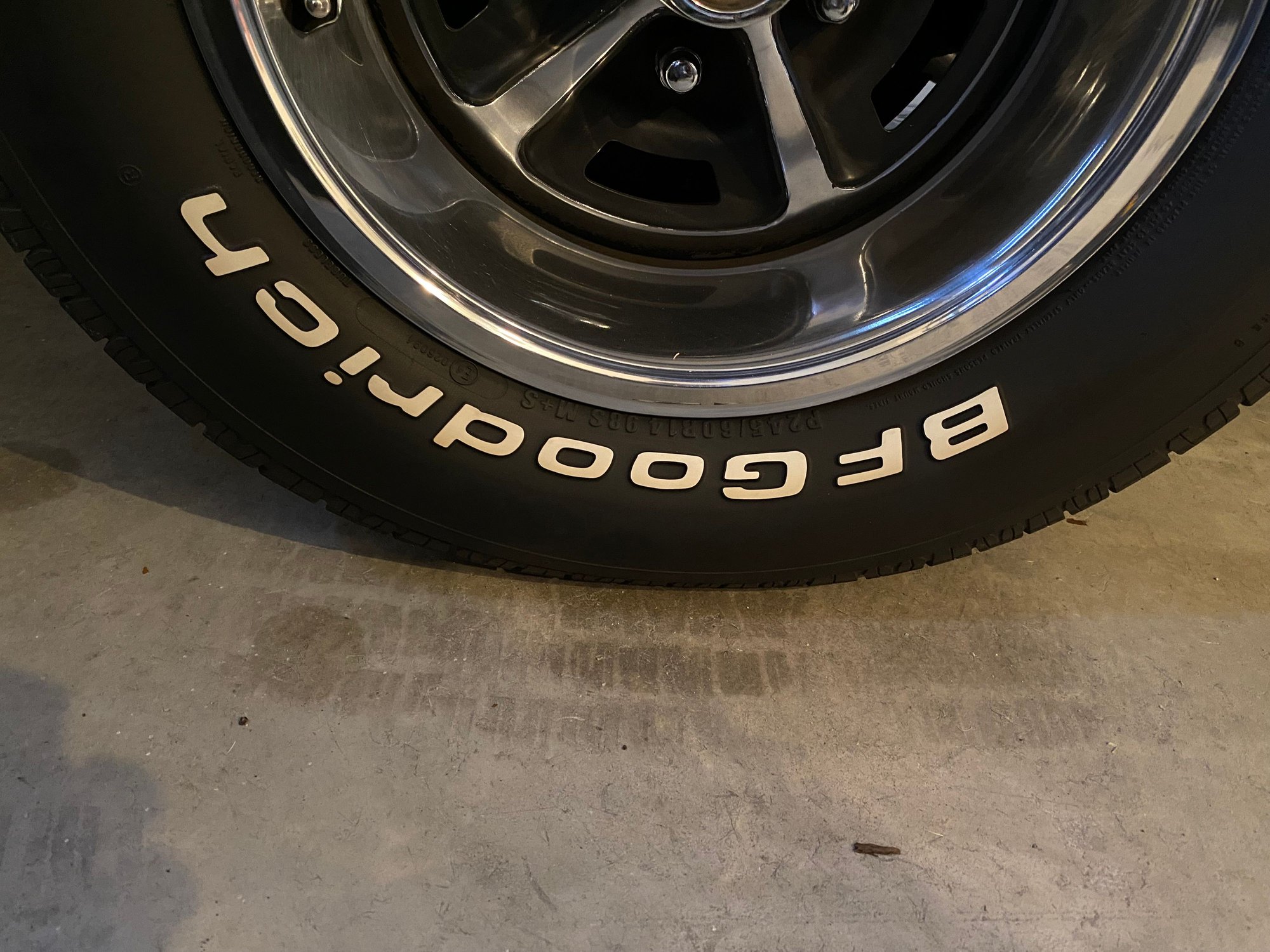

And that has worked since RWL tires were invented. However, the root cause of this problem is the black compounds are leaching up through the white, thus brown.
Apparently, there is a seal between the two colors and that seal is defective.
I used Brillo pads since the 70s with great results. Then switched to Westlys Bleach White until some rocket sciencetist environmentalist tree hugger decided to reformulate it. Now straight water cleans better.
I used every trick in the house to try to whiten up the brown and nothing worked.
This is the result of the white paint pen...applied with a paint brush. The upper tire got the paint. The pic may not show how drastically different the upper tire is from the lower., it is in person.

There is a world of difference, it is evident. I used to use a paint pen that looked like a white giant crayon and the paint really wasn't paint is was kind of like oh I dont't know greasy chalky kind of stuff. Anyway it worked pretty good but was difficult to put on and you had to be careful and there was cleanup involved, but it worked well and lasted for a few months anyway.

.This is the result of the white paint pen...applied with a paint brush. The upper tire got the paint. The pic may not show how drastically different the upper tire is from the lower., it is in person.
The upper tire is definitely brighter, I'll give you that. And great workmanship -- looks like you have a very steady hand.
However, I wish my tires looked as good at your lower one!

The first set went mocha brown. Second set wasn't as bad, still not what I paid for and you can not get it white.
The camera doesn't do the brown justice.
The front tires are normal.
Ya the hand is still steady, at least I have that,..lol,

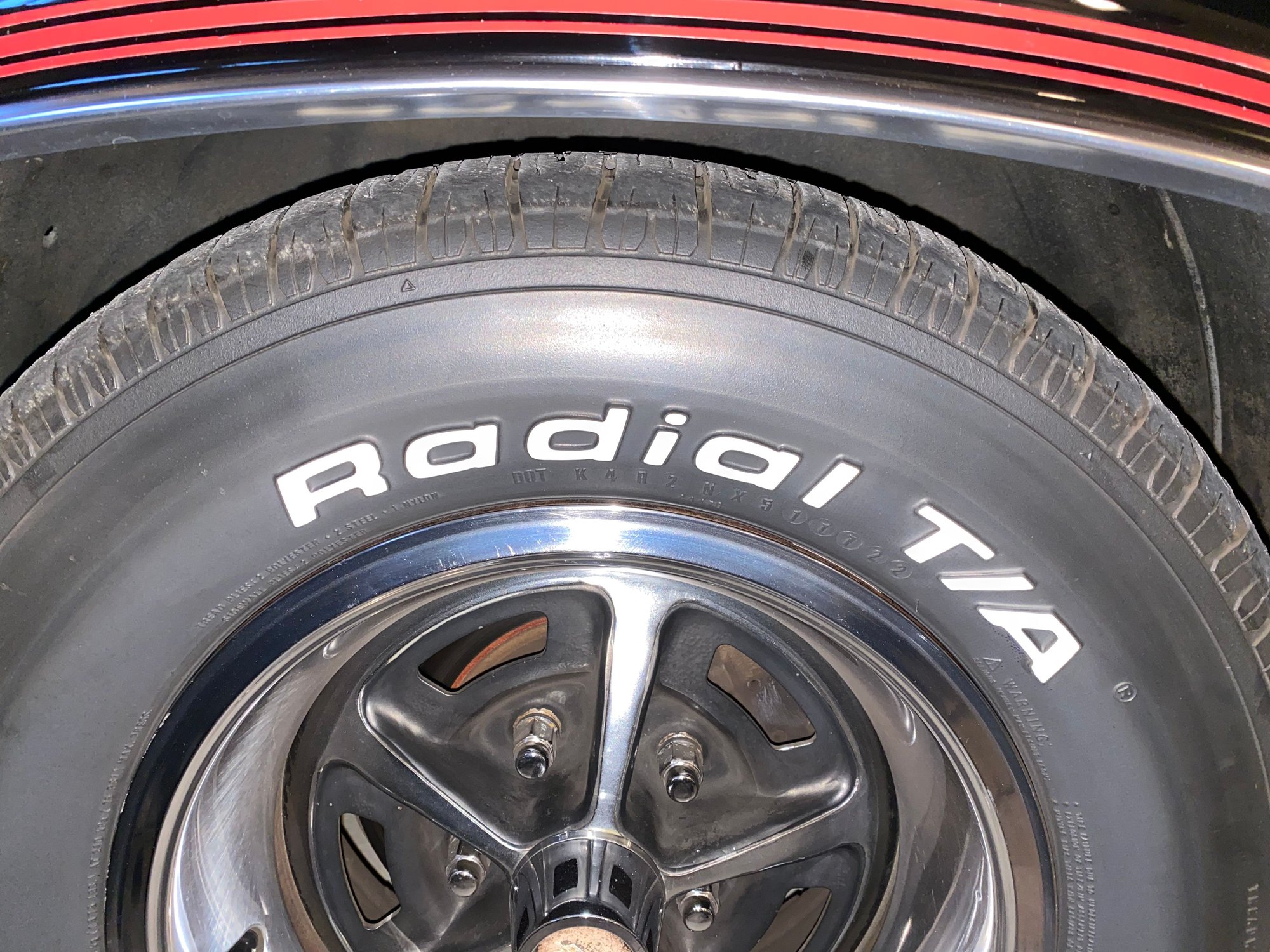

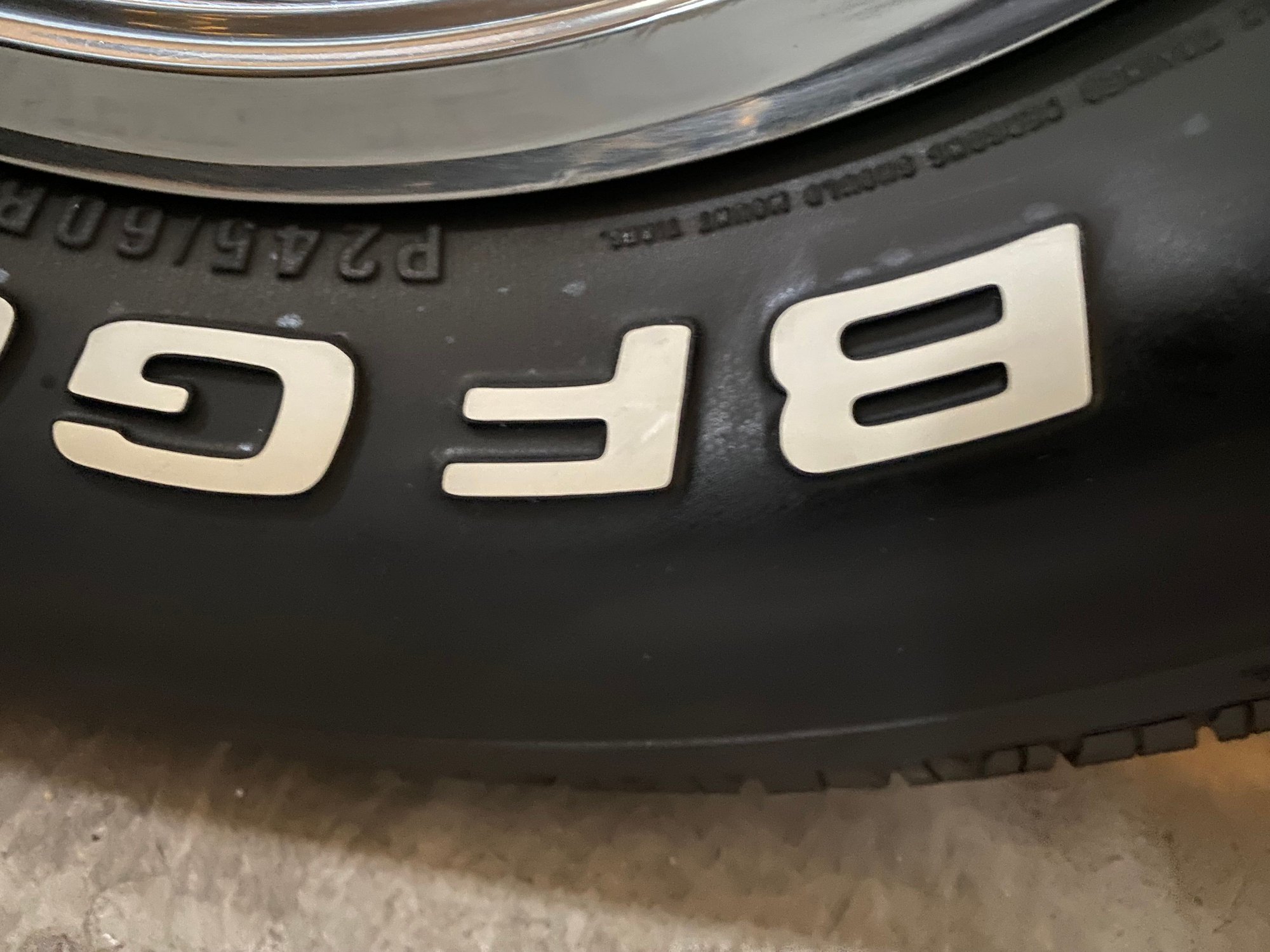

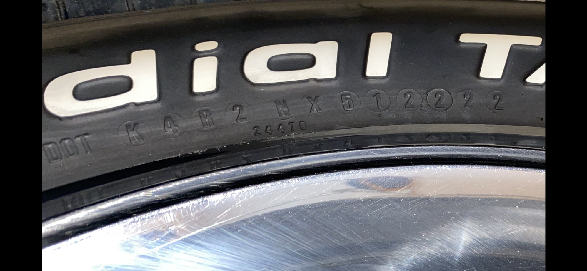

Like everyone else I’ve tried several types of cleaning products. On a whim last weekend and in a rush to try to get to Cars & Coffee, I grabbed a can of WD-40 Specialist I had in the garage. Using a clean cloth or blue “shop” paper towel I sprayed the cloth with a very small amount and then rubbed over each letter. It seemed to work well. I spent about 5 minutes or so per tire on the first pass. This morning I went back over a couple of letters a second time and they look even better. Since I was rushing, the wheels and tires were not cleaned first. I plan to resolve that this weekend. My tires are about 1.5 years old and browning was not severe but was still very noticeable.
After quick first pass last weekend (photo with flash)
After first pass (photo without flash - still hints of brown)
After a second pass this morning (photo without flash). BF improved, G with no second pass yet shows slight leftover brown. Remnants of WD-40 had not quite dried on BF

Old Apr 17, 2024 | 06:04 AM
  #32
Posts: 16,743
Originally Posted by 72442TwiceOwned
Like everyone else I’ve tried several types of cleaning products. On a whim last weekend and in a rush to try to get to Cars & Coffee, I grabbed a can of WD-40 Specialist I had in the garage. Using a clean cloth or blue “shop” paper towel I sprayed the cloth with a very small amount and then rubbed over each letter. It seemed to work well. I spent about 5 minutes or so per tire on the first pass. This morning I went back over a couple of letters a second time and they look even better. Since I was rushing, the wheels and tires were not cleaned first. I plan to resolve that this weekend. My tires are about 1.5 years old and browning was not severe but was still very noticeable. ... quick first pass last weekend (photo with flash) ...After first pass (photo without flash - still hints of brown) ... After a second pass this morning (photo without flash). BF improved, G with no second pass yet shows slight leftover brown. Remnants of WD-40 had not quite dried on BF
That's really pretty good. I'm gonna look for that stuff. If it doesn't work, I can always use another can of HD penetrating oil! Thanks for the post!

Posts: 157
Any time. Just FYI, I also tested an old can of Mobil 1 spray similar to WD-40. It also worked well. Regular WD-40 may even work but I didn’t have a can to try.
