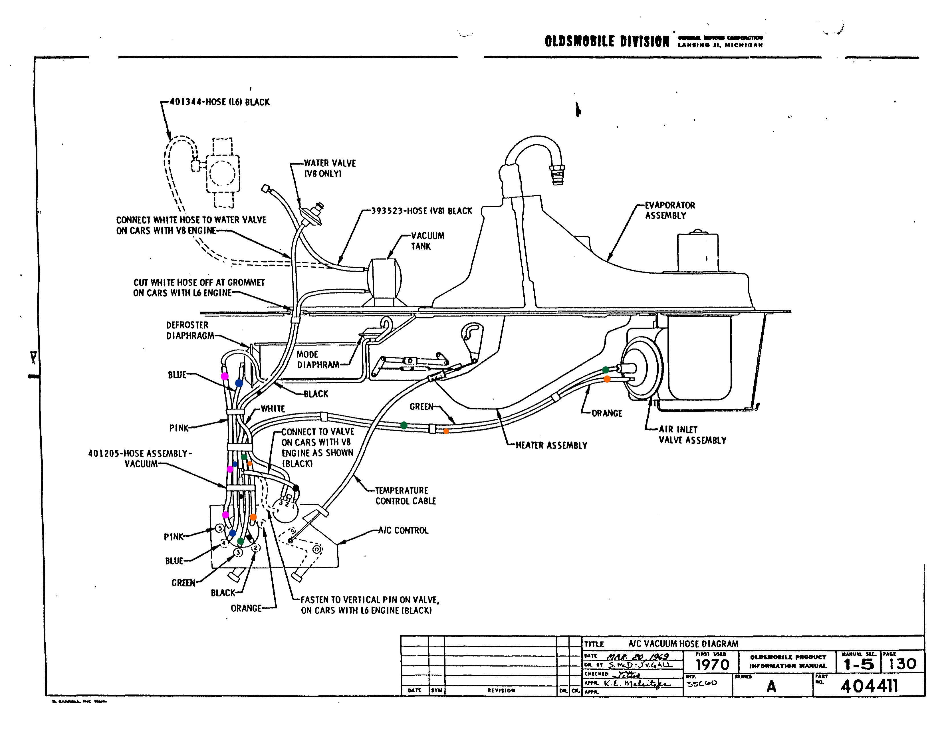

I just colored mine for today's session @ the garage. Until someone can provide you with the '72 pages, here is the 1970 to learn by heart
From a look the 72 diagram is identical, just the L6 engines' routing is deleted.

Does anyone have a spare air inlet valve (assembly) that is shown on the far right of the diagram? I believe this bolts to the metal of the car, using 5 to 6 bolts. If you do, let me know or PM me. thanks.

I wouldn't use a 1970 diagram for a 1972 car. On one the Heater Control Valve is normally open; on the other, normally closed. That means there must be a fundamental difference in the control heads.
